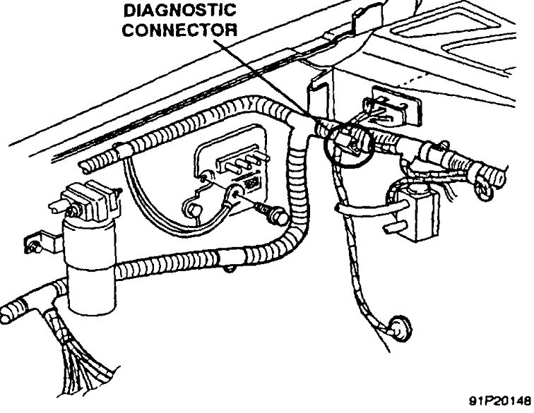

The diagnostic connector for '95 and older models is under the hood, normally near the driver's side hood hinge. For your model, the connector is near the right hood hinge as shown in the second drawing.
