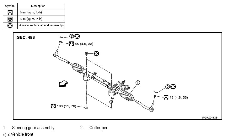

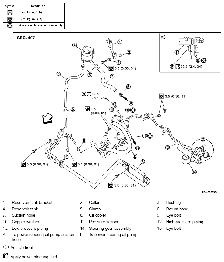

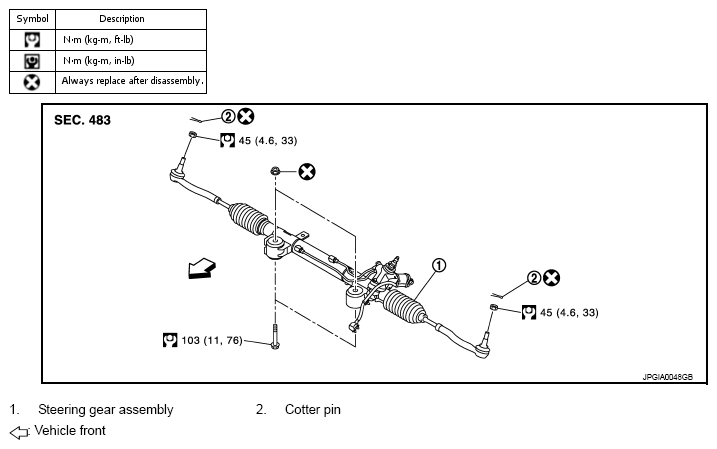

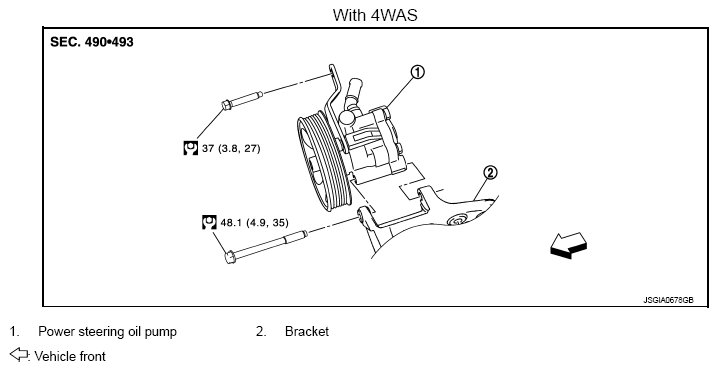

The first thing I need to find out is where it is leaking from, or approximately where. There are three things of concern, the power steering pump, power steering hoses, and the rack and pinion. I have attached exploded views of each component for you to see. Any of them can cause a leak if the part fails.
Take a look at the pictures and let me know what you find. The hoses and pump will be easiest to see under the hood. The rack and pinion gear is easiest from under the car. If you can take a picture and upload it for me, it will help me identify what the problem could be.
