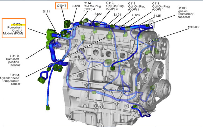

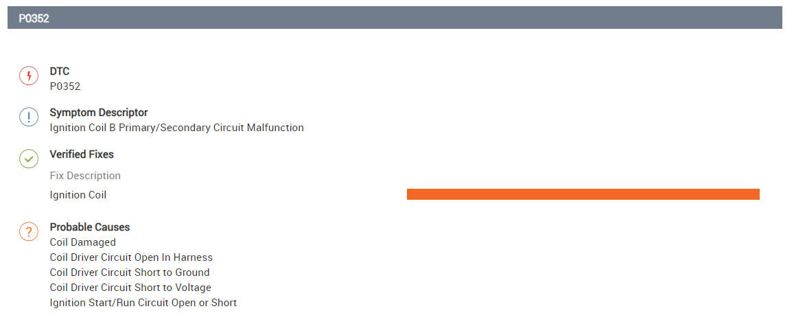

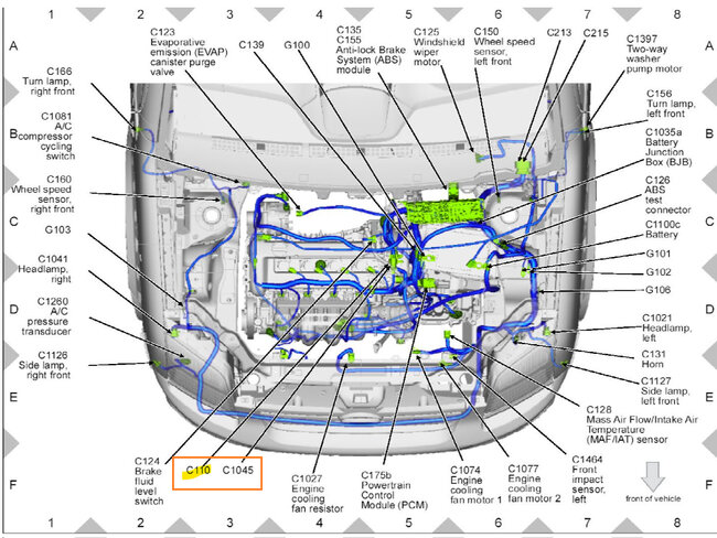

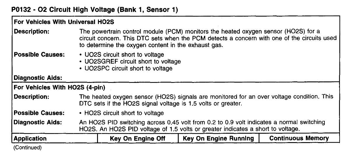

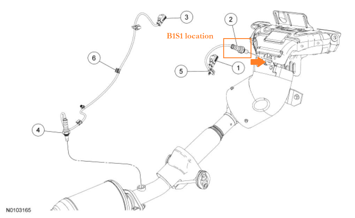

Hello, the B1S1 oxygen sensor is the front sensor, before the Catalytic converter, I'll post a diagram showing its location, the P0352 is the number 2 ignition coil, it may have failed, try swapping the coil to a different cylinder and see if the code changes to another cylinder. If it doesn't change, next move the spark plug to the cylinder you moved the coil to and see if that changes the code. The ignition coils are monitored by the engine computer, I'll post some info on the code, but swapping some components around can help determine what the fault is before buying new coils. This is a 2-wire coil, so you can check the resistance of the coil and compare it to another one and see if the resistance is low. Here's a guide as well for checking ignition system components:

Okay, well, here is the location of the B1S1 oxygen sensor, make sure to check the wiring, that it's not melted to the exhaust or anything like that.

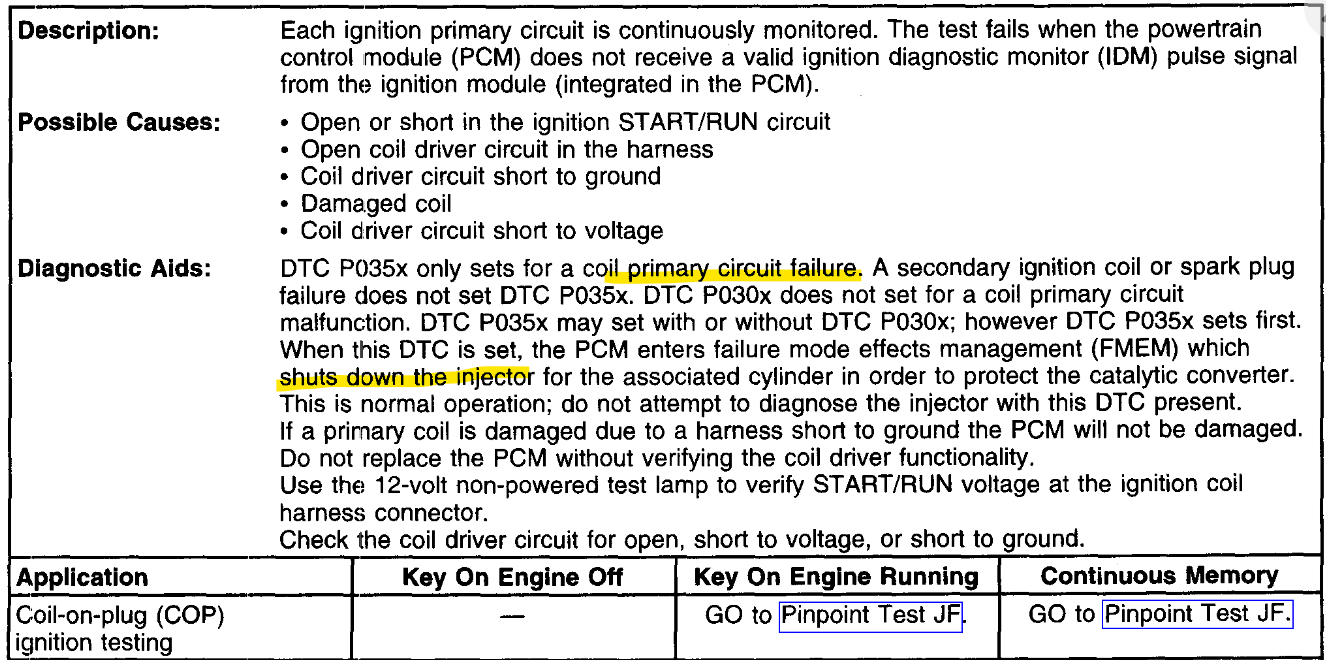

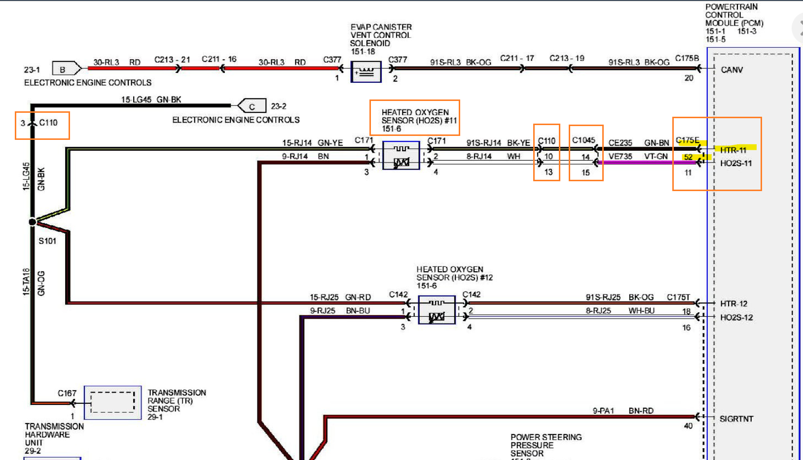

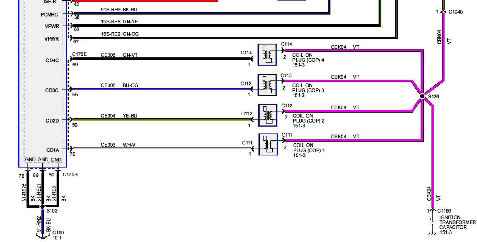

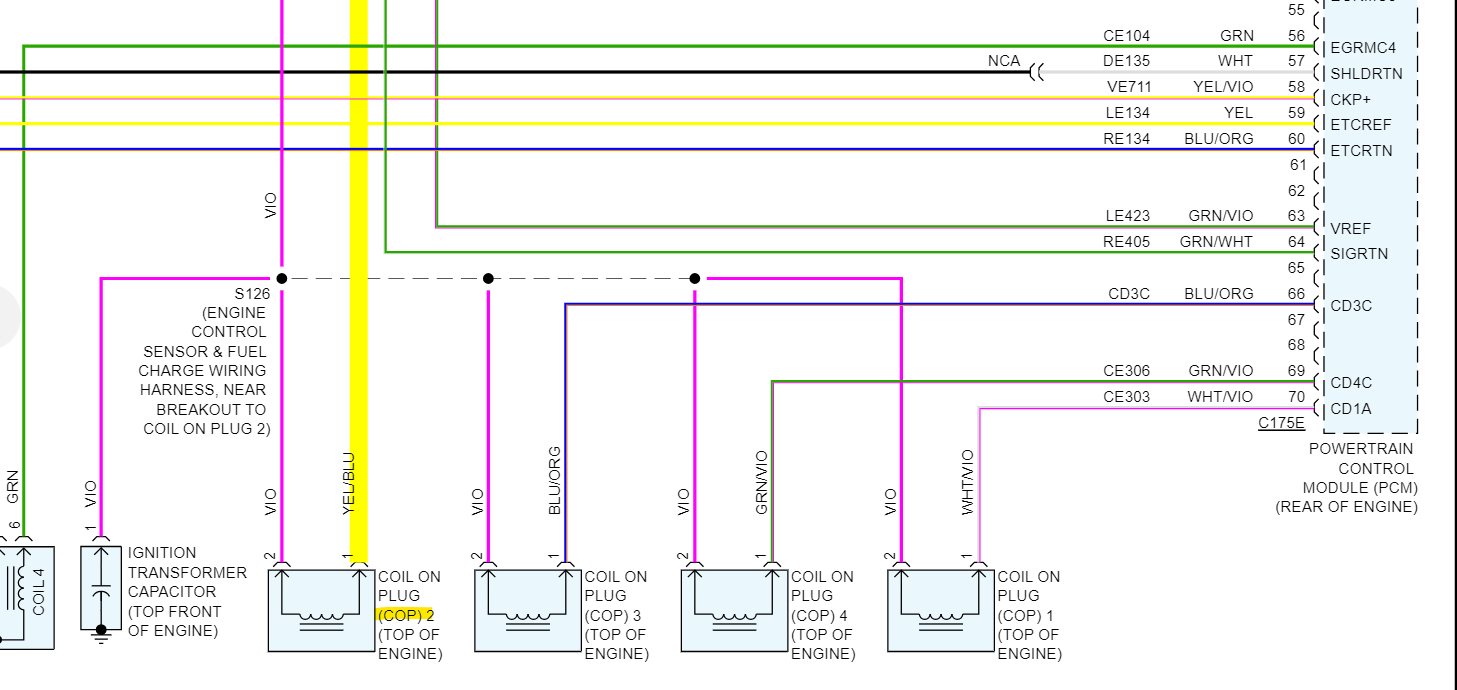

If you have swapped the plugs around as well, does the number 2 plug come out looking fouled out with fuel, Im just asking because I believe on these there is intentional shutdown of the fuel injector with that code set. Its to prevent damage to the Catalytic converter. Im just going through some different service info here. If you clear all the codes here, how fast does that coil code come back?

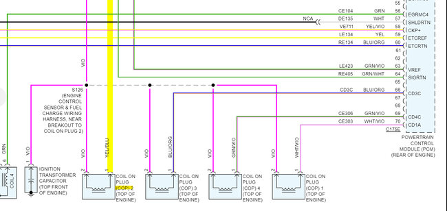

Looking at the code criteria here, this code sets due to the PCM not seeing some type of pulse feedback when the coil is fired, so its definitely something to do with the primary side of the coil or control circuit to the PCM. There is a flow chart you can go through if you want, Ill post that for you. But having 2 faults here, Im wondering if the coil control wires run through a bulk connector as the oxygen sensor circuit, or if those pins into the PCM connector are close together. Ill take a look and see if theres anything in common there.

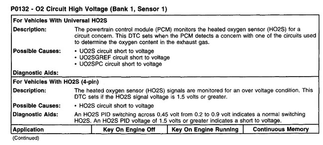

What is the voltage for the B1S1 oxygen sensor signal? Can you read that live engine data PID on your scan tool?

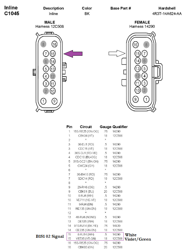

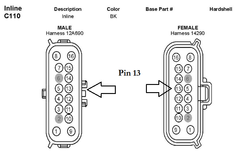

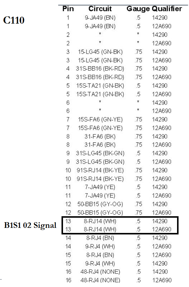

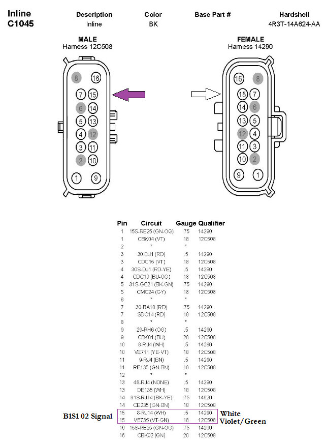

Here's the 2 connectors that the B1S1 oxygen sensor signal wire passes through to the PCM, one changes wire colors, but I would check these connectors C110 and C1045 for any corrosion that might be shorting out the signal wire to a voltage feed, setting that code.
