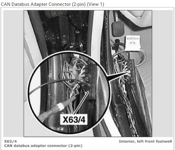

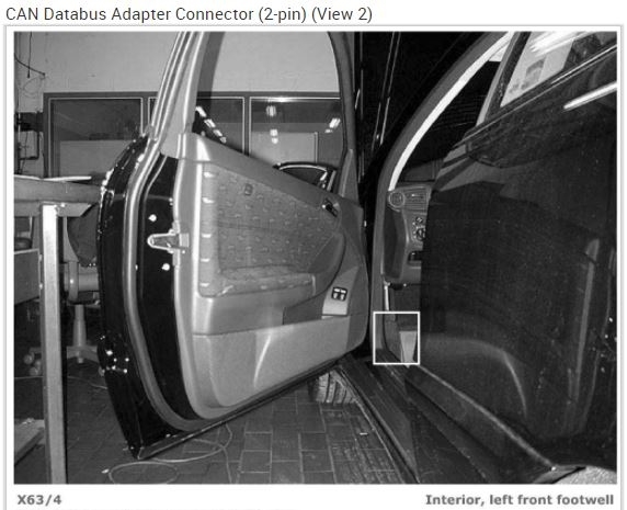

I will give you a hand seeing what is happening with your car. I always like to find out how and when an problem arises. Did this come clear out of the blue first drive one morning and it wasn't right or were you driving around an while driving it started to act up. from these codes and what your describing it seems to me the can bus not doing it job is where we should start. Here is the info on doing a general test on it. These bus connectors are know to get messed up from moisture and or corrosion. Your is located on the left front floor kick panel. Pull the panel off and do a good visual inspection.

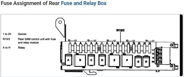

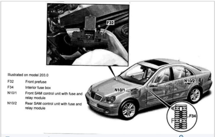

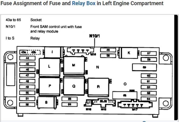

Here is a useful article on checking fuses. There are fuse blocks in both sides of the rear engine compartment, one in the inside at the left kick panel and there's one in the truck also the right side panel. Check all the fuses your find and we can ID it if one is bad.

Many times I have seen moisture get into wiring from the cars design running them under the carpets by peoples feet. Its definitely worth looking at the CAN connectors and make sure they are clean and dry. No corrosion or moisture of any kind. Looks like your ride is running them at the most common wet place in a car, at the drivers front floor and edge by the door. here are pics of your CAN connectors. Get to these harnesses and do an inspection.
