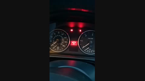

I have the ABS/traction/brake light on as well as the service light with gives code cc-id-207. i really am stuck to what to try now I was told it could be the reluctor rings on the rear shafts but I would like to try some things at home. To keep the cost to a minimum. Any help would be great.
Jun 10, 2019 at 9:47 AM
BMWMIKEY
Here is the video of what is showing:
