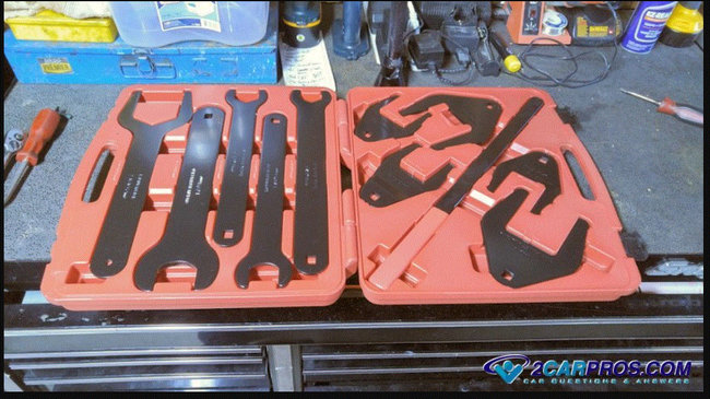

You will need special tools to remove the clutch, but most parts stores will lend you the tools. See pic 1 below for tools needed.
I hope this helps. Let me know if you have other questions.
See pic.
