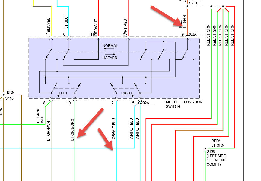

what catafina said is just a test for brake light switch what you replaced. check wires in pic at t/s switch the one on top is from brake light switch and others are to light. If they all work then check ground at taillights and for a broken/chafed wires leading to them.
