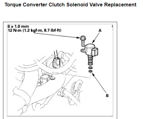

That code is for your TCC solenoid operation malfunction. This can mean the solenoid is not working or the torque converter is having a problem. I would try the solenoid first. Below is its location.
