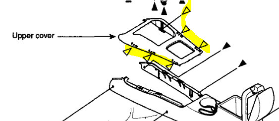

If you are unable to reach it, then the center console will need to be removed.
The center console is held in place with a few screws and several plastic retainer clips. Remove the screws and then the clips needed to gain access. See pic 1 below for screw/clip locations.

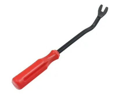

You may want to consider getting a retainer clip remover to prevent breaking the clips or damaging them. If you look at pic 2 below, it shows the tool I'm referring to. They aren't expensive and you can get them at any parts store.

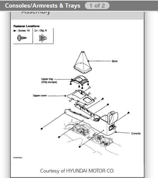

Looking at pic 1 below, I suspect the only thing you need to remove is the upper cover that is held in by 6 clips. Gently pry upward at the locations seen in pic 3. If you use a screwdriver, cover the end with a soft rag to prevent damage.
