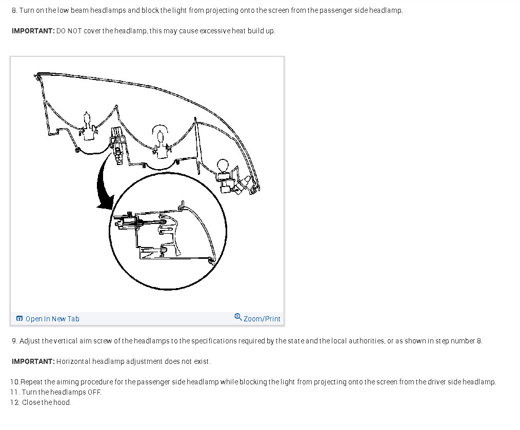

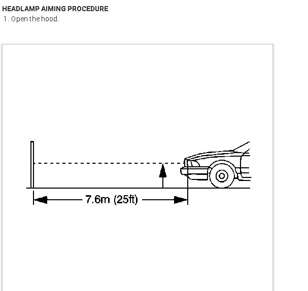

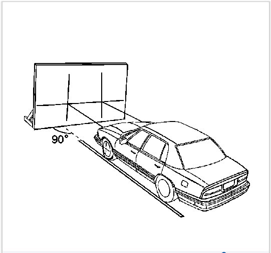

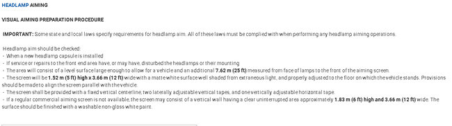

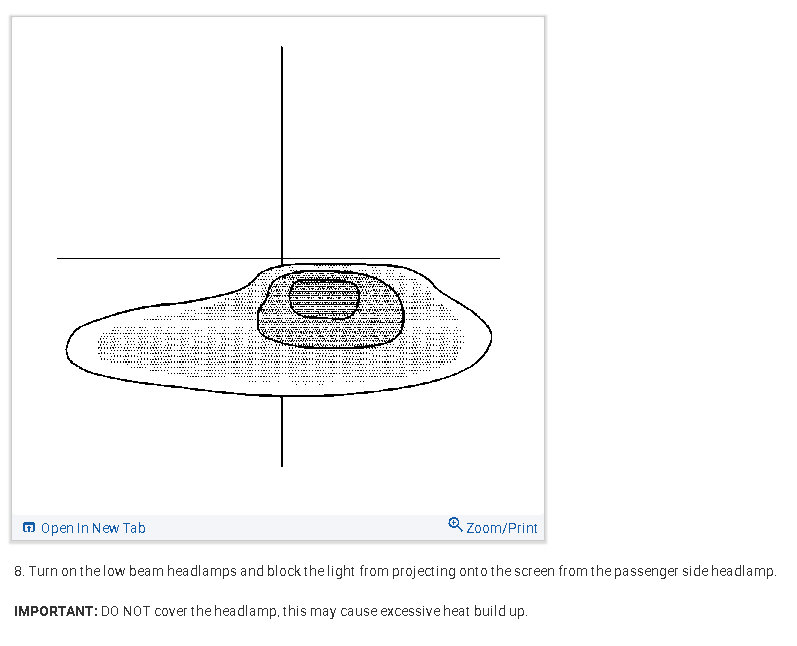

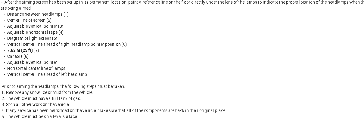

How do I aim my head light? Does my car have an antenna? If so where? It does have OnStar but not active.
Oct 15, 2018 at 12:43 PM
WILLIAM CRABTREE
CERTIFIED EXPERT
95 POSTS

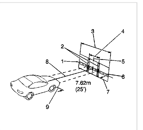

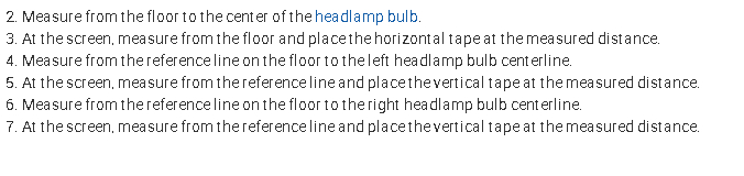

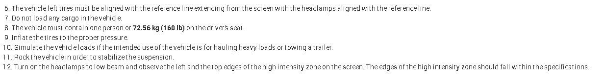

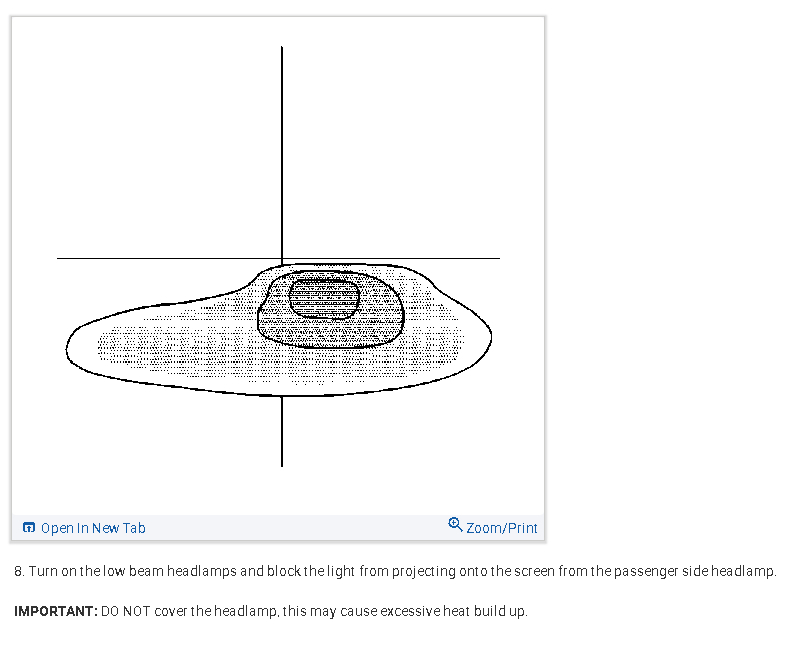

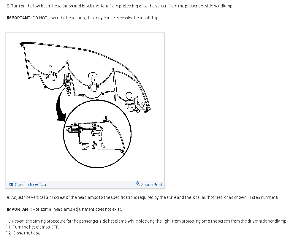

Technically, you have asked multiple questions. I have attached instructions on how to adjust your headlights. As far as the antenna, they are usually integrated into the glass on the rear window.
