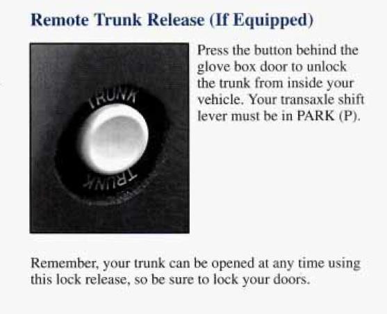

You may be able to remove rear seat. You don't have a second set of keys?
Note the picture, you may have a trunk release button, in glove box. I looked at the owners manual for a cutlass supreme.

Just to add, you could have a split rear seat as an option where the rear seat back folds down.
