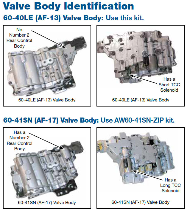

The vehicle is equipped with the AISAN AF17 4 speed automatic transmission
It is very similar to the AF13 transmission with the valve body having a few, small differences.

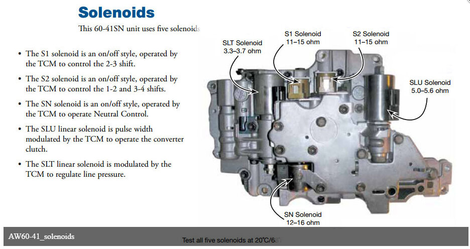

The valve body is the 60-41SN, please see image 1+6

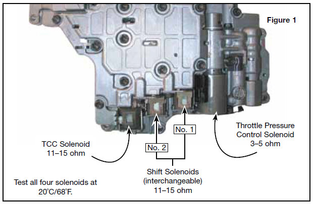

To check shift and pressure solenoids use a voltmeter and check resistance of all five solenoids at 20 degrees C,
The S1 (shift solenoid no. 1) and S2 (shift
solenoid no. 2) are an on/off style, operated by
the TCM to control the various shifts. These two
solenoids are interchangeable.
The TCC control solenoid, SLU, is an on/off style
controlled by the TCM to operate the converter
clutch.
The throttle pressure control liner solenoid, SLT, is
modulated by the TCM to regulate line pressure.
The neutral position solenoid, SN, is operated by the TCM for neutral position

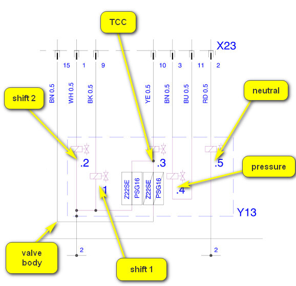

The valve body has no separate voltage supply apart from the control voltage from the TCM to activate individual solenoids. The TCM uses 7 wires via connector X23 to control the valve body solenoids. I have shared with you supply fuse for TCM in my previous reply.
See image 3, shows wiring from connector X23 to valve body.

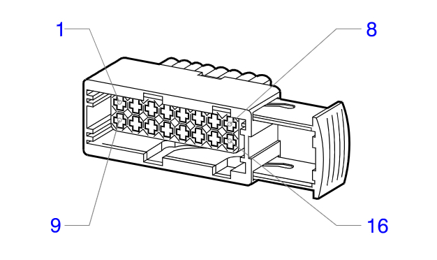

Connector X23 is a 16 pin grey/brown connector on the transmission housing, image 4

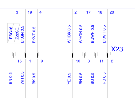

Image 5 shows the wiring from the TCM connector to connector X23
