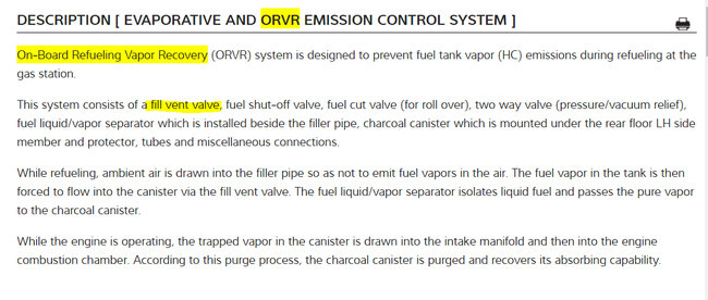

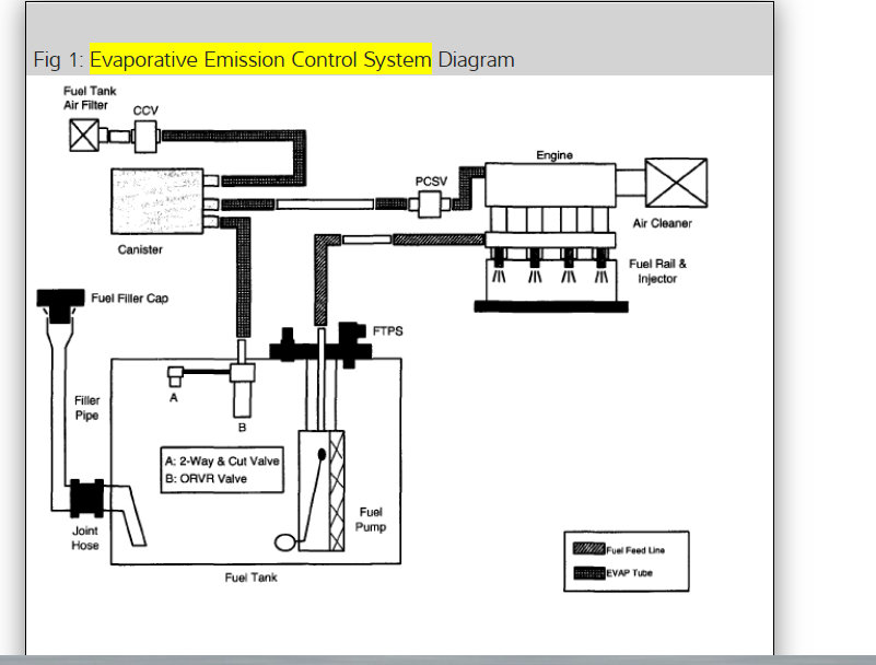

This could be a problem with your vehicle's Fuel Fill Vent Valve. In the diagrams down below I have included a description and a diagram of your vehicle's EVAP system. Please go through this guide and get back to us with what you are able to find out.
Thanks,
Alex
2CarPros

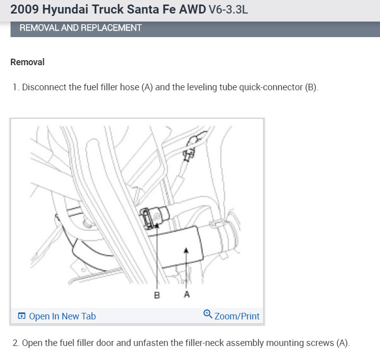

Thank you Alex but do I have to drop my tank to get to this
Jul 21, 2019 at 8:53 PM

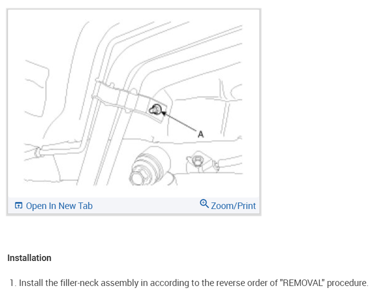

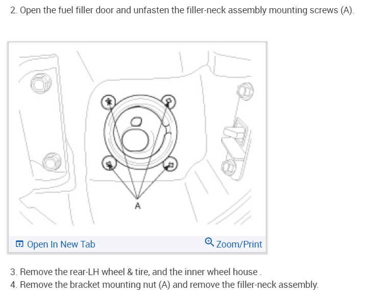

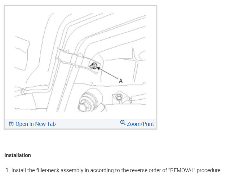

No you don't here are the instructions on how to replace the filler neck. Check out the diagrams (Below). Please let us know what happens.
