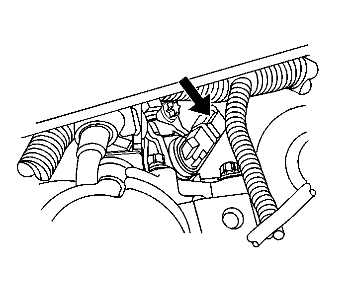

My uncle just put a new engine identical with old one in and couldn't figure where two connectors go. All gauges work but speedometer and odometer. I cannot seem to locate the speed sensor on the manual transmission.

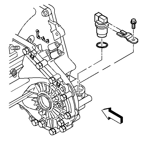

Here are the directions for VSS replacement on a manual. It will explain how one is replaced, but more importantly where it is located on the transmission. The attached pics correlate with the directions.

pic 1
1. Disconnect the vehicle speed sensor (VSS) electrical connector.
pic 2
2. Remove the retainer bolt.
3. Remove the retainer.
4. Remove the VSS.
5. Remove the O-ring.
