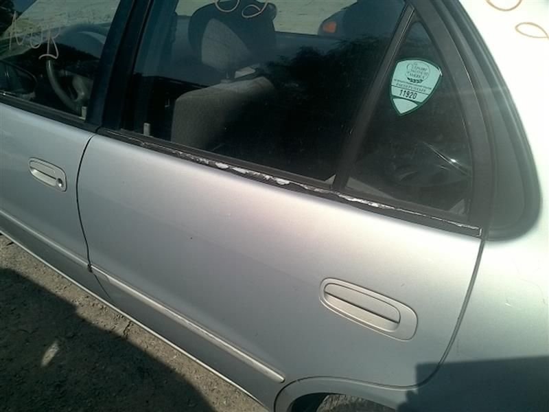

You want a door rear (side of vehicle) and electric windows LH.
The damage code and part grade as well as the description can be helpful and the pictures can really help.
The picture I added shows a damage Code 000 and part grade A 0 door.
While most of these places offer shipping, I would go in person, that way you can look at the part before you pay money.
