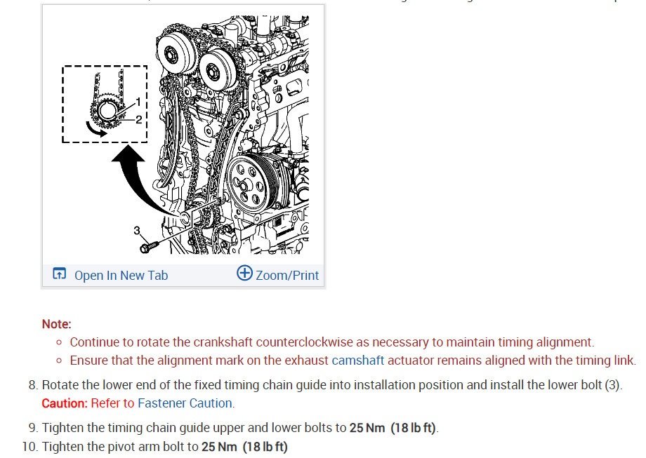

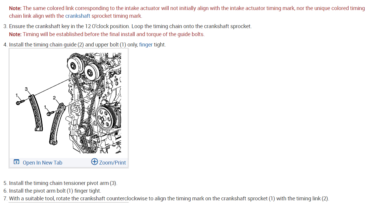

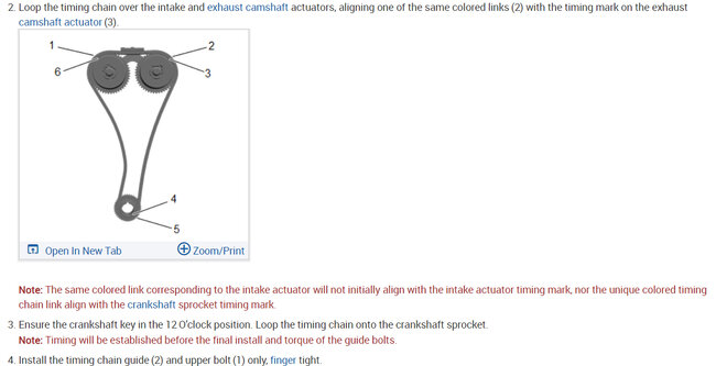

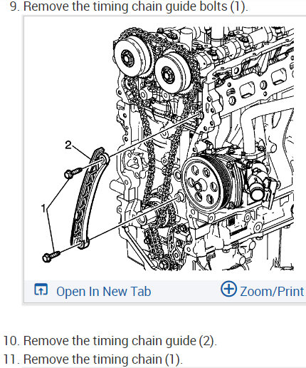

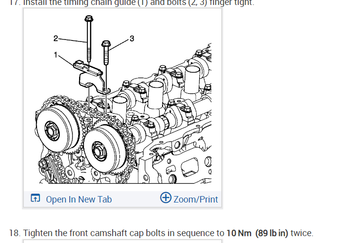

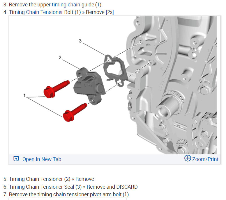

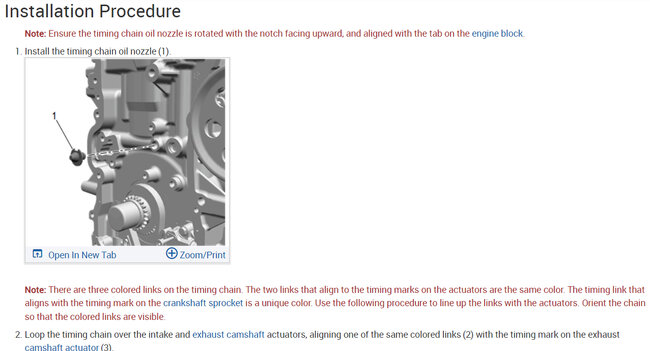

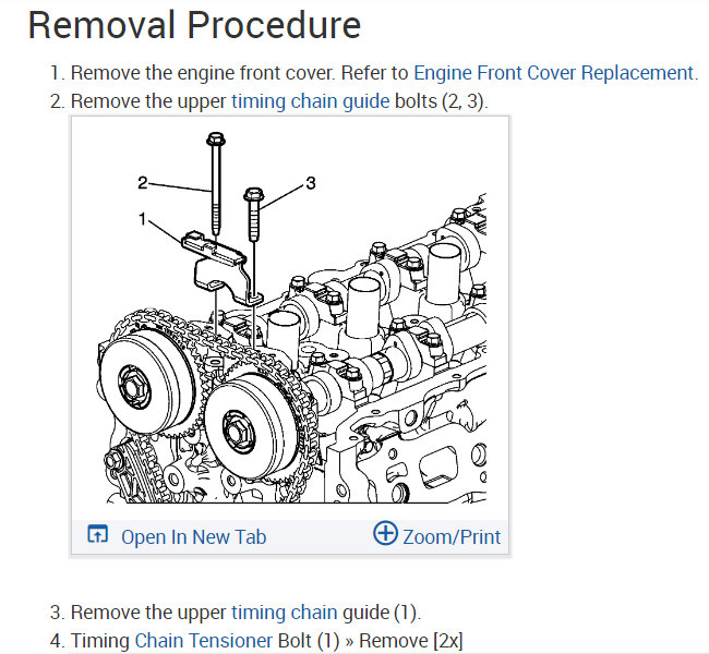

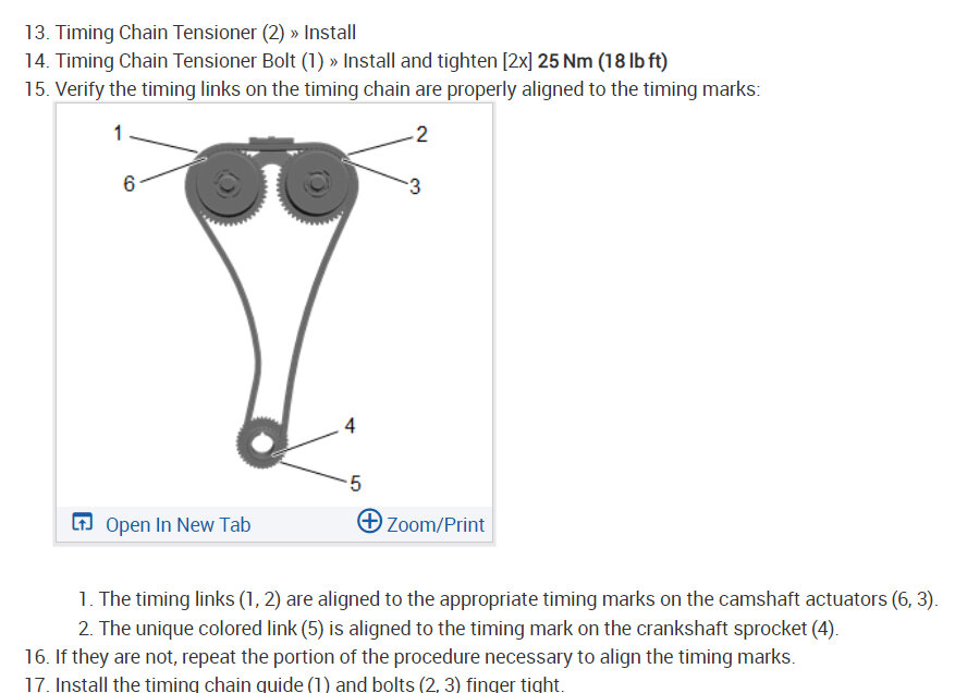

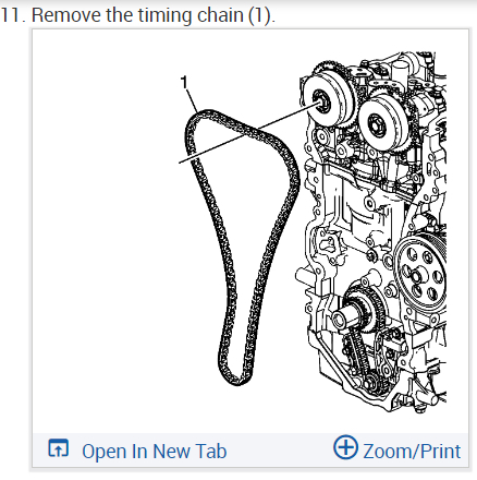

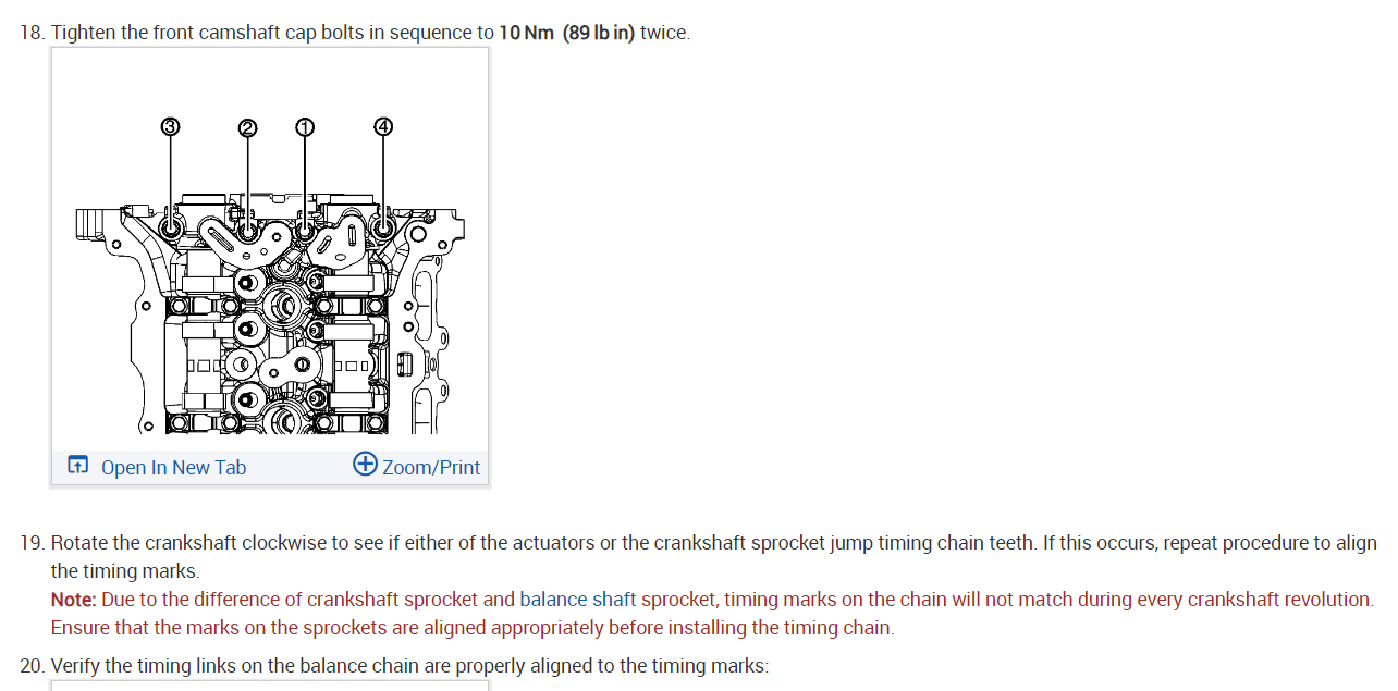

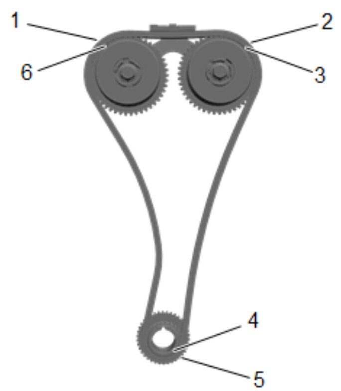

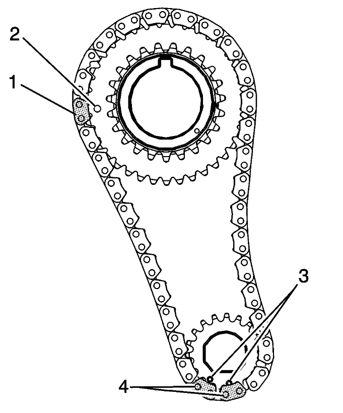

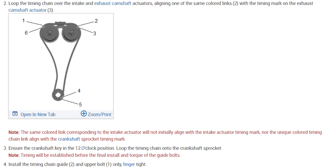

I would like a picture of the front of the motor with the chain markings along with where they align with the sprockets and shaft.
Apr 10, 2024 at 10:08 AM
CERTIFIED EXPERT
53,854 POSTS

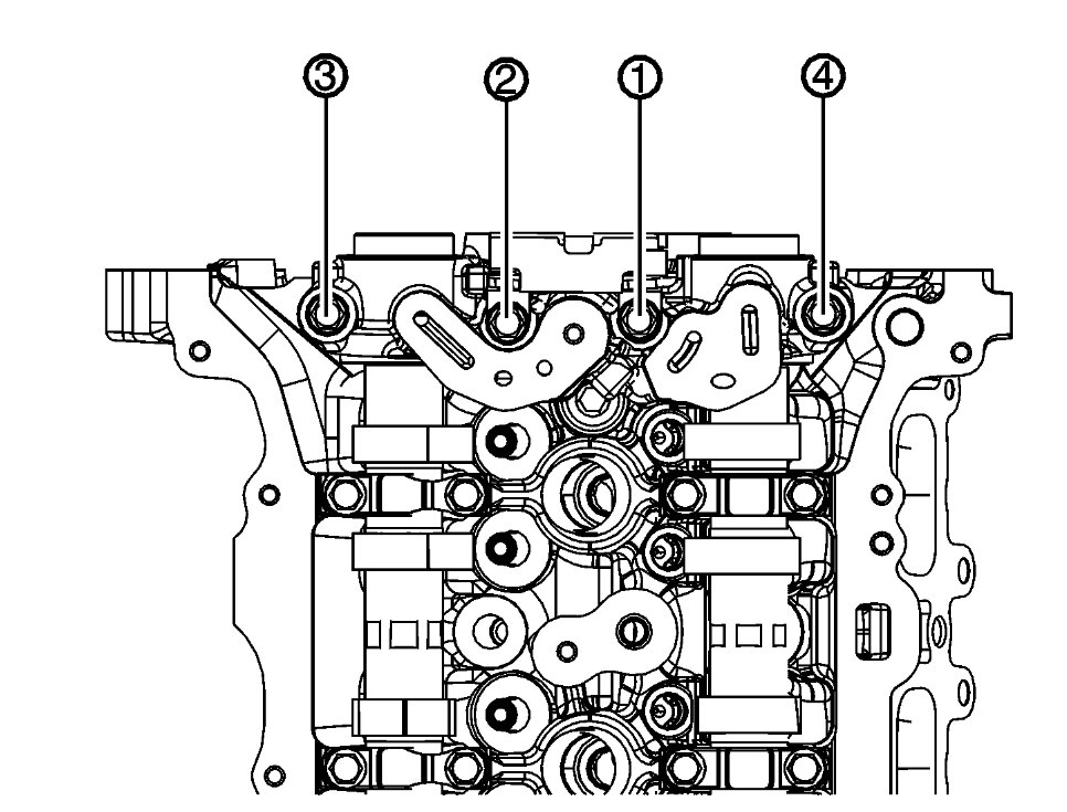

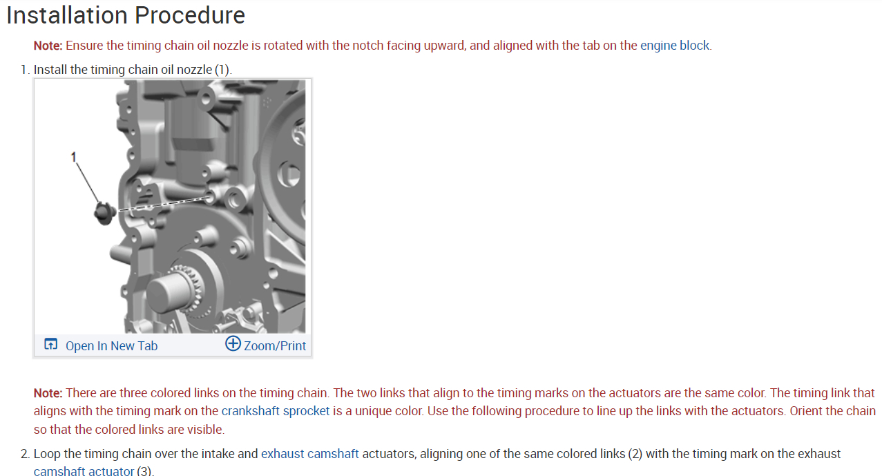

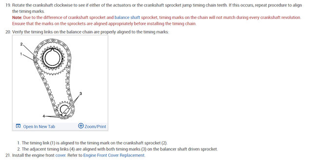

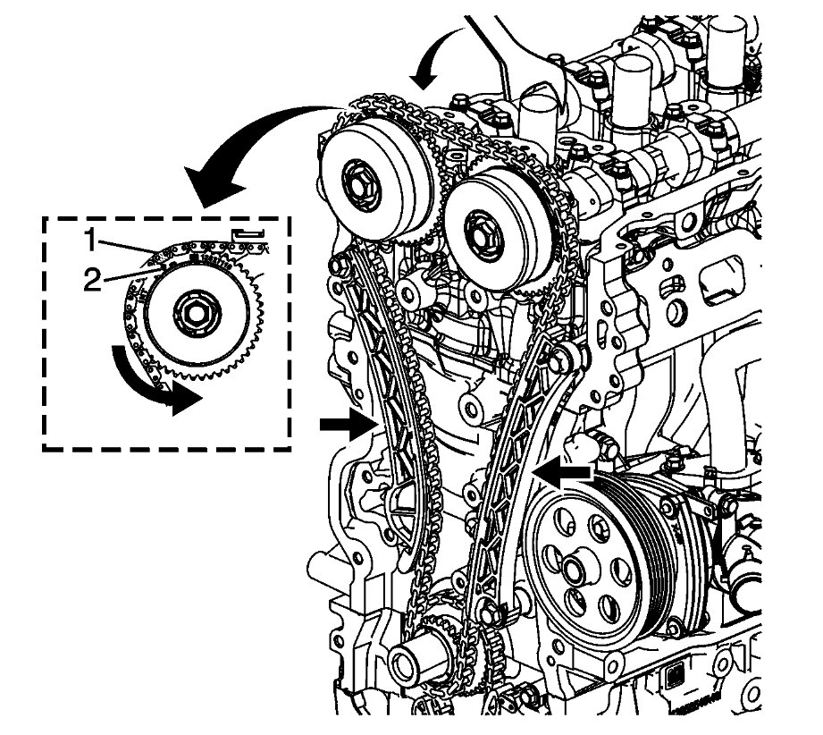

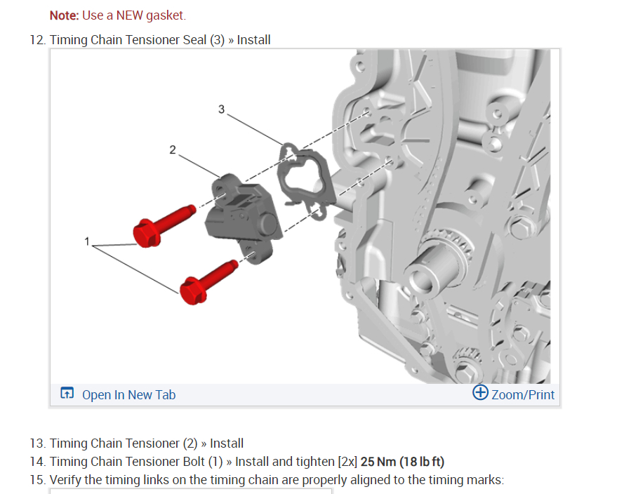

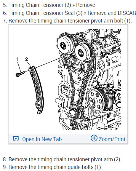

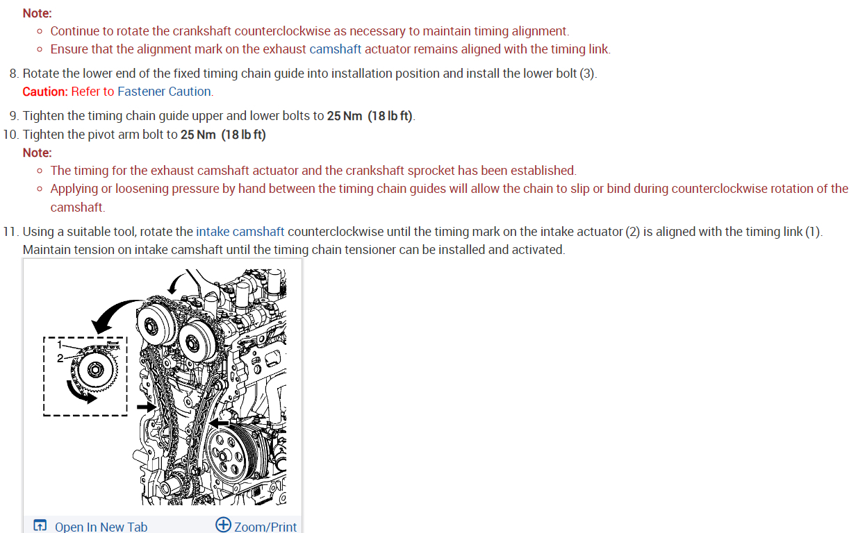

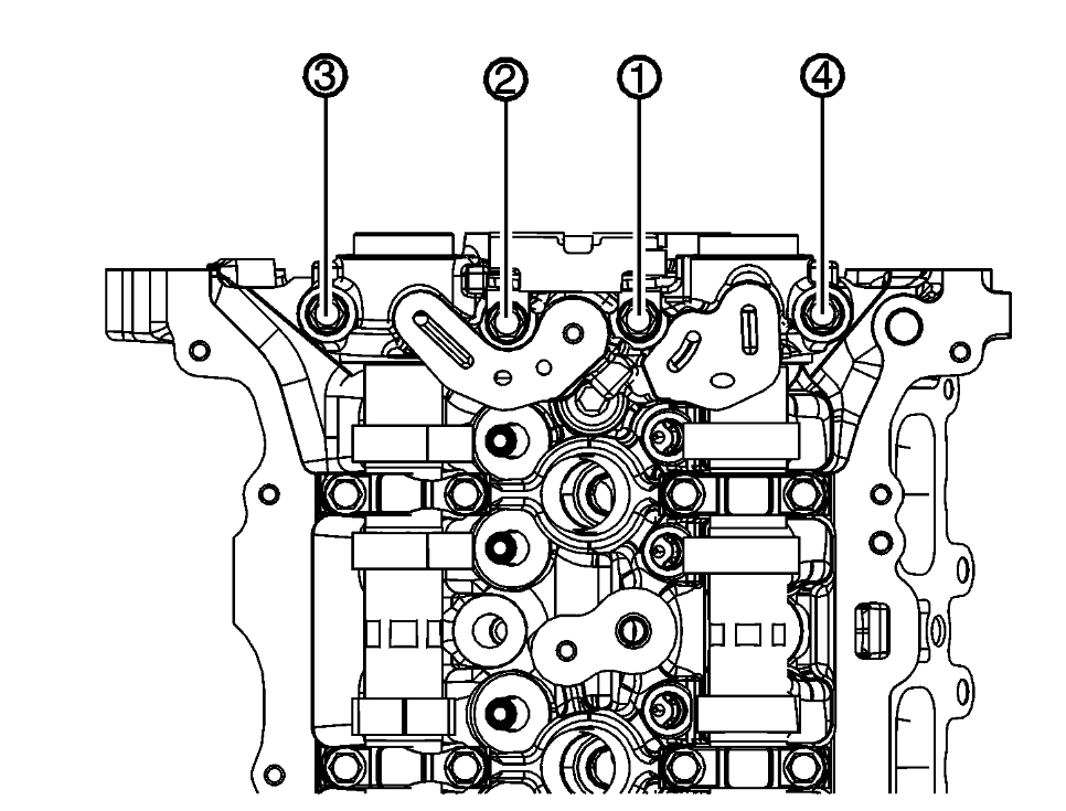

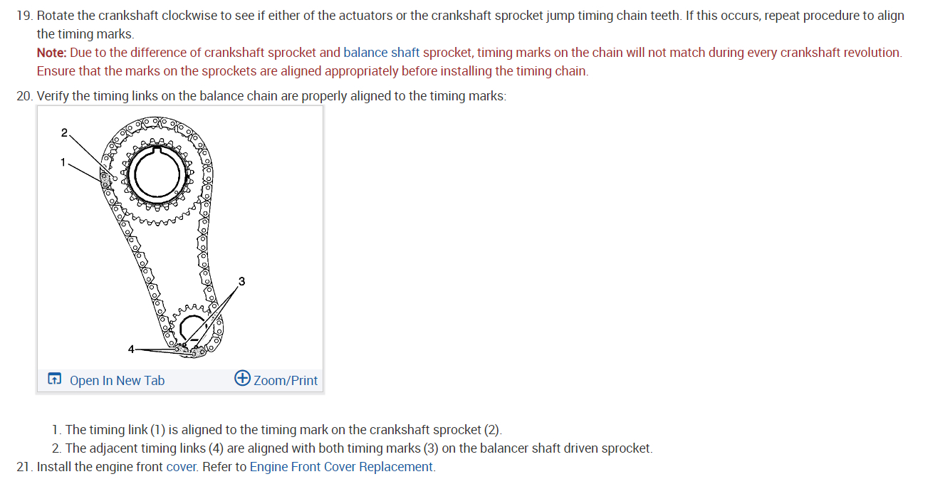

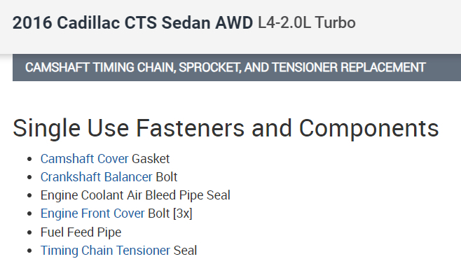

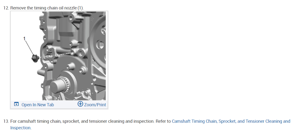

Sure, here are the engine timing chain marks and the torque specs for replacement, this shows everything you need to do the job completely. Check out the images (below). Let us know if you need anything else.

Are the 1st 2 pictures of the 2 chains supposed to line up at the same time?
Apr 13, 2024 at 11:35 AM
CERTIFIED EXPERT
53,854 POSTS
Yes, all marks line up at the same time.

I took the old timing chain off and put the new one on in the same position. Now I want to turn the motor counterclockwise until all links lineup where there supposed to go. I turned motor so large chain made 8 complete revolutions. Do I keep turning? Before I decided to do this but would stall at a light and do a lot of chugging. I want to make sure it didn't skip a tooth but so far, I haven't got close.
Apr 14, 2024 at 8:24 AM
CERTIFIED EXPERT
53,854 POSTS
You will need to turn the engine more times until the marks work their way around. Once the marks are lined up during installation is the best way to make sure you are all good.
