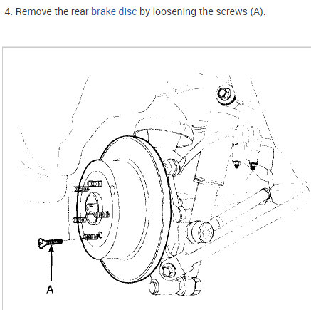

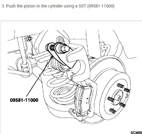

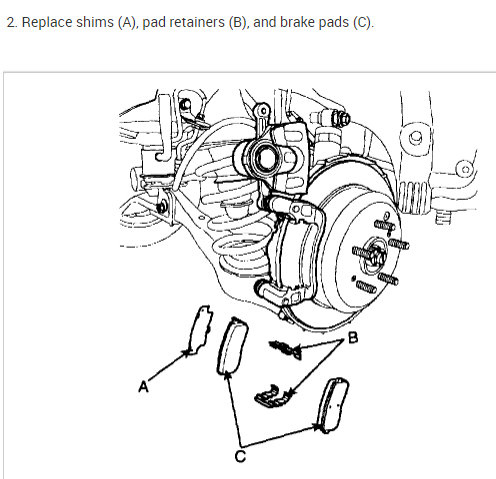

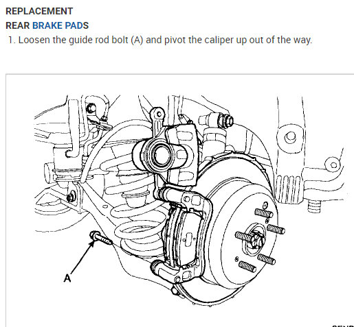

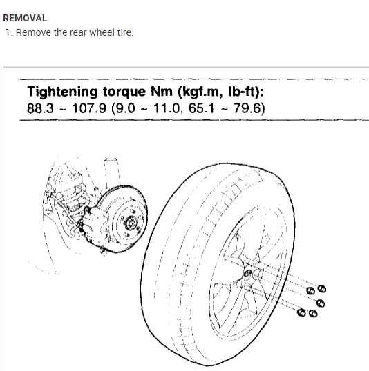

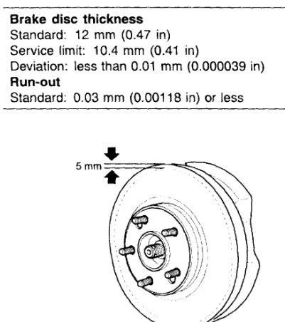

back brake pads wore completely off and only the inside of both back rotors were scorn severely. Front pads are still better than half good, bought this car new. Shouldn't front brakes where out 2 to 1 on pads, never did anything to the front pads what do you think is there a problem to why the back went bad first, anyway I need to do the brake can you help me please? Thank You!
