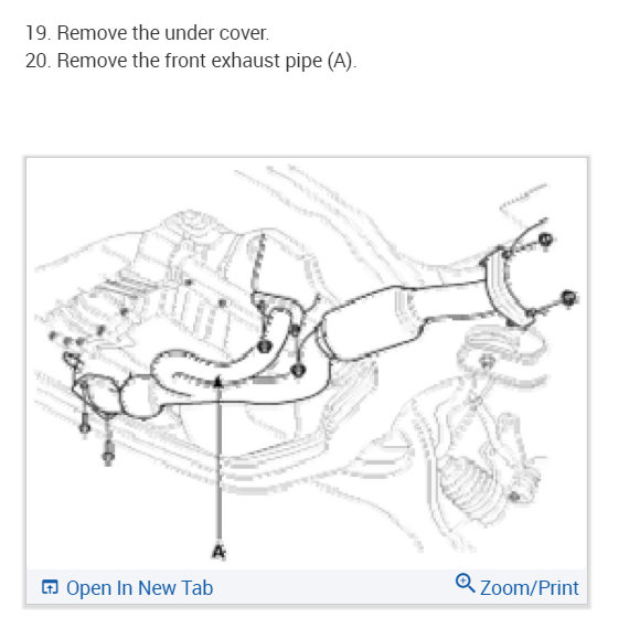

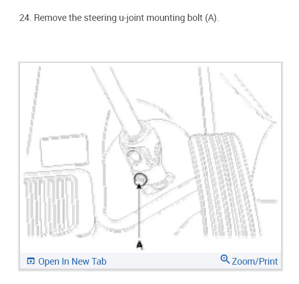

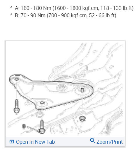

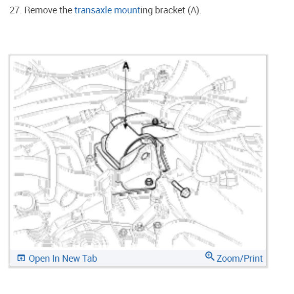

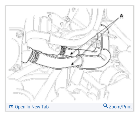

I am removing a manual transmission from the vehicle stated above. I have all of the bell housing bolts removed, cv shafts and mounts. The trans will only separate approx 1/4 inch away from engine block. Is there anything else that must be removed?

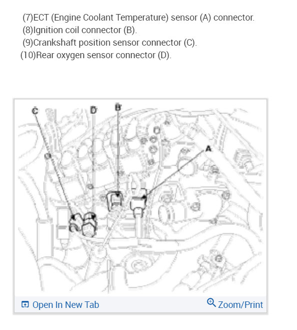

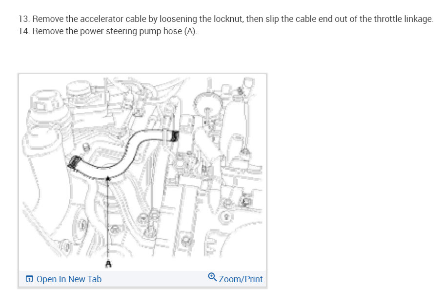

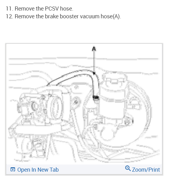

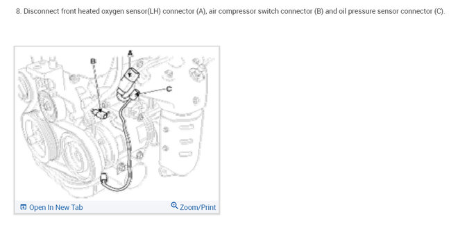

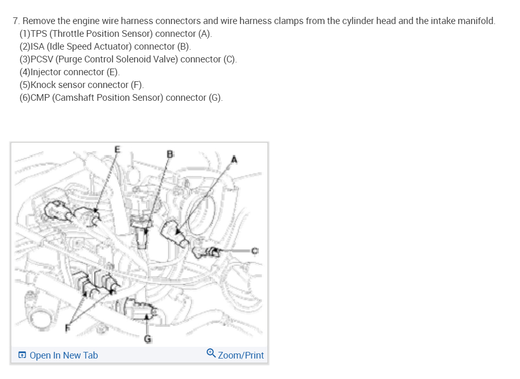

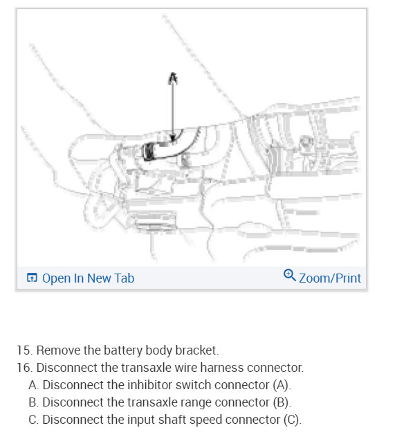

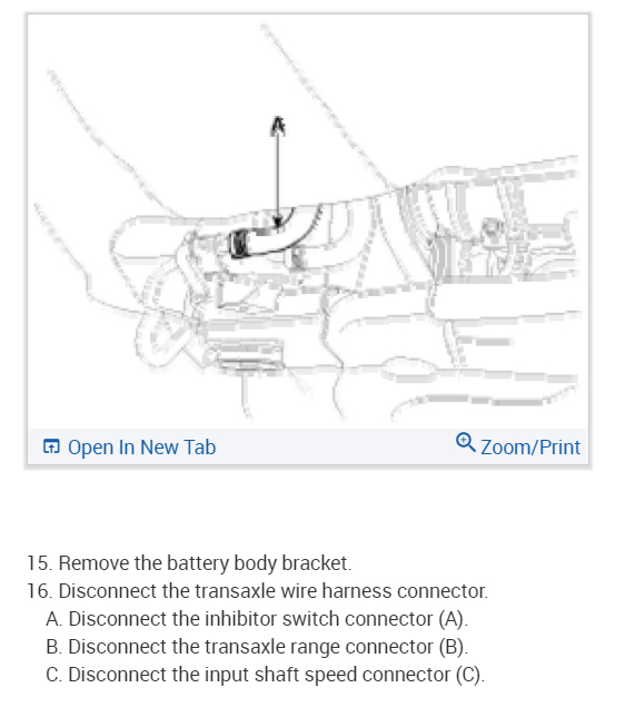

Hi Kitt82,

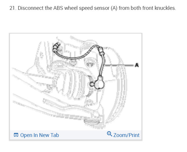

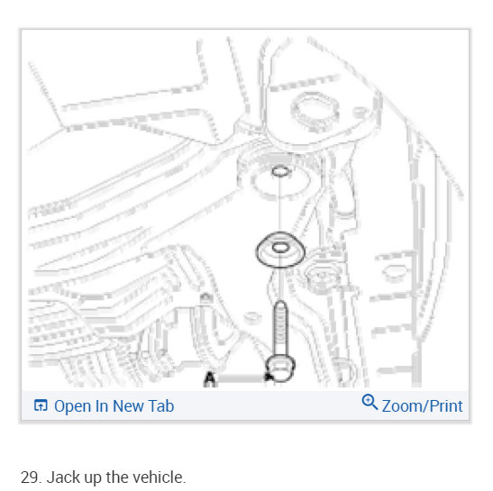

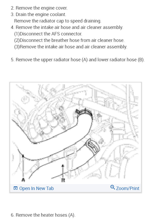

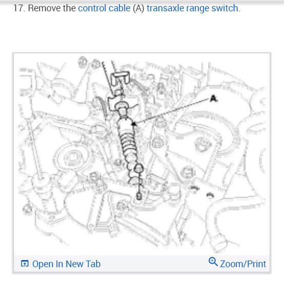

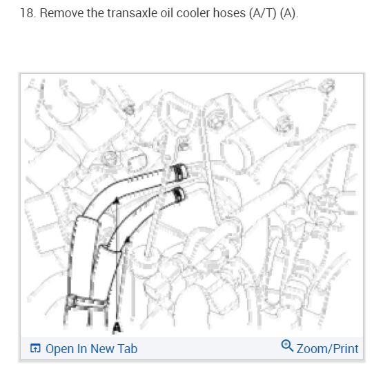

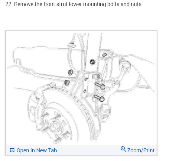

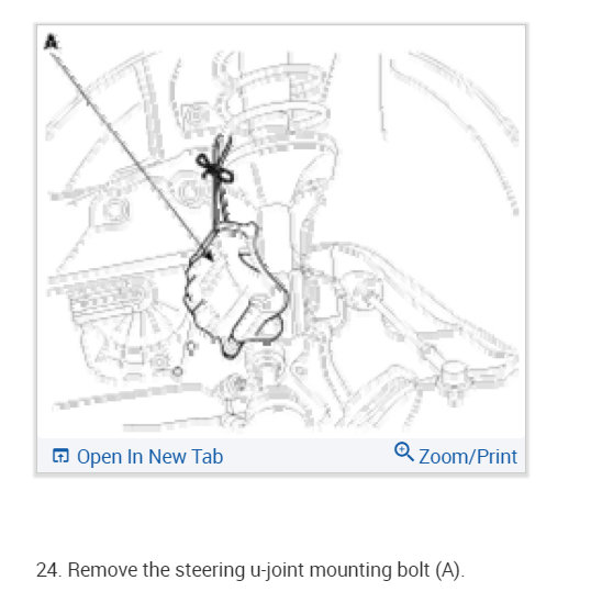

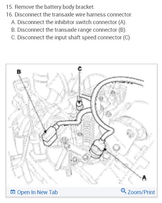

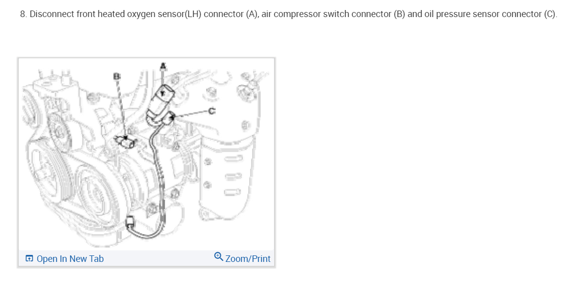

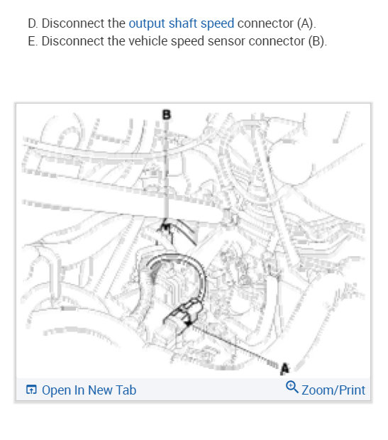

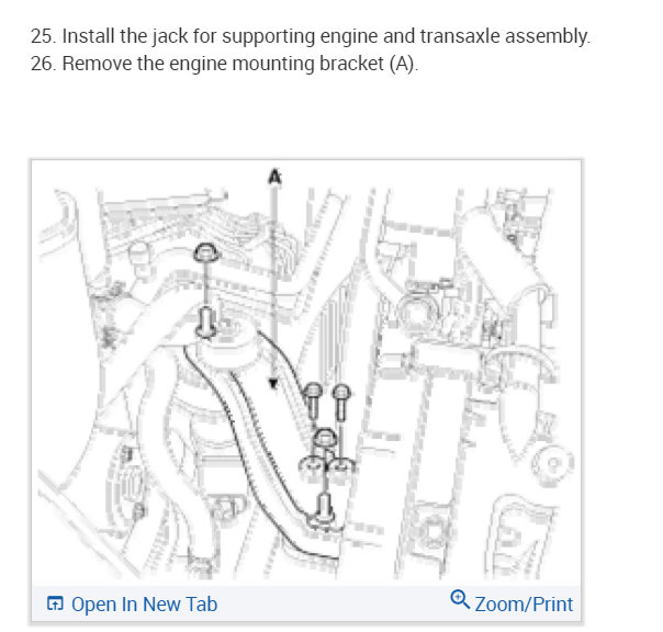

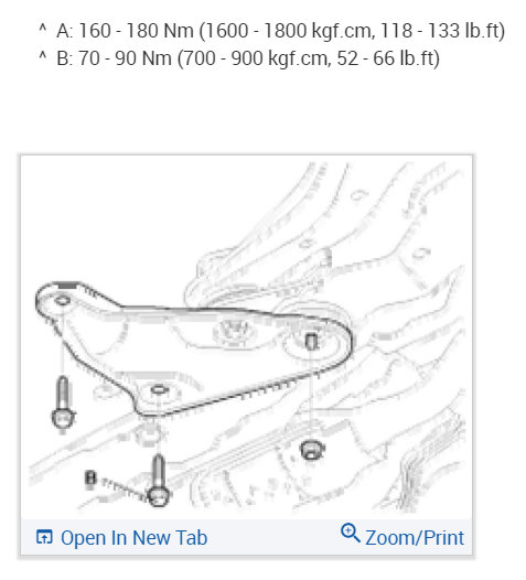

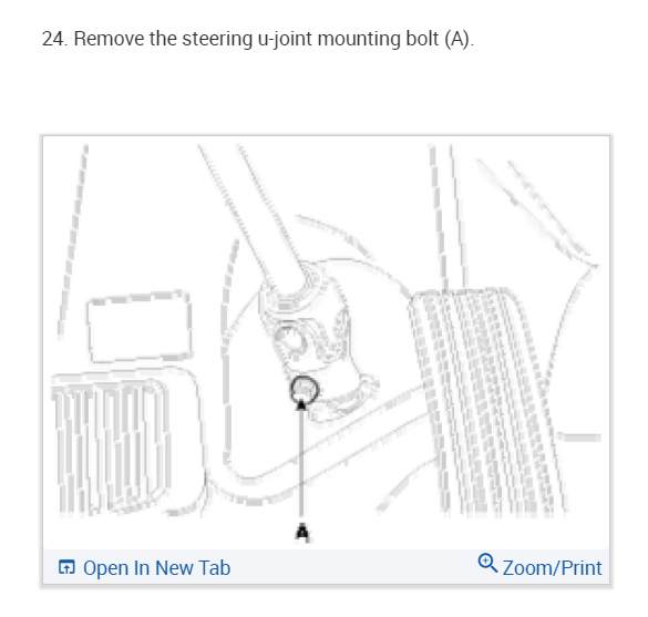

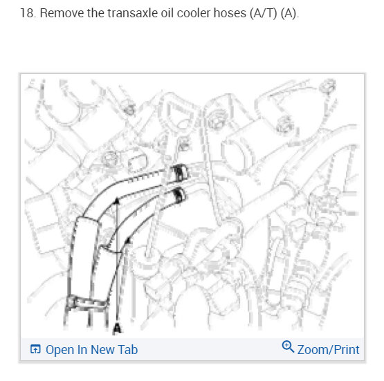

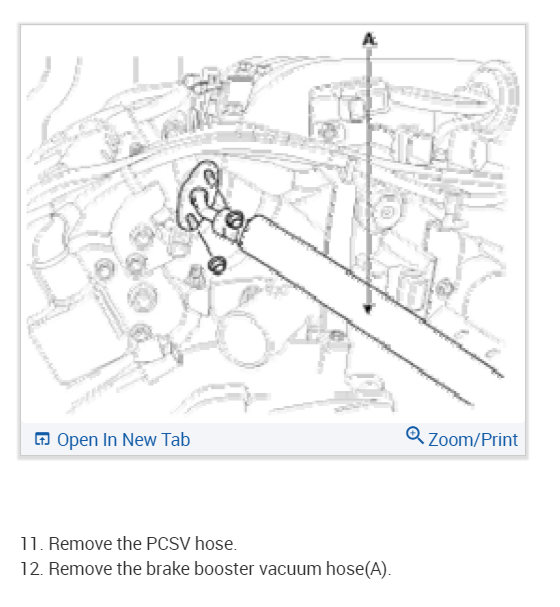

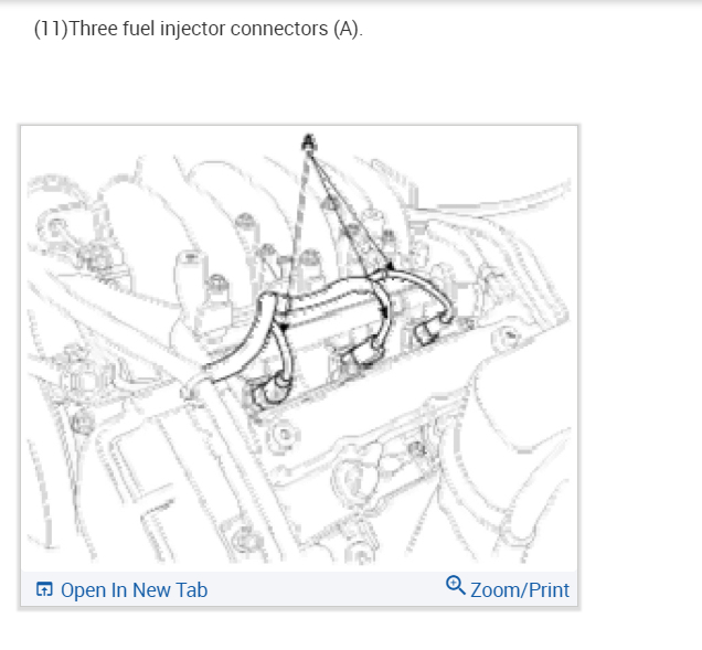

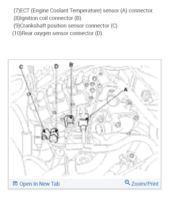

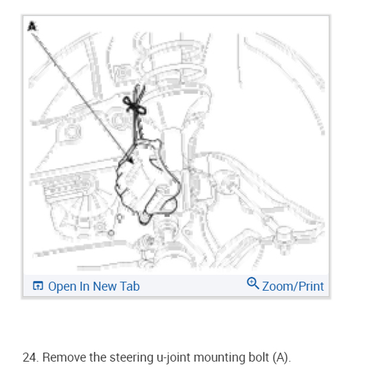

If it can move 1/4 inch all round, there is nothing more you need to remove, just that the clutch is sticking on the clutch shaft or the pilot bearing/bush is stuck on the clutch shaft. Here is a video of a FWD transmission being removed and clutch replaced in a similar car the process is the same with diagrams below to show you how on your car.
