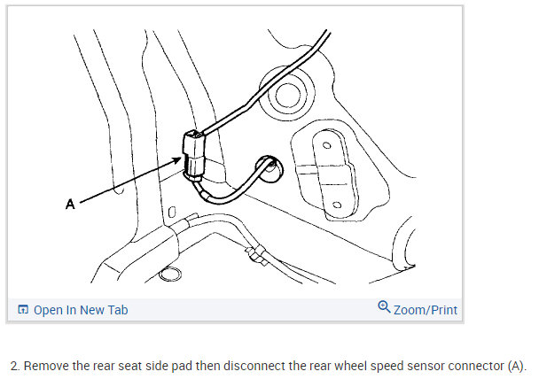

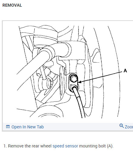

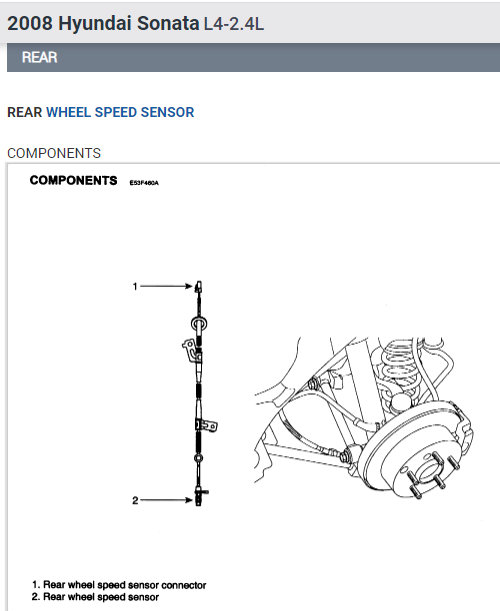

I was installing new rear rotors and I can't get the old ones off. I removed the mounting screw and all of the associated hardware, but the rotor will not budge. I released the emergency brake also. They seem to be stuck on due to heat or corrosion I would imagine. I finally got the rotor off but I wrecked the wheel speed sensor.
