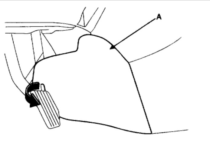

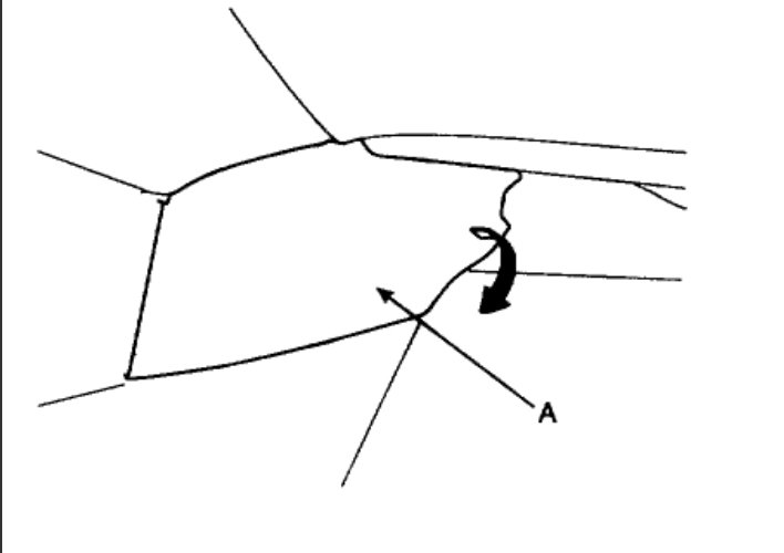

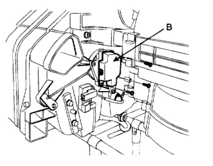

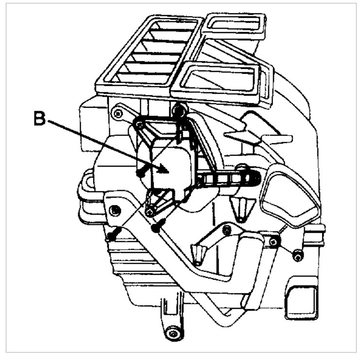

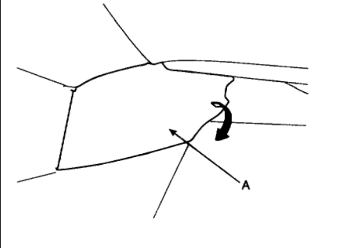

Below is the diagrams of how to will be like to replace the actuator on your car I have feature the temperature and the mode (second) actuators just in case.
