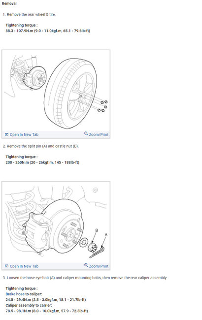

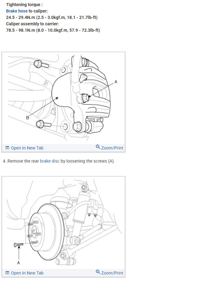

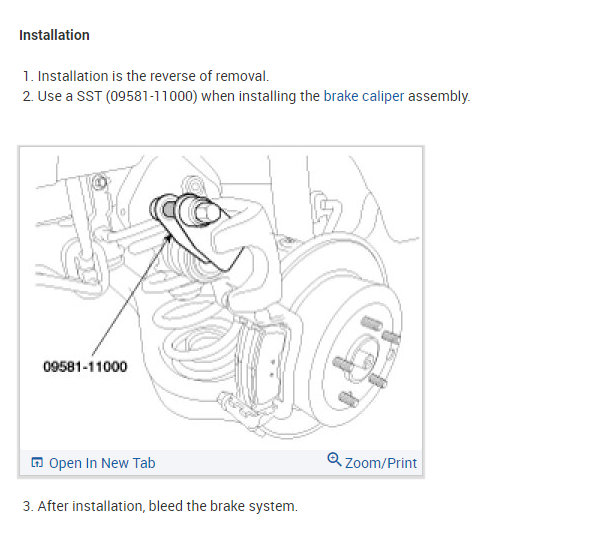

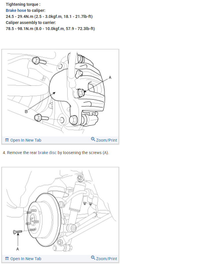

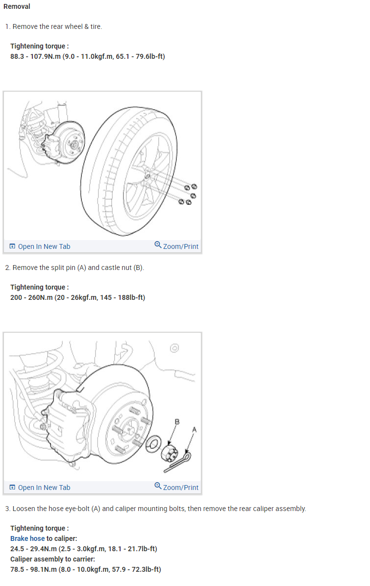

I was told that the "brake service" needs to be done, and I'd like to do it myself. what and how? Thanks.
Aug 9, 2010 at 2:10 PM
DAVEH429
  • 41 POSTS
Hello.
Below is a link to a generic guide for doing rear brakes. Also attached are the diagrams and instructions for your vehicle.
https://www.2carpros.com/articles/how-to-replace-rear-brake-pads-and-rotors
Hope this helps with your repair, Please keep us updated on your repair outcome and do not hesitate to contact us again for further information or assistance.
Thanks for using 2CarPros.
