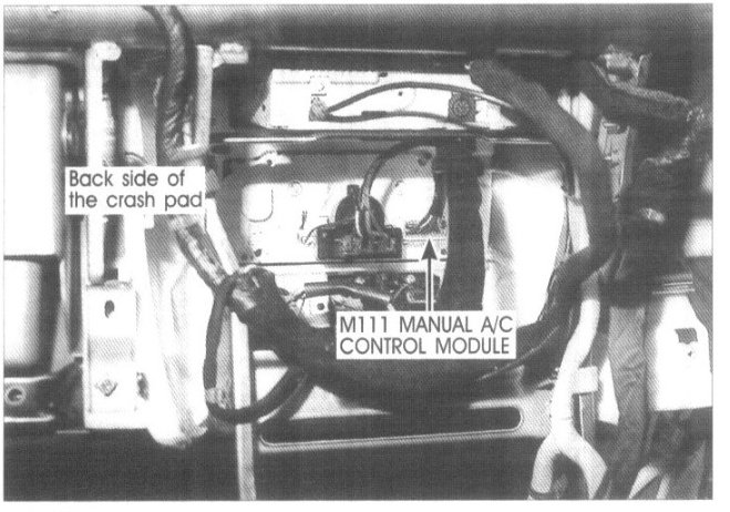

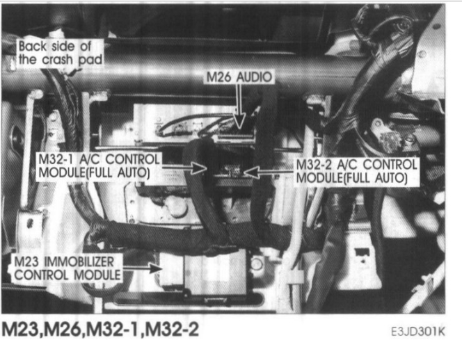

Some possible causes of intermittent cooling (or no cooling) on automatic A/C systems include all of the above, plus:
A problem in the control module or control head (this usually requires using a dealer scan tool to read fault codes and perform self-diagnostics).
A bad temperature sensor (an ambient air temperature sensor, interior air temperature sensor, evaporator temperature sensor, or sunload sensor). Again, a factory scan tool is usually required to perform diagnostics on the system.
