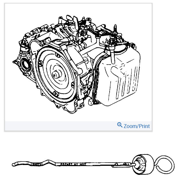

Here is a guide to help you see what you are in for when doing the job and instruction below on how to do it on your car:
22 - Filter 4632139010 31.39
Check out the diagrams (below). Please let us know if you need anything else to get the problem fixed.

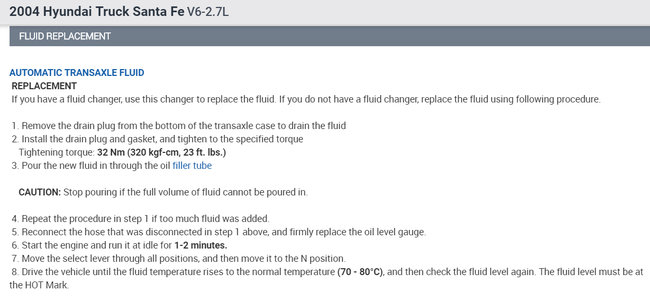

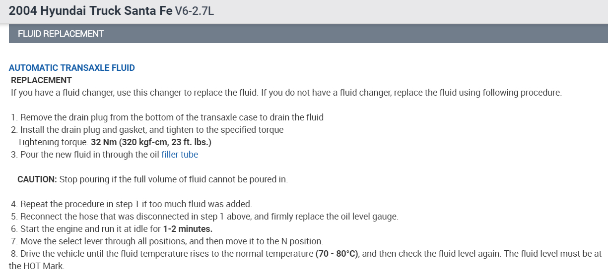

DESCRIPTION:
Hyundai has deleted the external oil filter (P/N 46322-39000) on all Elantra, Sonata, Santa Fe and XG300 transaxies effective with the production dates listed below. These transaxies are equipped with an internal oil filter that needs to be changed only during transaxle overhaul.
On a normal transmission you have to drop the pan to access the filter. When you look at a new filter, you will see that it sits inside the pan, and it will likely come with a new pan gasket. Some of these cars do not have a filter you might have one of them.
REPLACEMENT
If you have a fluid changer, use this changer to replace the fluid. If you do not have a fluid changer, replace the fluid using following procedure.
1. Remove the drain plug from the bottom of the transaxle case to drain the fluid.
2. Install the drain plug and gasket, and tighten to the specified torque.
Tightening torque: 32 Nm (320 kg-cm, 23 ft. lbs.)
3. Pour the new fluid in through the oil filler tube.
CAUTION: Stop pouring if the full volume of fluid cannot be poured in.
4. Repeat the procedure in step 1 if too much fluid was added.
5. Firmly replace the oil level gauge.
6. Start the engine and run it at idle for 1 - 2 minutes.
7. Move the select lever through all positions, and then move it to the N position.
8. Drive the vehicle until the fluid temperature rises to the normal temperature (70 - 80°C), and then check the fluid level again. The fluid level must be at the HOT Mark.

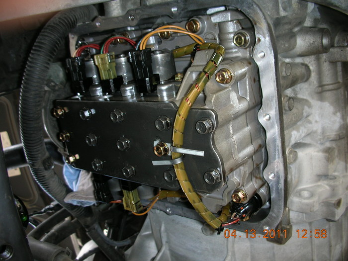

I took a picture of the transmission pan. There is no filter only the control solenoids here is a picture of it. Can you help me? I have change other transmission filters they are like you said, but not on this car.
Feb 5, 2021 at 11:10 AM (Merged)
CARADIODOC
  • 34,306 POSTS
I do not see a filter. I looked the filter up on rockauto.com, and they list four different filters. Only one of them is a spin-on filter. The other three are internal and are all very different.

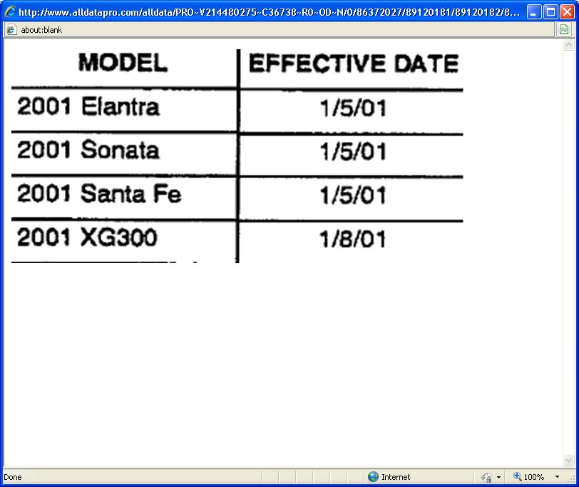

Please read the bulletin below and what I posted let me know what the production date of your Santa Fe is and we will go from there.
OIL FILTER REPLACEMENT:
2001 Hyundai Truck Santa Fe V6-2.7L DOHC MFI
Fluid Filter - A/T: Technical Service Bulletins A/T - External Filter Deletion
Group: TRANSAXLE Number: 01-40-007
Date: APRIL, 2001
Model: 2001 ELANTRA, SONATA, SANTA FE & XG300
Subject:
2001 ELANTRA, SONATA, SANTA FE AND XG300 AUTOMATIC TRANSAXLE EXTERNAL OIL FILTER DELETED
DESCRIPTION:
