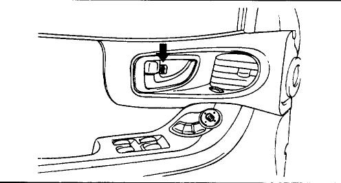

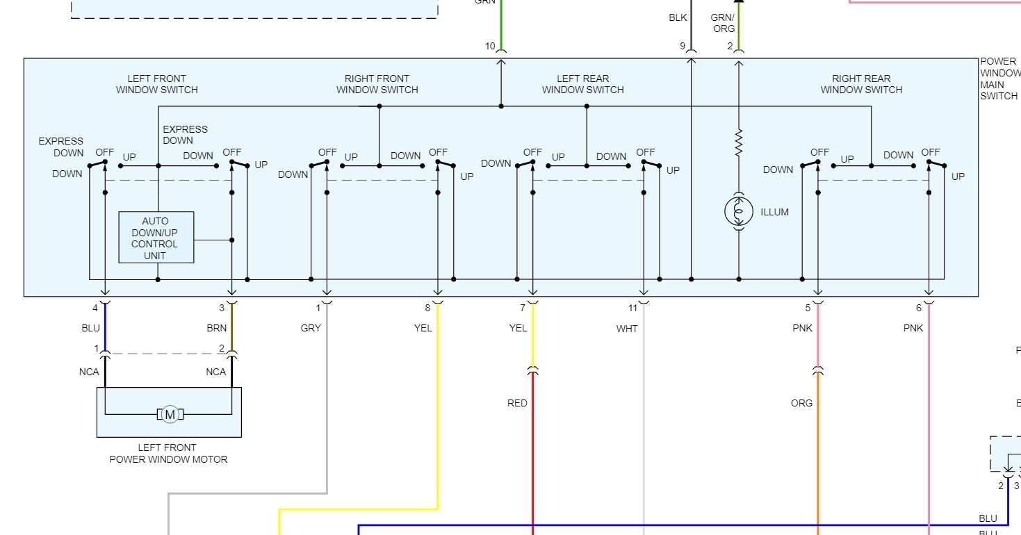

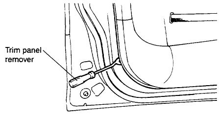

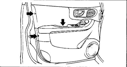

Testing requires that the inner door panel be removed to access the window switch and it's connector. To do that you remove the screws shown in the images, then use a trim tool to pop the retainers free so you can remove the trim panel. Then you can unplug the switches and test the motor to see if it's the motor or the switch. To test that you need to have a pair of wires connected to the battery. Then you use them in the connector you removed from the switch. There will be a pair of wires a Blue one and a Brown one which power the drivers window motor. If you use the jumper wires to touch the terminals for those wires you can duplicate the way the switch works. If you connect power wires up with battery positive to the Brown wire and battery negative to the Blue wire, the window should go down if the motor is OK. Then if you reverse those two wires the window should go up.
If that works properly then the switch is faulty and replacing it will solve the problem.
