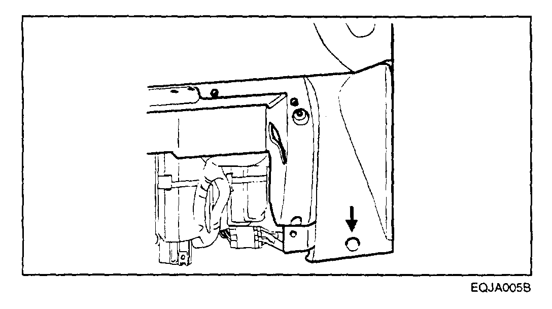

1. Remove the glove box housing.

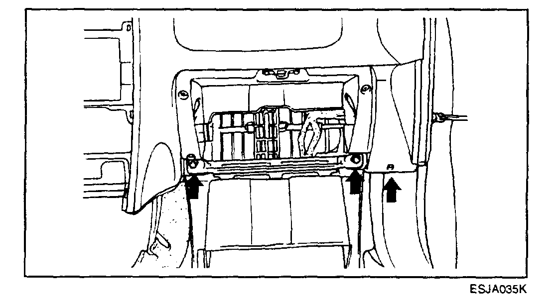

pic 2
2. Remove the lower side cover of the crash pad.

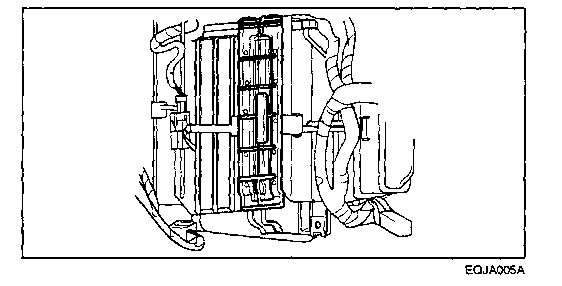

pic 3
3. Remove the upper cover of the glove box.

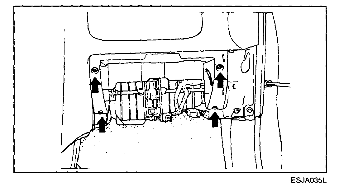

pic 4
4. Remove the air filter cover and the air filter.

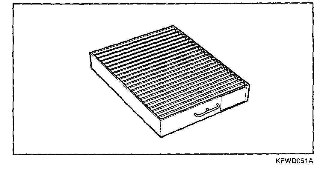

pic 5
CAUTION: When driving in an air-polluted area or rugged terrain, check and replace the air filter as frequently as possible.
