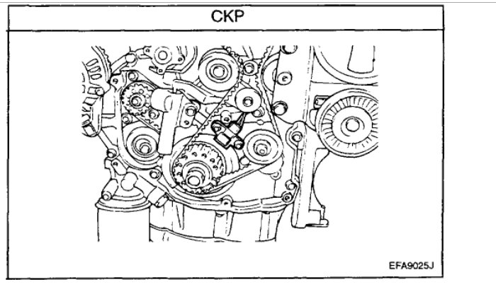

The crankshaft sensor is located at the front of the engine down at the timing belt pulley. You will need to remove the timing belt cover. here is a diagram to help you see what I am talking about. The six.
Here is a guide that can give you more information on the job:
Here is what it will be like (below) for four and six cylinder engines.
Cheers

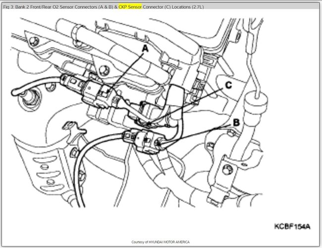

Here are some pictures that should help you:
Dec 29, 2016 at 6:32 PM (Merged)

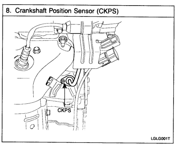

MUSA BELLO
I want to locate the sensor, and possibly see the part number. or if any one knows how to kindly help me?
WRENCHTECH
  • 20,761 POSTS

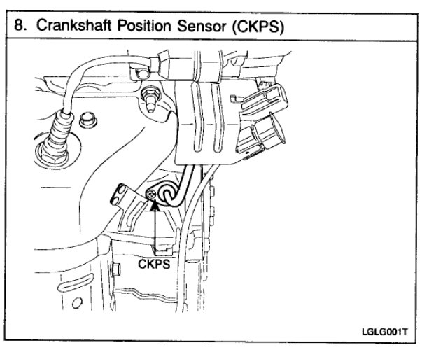

The crankshaft sensor is in the side of the block, behind the exhaust manifold. https://www.2carpros.com/images/external/139983558.gif Part# 391803E100 $74.27
Hey MUSA,
The crankshaft position sensor is in the side of the block, behind the exhaust manifold.
Here is a diagram to help you locate it:
Please let us know what you find so it will help others.
Best, Ken
Dec 29, 2016 at 6:33 PM (Merged)

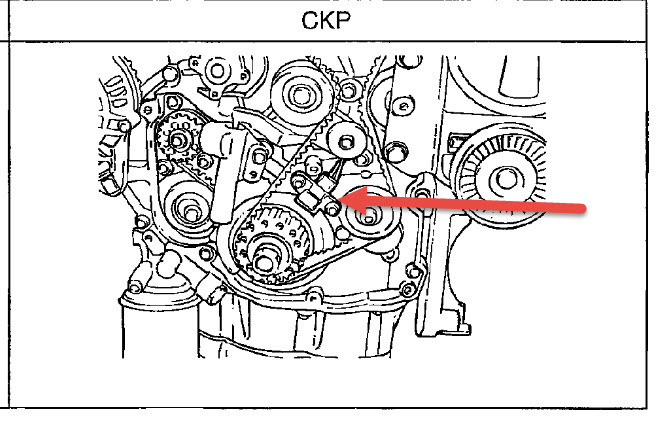

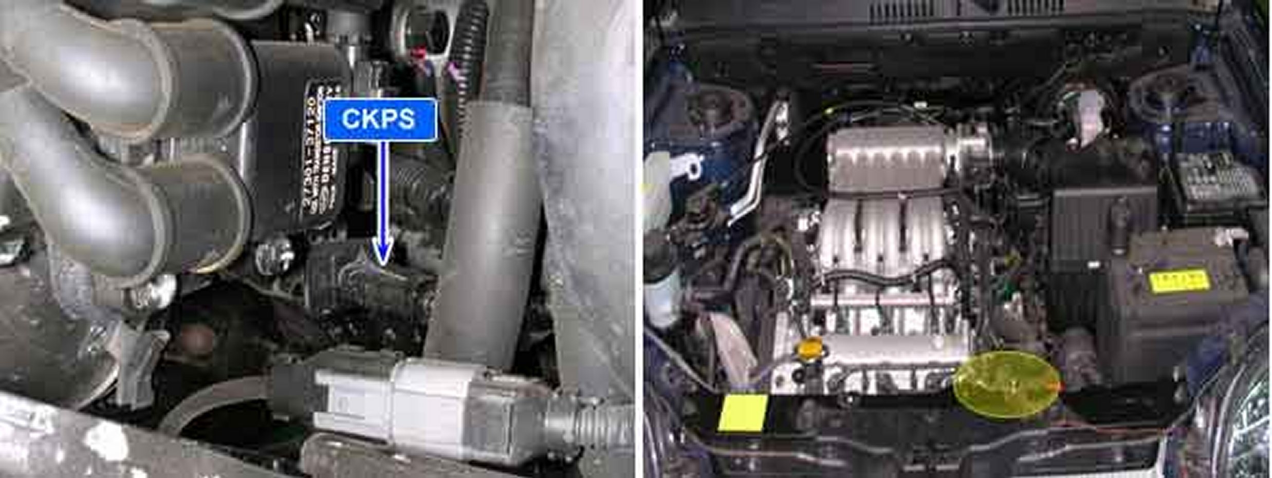

Four cylinder front wheel drive manual.
Where is the crankshaft position sensor and how long does it take to replace on a 2.4L?
RASMATAZ
  • 75,992 POSTS
https://www.2carpros.com/forum/automotive_pictures/12900_ckp_1.jpg
https://www.2carpros.com/forum/automotive_pictures/12900_ckpp_1.jpg
Note:Part and labor may vary within location. https://www.2carpros.com/kpages/auto_repair_manuals_alldata.htm

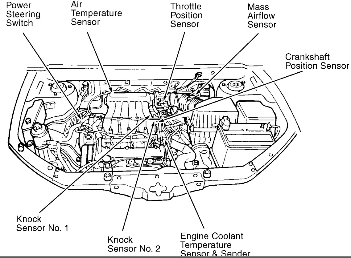

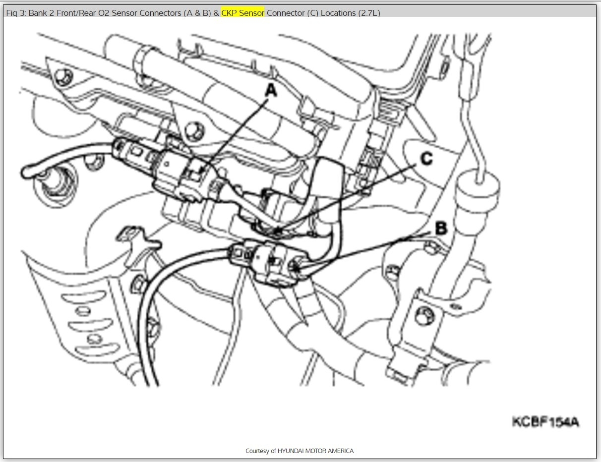

My SUV suddenly would not shift into second gear going down the highway. I babied it home and noticed also that placing it in reverse the engine immediately quit. Idle the car and it is fine. Placing it in drive it jumps. So I took out my computer check tool and it said the crankshaft sensor was bad.
So I guess I need to know where this is located on the engine? Thanks, Mark
Oct 12, 2017 at 3:11 PM (Merged)
HMAC300
  • 48,601 POSTS
I doubt it is your crank sensor, but here is location in picture. if it still does it have a transmission professional check it. It may be a governor or in need of transmission rebuild.
MCAVINEE
  • 69 POSTS
Reason I said the sensor is my tester gave me the p003 and said crankshaft position sensor. Somebody told me that I would have to remove the timing belt cover and crankshaft pulley. You are showing the sensor at the top of the engine?
HMAC300
  • 48,601 POSTS
that is what our book says its location is.
