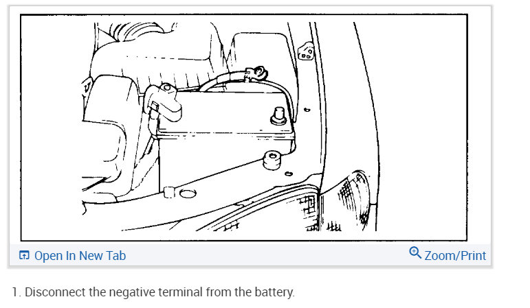

I have a 1997 Hyundai Elantra GLS 1.8L engine. It has 100,060 miles and need to replace the alternator but I need step by step instructions. I am a single mom and can't afford the repairs unless I do it myself. HELP! :shock:

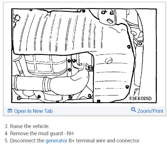

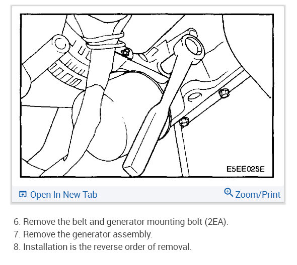

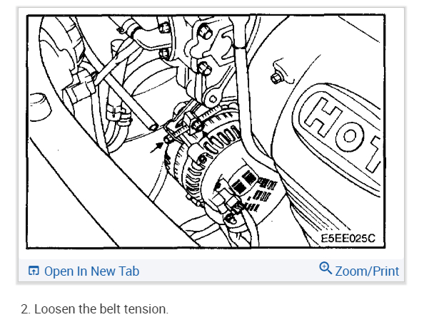

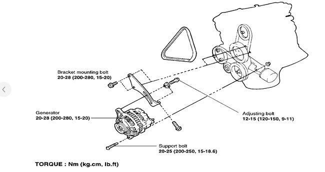

Here is a guide to help walk you through the steps and diagrams below to show you how its done on your car.
https://www.2carpros.com/articles/how-to-replace-an-alternator
