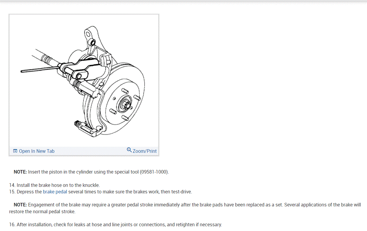

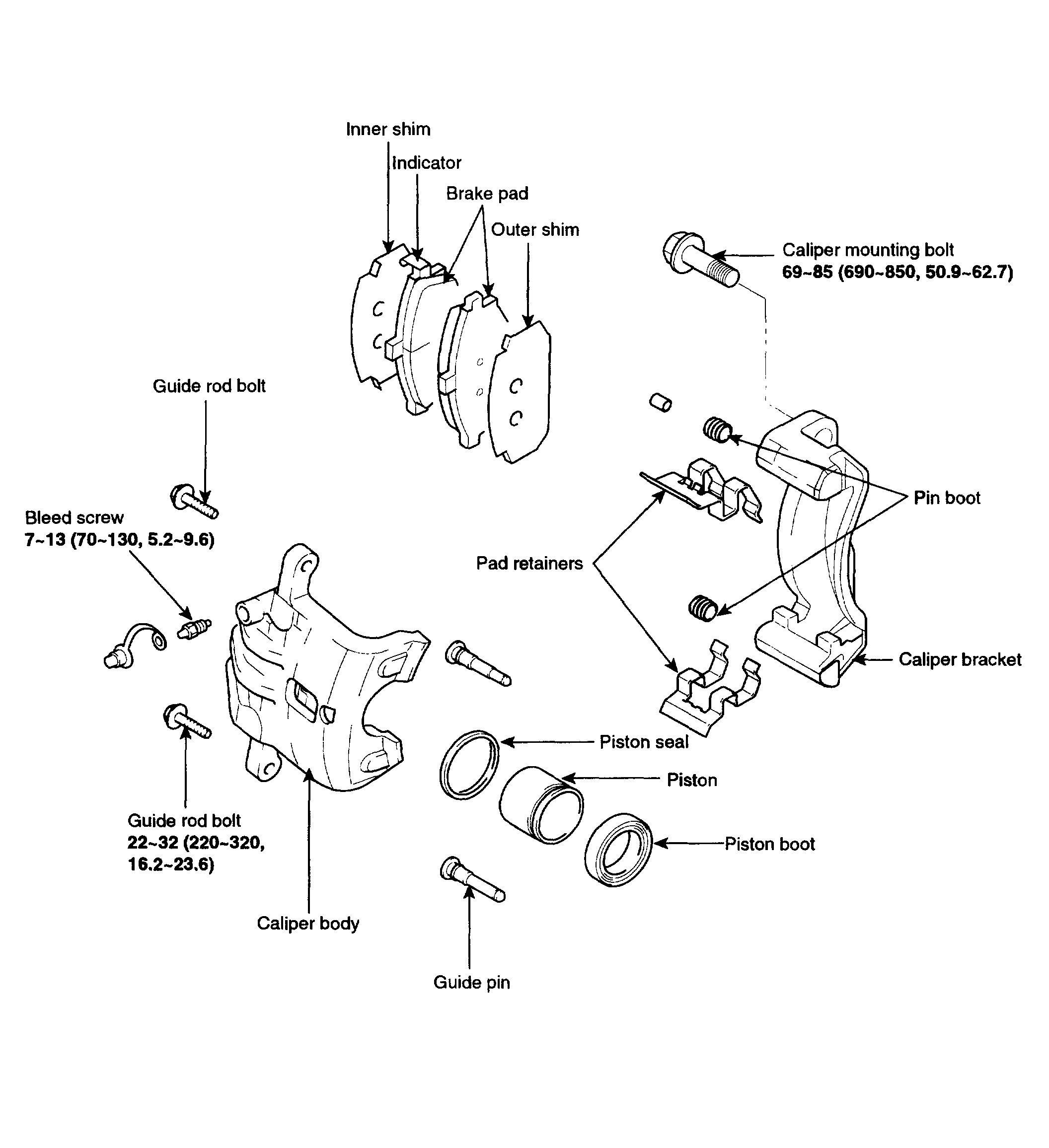

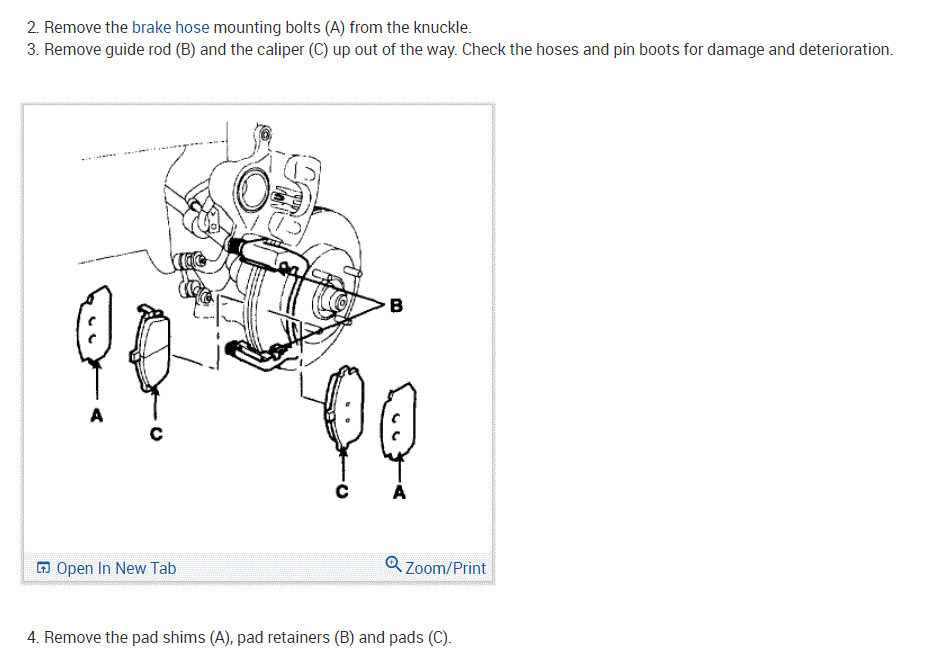

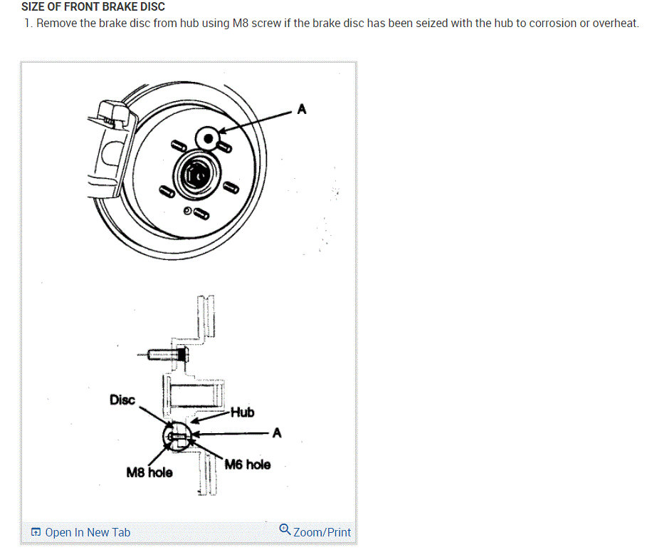

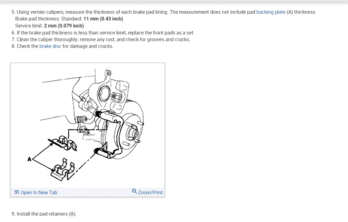

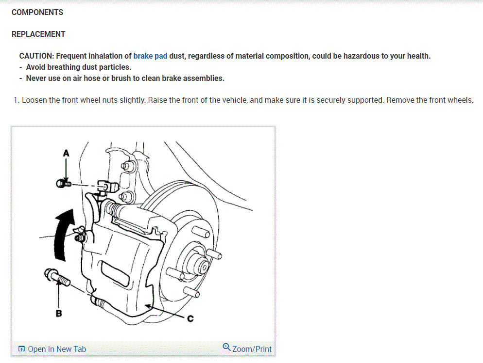

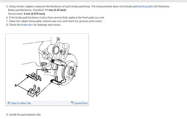

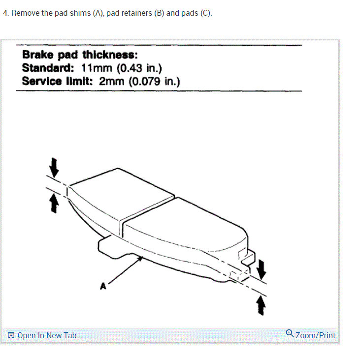

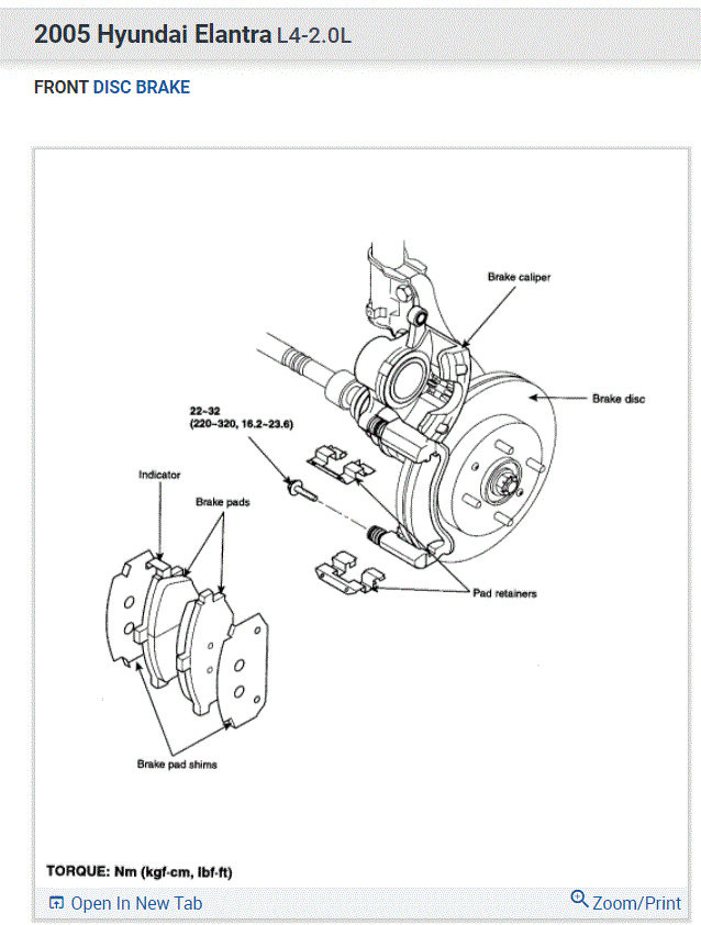

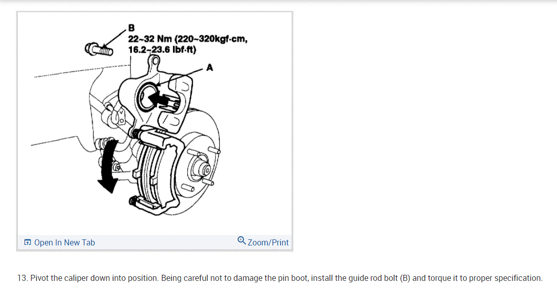

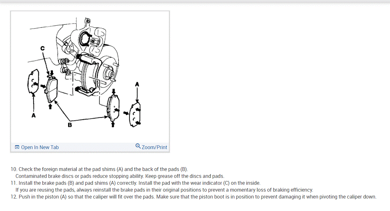

If you look at the pics below, they include the directions and pictures specific to your vehicle for this job. Also, here is a video showing the procedure being done on a Sonata. It's a different model, but the procedure is very similar.
https://youtu.be/7zjHSFVangI
PS: See pics below for directions.
