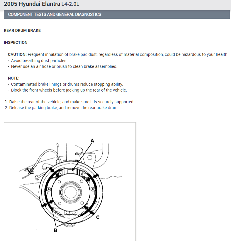

Unless the rear brakes are seized on the engaged position you should be able to tap around the drum with a hammer and get it to come loose.
Here is a helpful video of how to remove a stuck brake drum:
https://youtu.be/UV0kfP17Co0

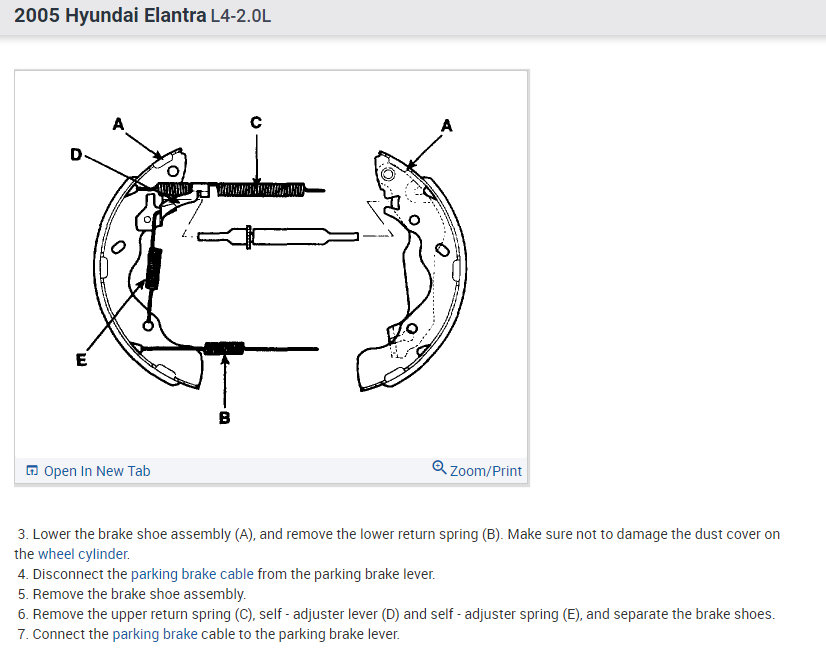

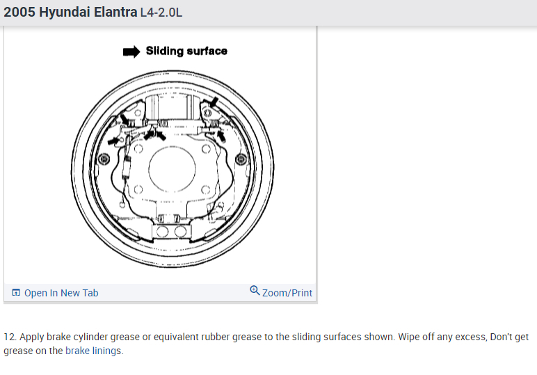

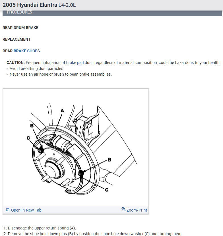

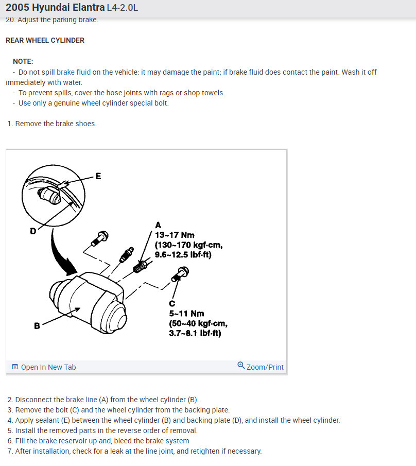

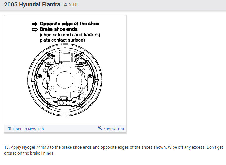

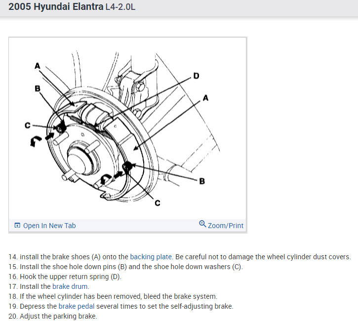

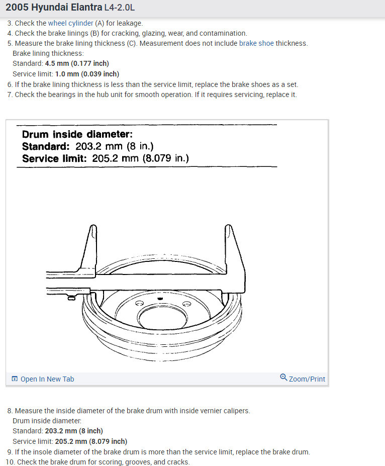

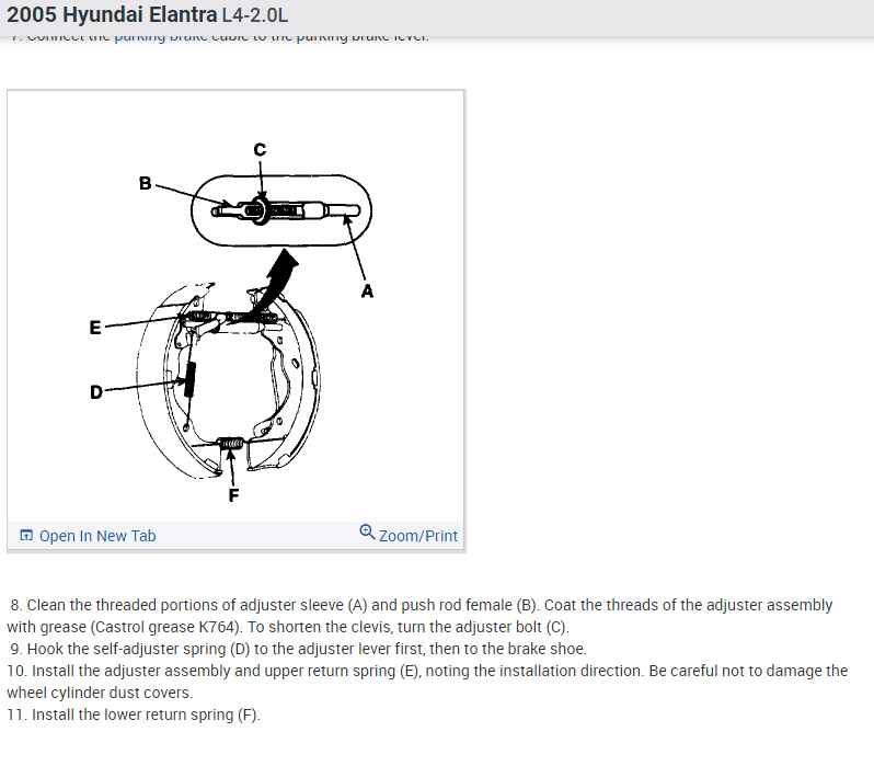

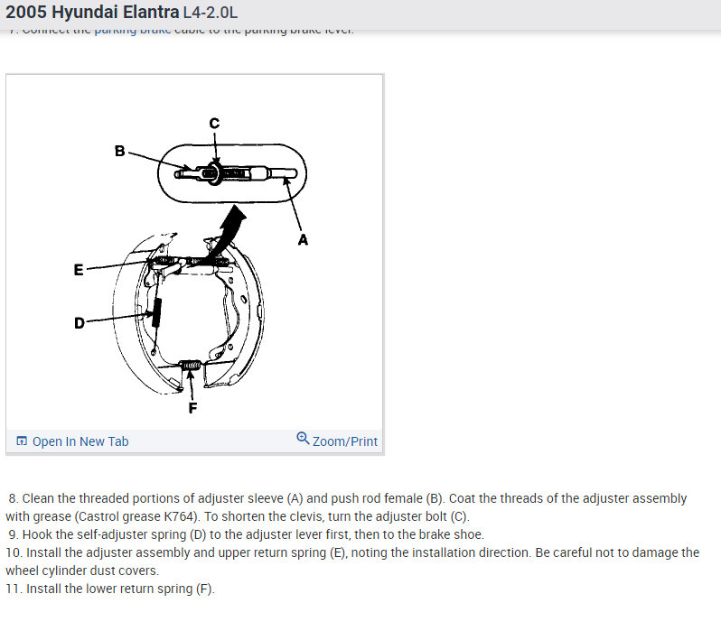

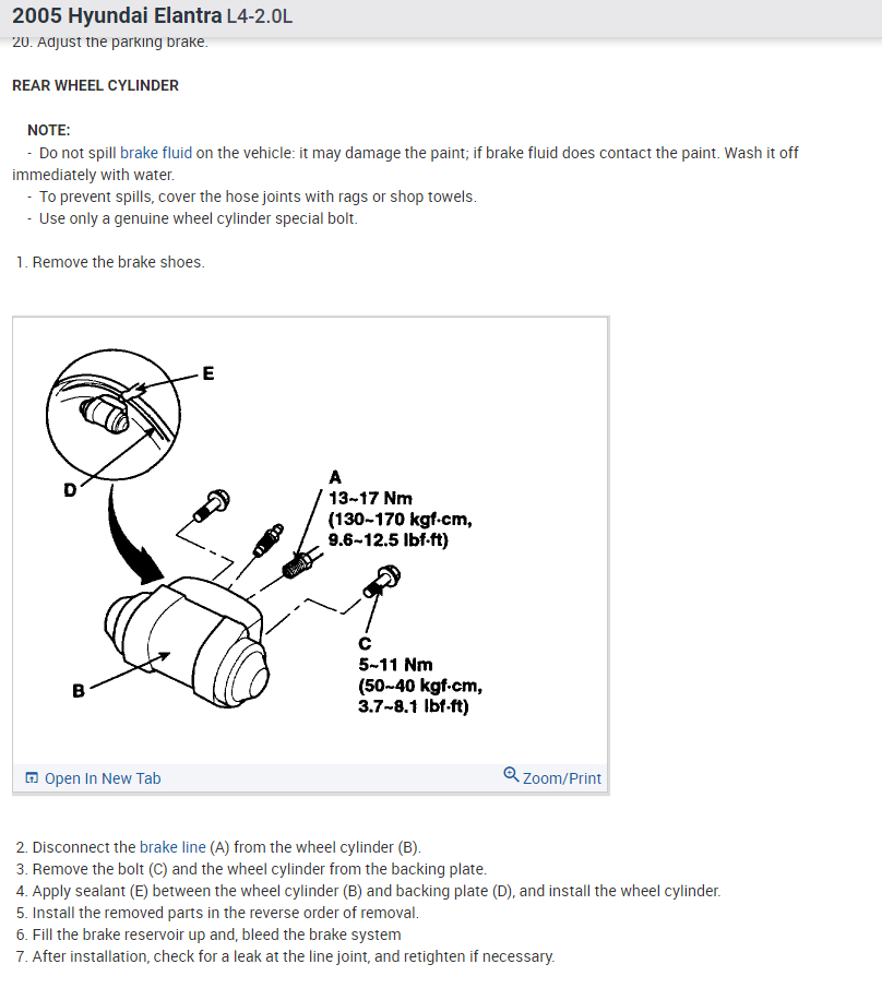

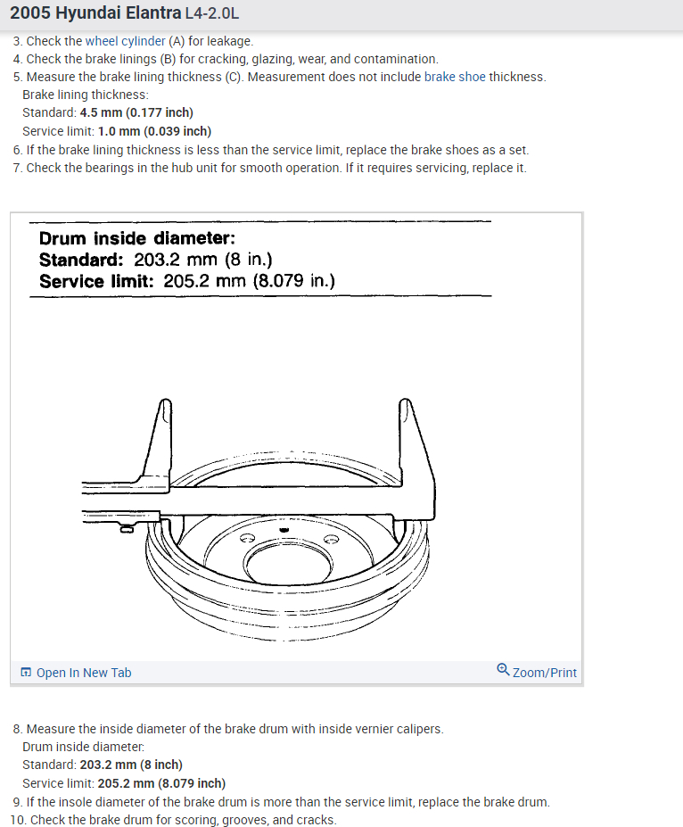

I have attached the complete rear brake replacement procedures below.
