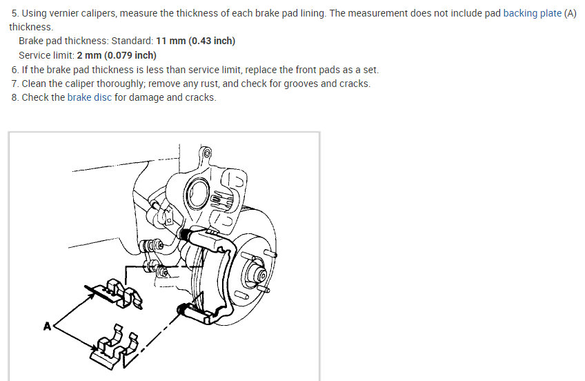

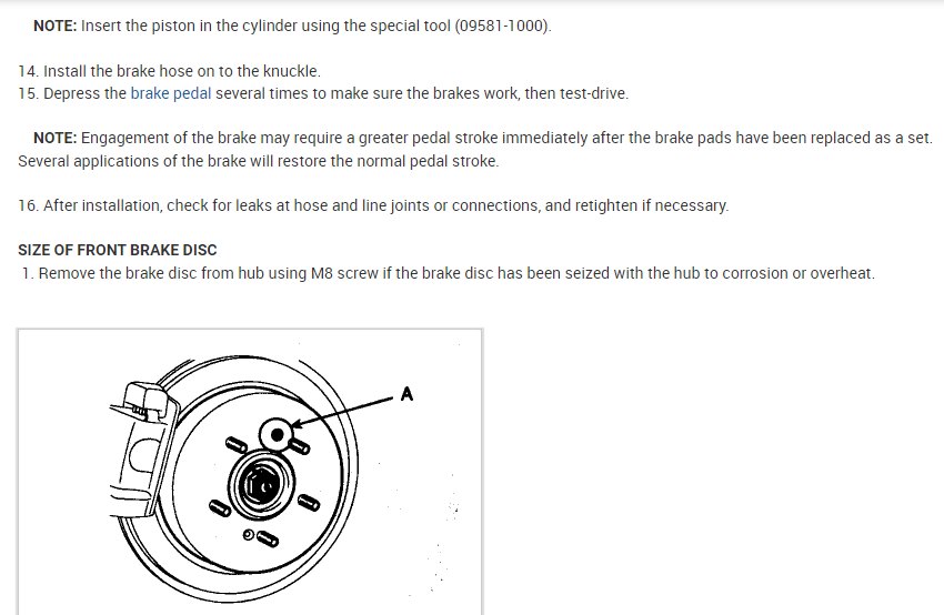

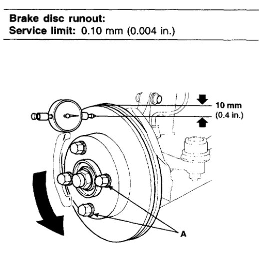

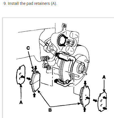

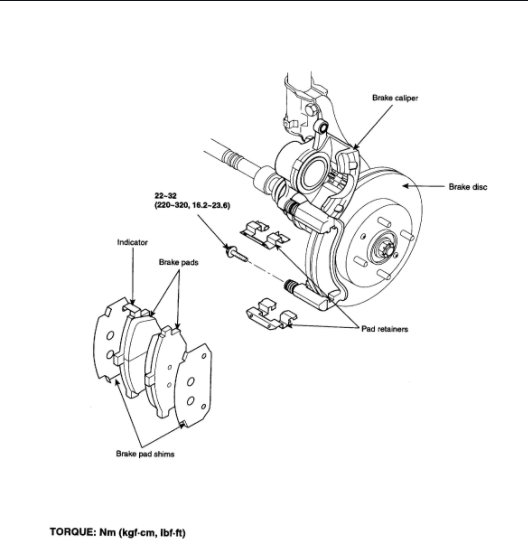

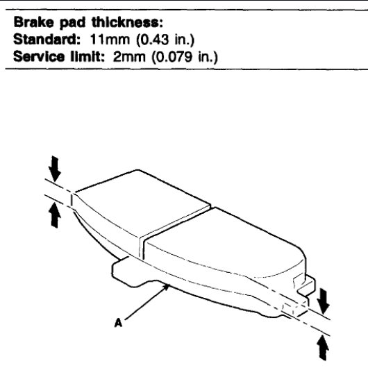

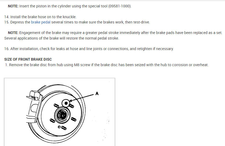

I just replaced both low beam bulbs and the passenger side but now I noticed I need to do the brakes can you help me?
Apr 19, 2010 at 6:43 PM
DANNY L
CERTIFIED EXPERT
5,648 POSTS
Hello, I'm Danny.

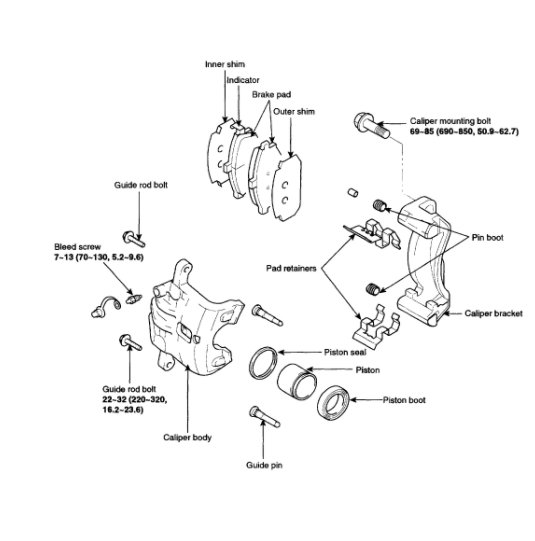

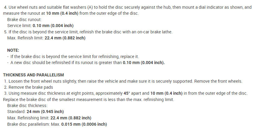

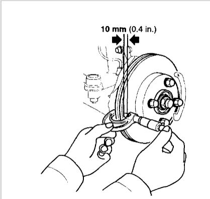

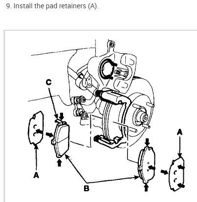

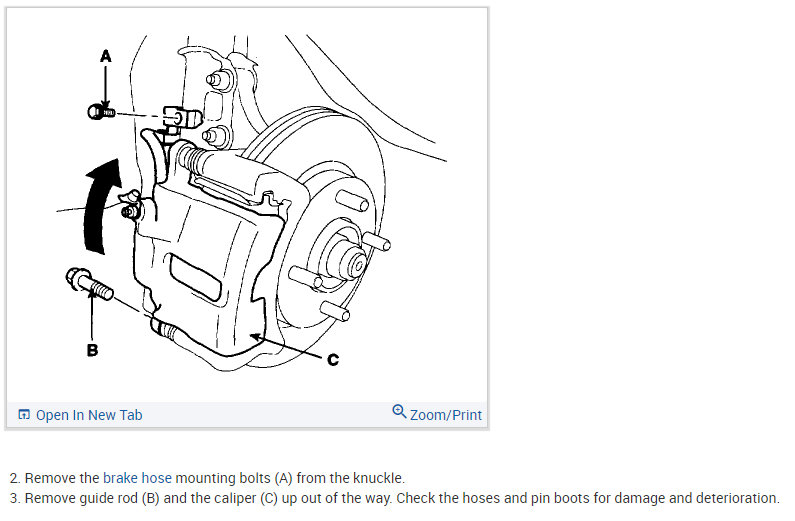

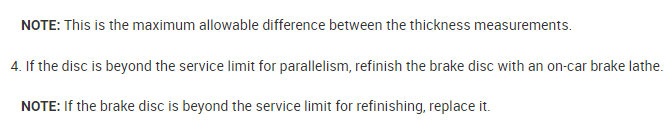

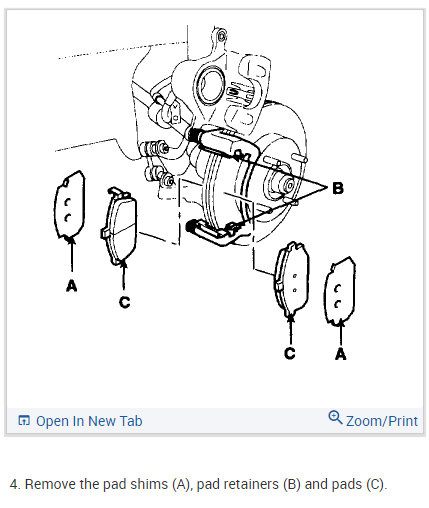

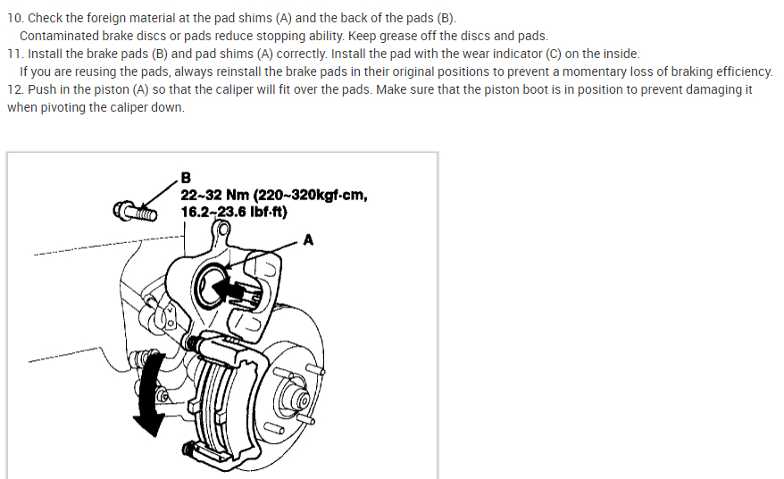

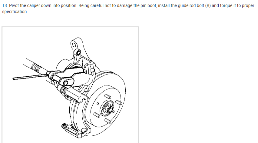

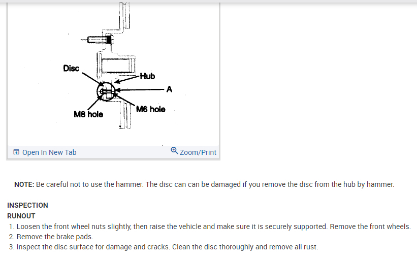

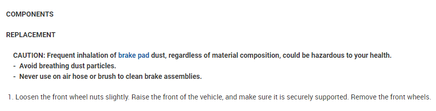

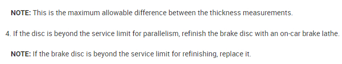

Here is the information you requested. This is a tutorial showing what is involved on how to change front brake pads and brake rotors:
I've attached picture steps below on how to change the front brake pads and rotors on your Hyundai. Hope this helps and thanks for using 2CarPros.
