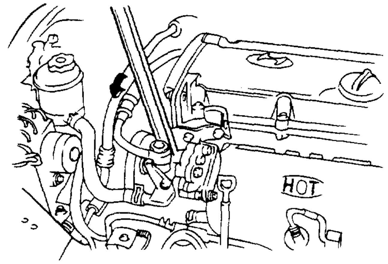

It sounds like the power steering pump is loose. You should not have more than 1/2 inch up and down play. If there is more, adjust or replace the belt.

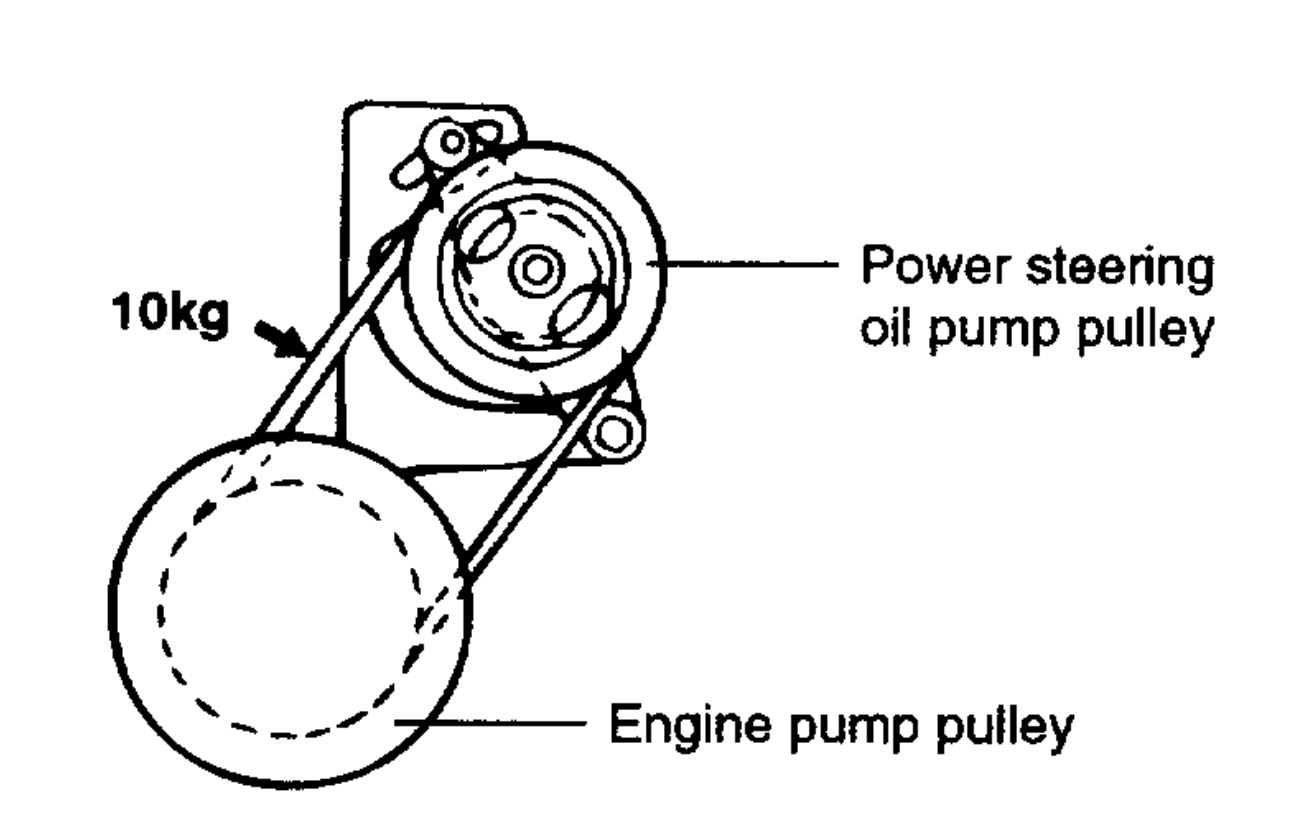

1. Press the V belt, applying a pressure of 98 N (10 kg, 22 lbs.) at the specified point and measure the deflection to confirm that it is within the standard value.
standard value
V belt deflection: 6 - 9 mm
2. If the belt deflection is beyond the standard value, adjust the belt tension as follows.

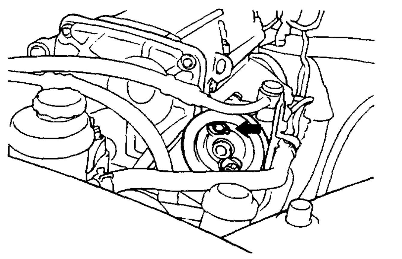

1. Loosen the bolt adjusting the power steering "V" belt tension.
2. Put a bar or equivalent, between the bracket and the oil pump and adjust the tension so that the belt deflection is within the standard value.
3. Tighten the bolt adjusting the power steering "V" belt tension.
4. Check the belt deflection and adjust it again if necessary.
Let me know what you find.
See the diagrams below

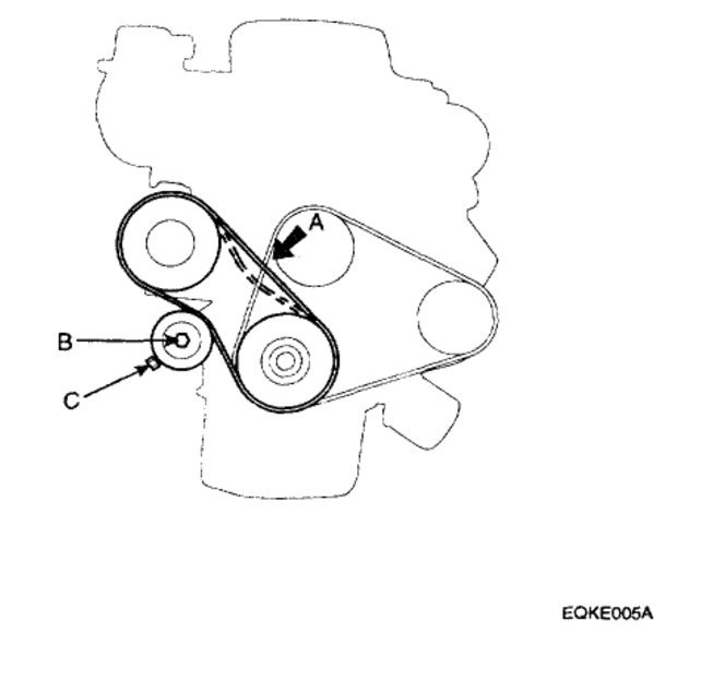

It sounds like the belt tensioner is not doing its job correctly or not adjusted right, but to be sure remove the serpentine belts and start the car to see if the noise is gone. This will confirm the belt is the problem.
If so then double check the size of the belt and make sure the tensioner spring is working correctly. Here is a diagram (below).
https://www.2carpros.com/articles/replace-serpentine-belt
and
https://www.2carpros.com/articles/how-a-serpentine-belt-tensioner-works
Please let us know what happens, we are interested to see what it is.
