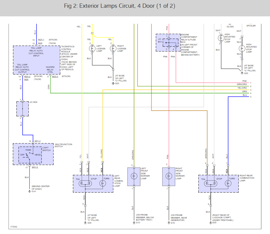

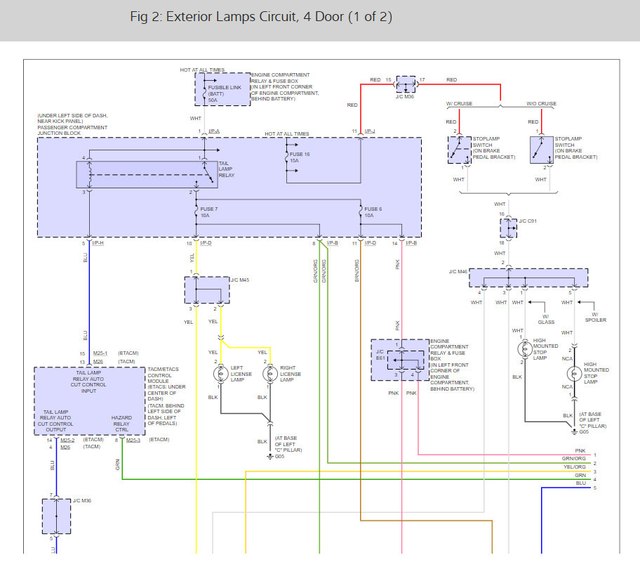

Hi leslieannmarcobrewster,

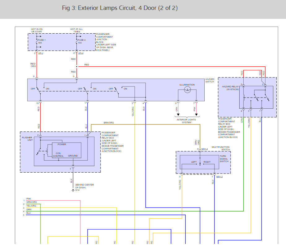

It sounds like you have a hazard switch or flasher that is out but to be sure here is a guide to help us test the power and grounds and the brake light wiring diagrams to help you do the tests.
Check out the diagrams (Below). Please let us know what happens.
Aug 1, 2010 at 10:17 AM
ZANYJB
I did some checking and I had a bad hazard switch
