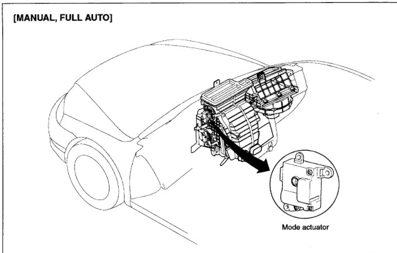

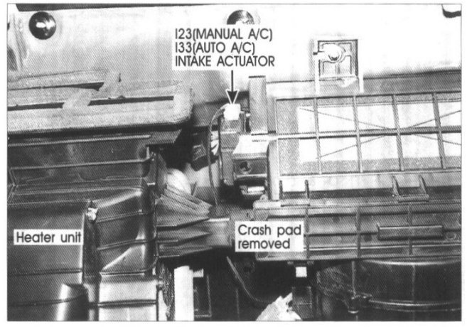

99.9% of the time it's the blend door actuator, Hyundai does give this info on their location! Remove the trim panel by prying it off, it just pops into clips, then unbolt the unit. Then you might need to remove the glove box door and some minor bracing. Here is a guide to help you fix the problem step by step. Then see the diagrams and images below with all for the blend mode door actuator locations https://www.2carpros.com/articles/replace-blend-door-motor
https://www.2carpros.com/forum/automotive_pictures/62217_1_47.jpg

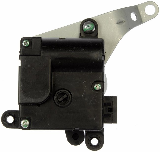

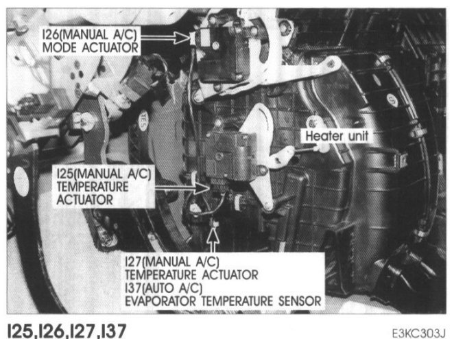

It is a small lever connected to the mode cam on the left side of the heater box. If it is stuck the motor that drives the cam could have failed or the cam may have, it is pretty much all plastic.
The picture is the motor that runs the cam.

2004 Elantra here having the same issue. Heat and A/C work but no directional control defrost, floor, etc.
I see the diagram and photos but having trouble locating this Mode actuator. Can anyone point me in the right direction?

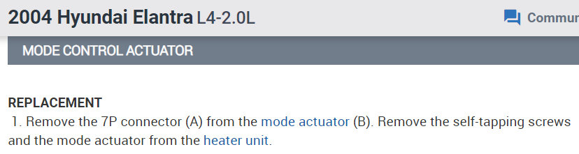

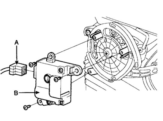

Hello, I'm Danny.
The mode actuator is bolted onto the heater unit which is under the dash on the passenger side. Here is a tutorial showing what is involved for its replacement:
I've attached a few pictures below showing how to replace and is location for your car. Hope this helps and thanks for using 2CarPros.
Dec 6, 2020 at 1:43 PM

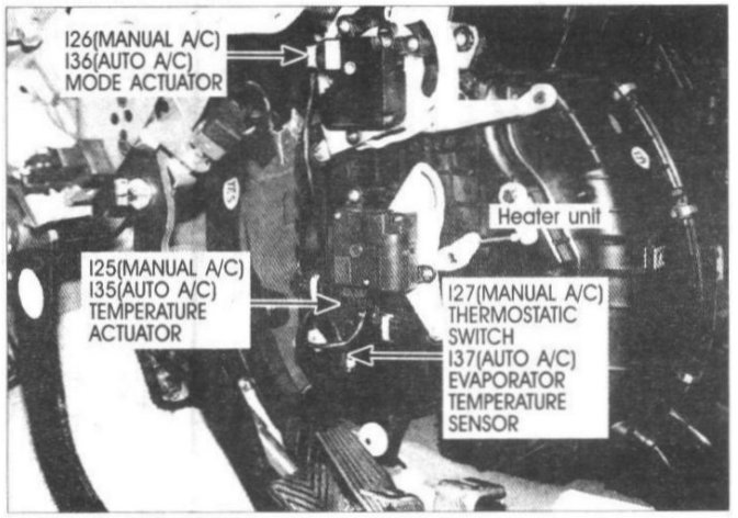

PD1210
Even in the photo posted this Mode actuator is on the driver's side under the dash directly above the temperature control actuator. Am I incorrect?

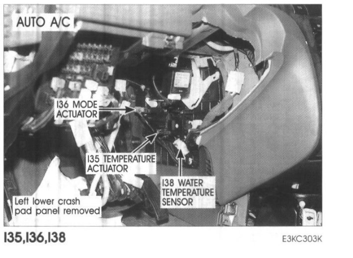

DANNY L
  • 5,648 POSTS
Hello again.
I found a better picture and attached below of its location. Let us know if you have any further question on this issue and keep us updated. Hope this helps and thanks again for using 2CarPros.
