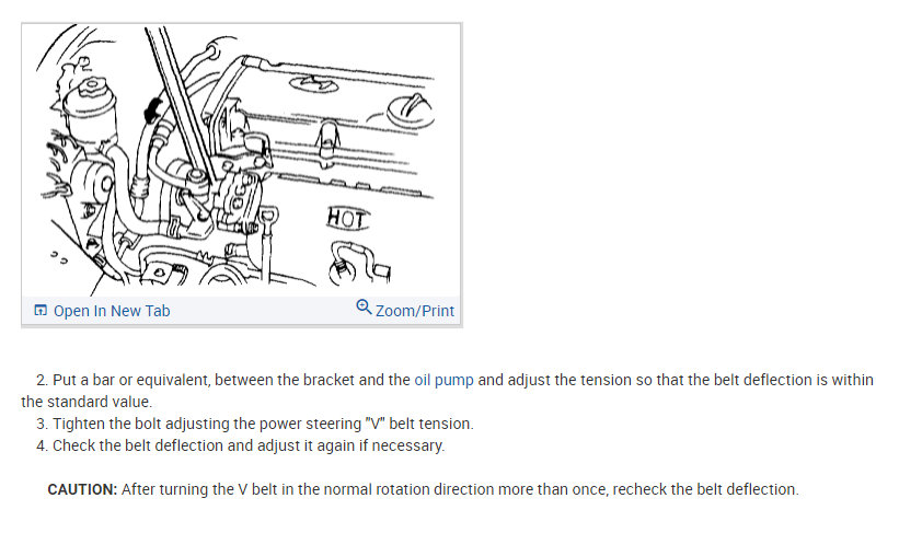

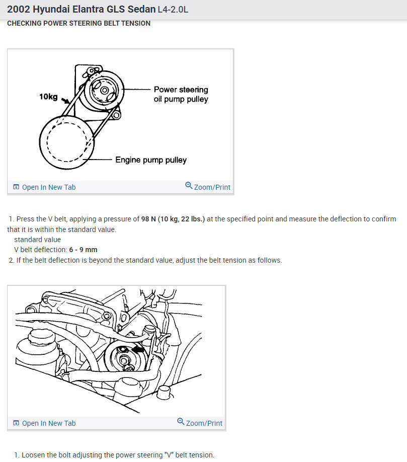

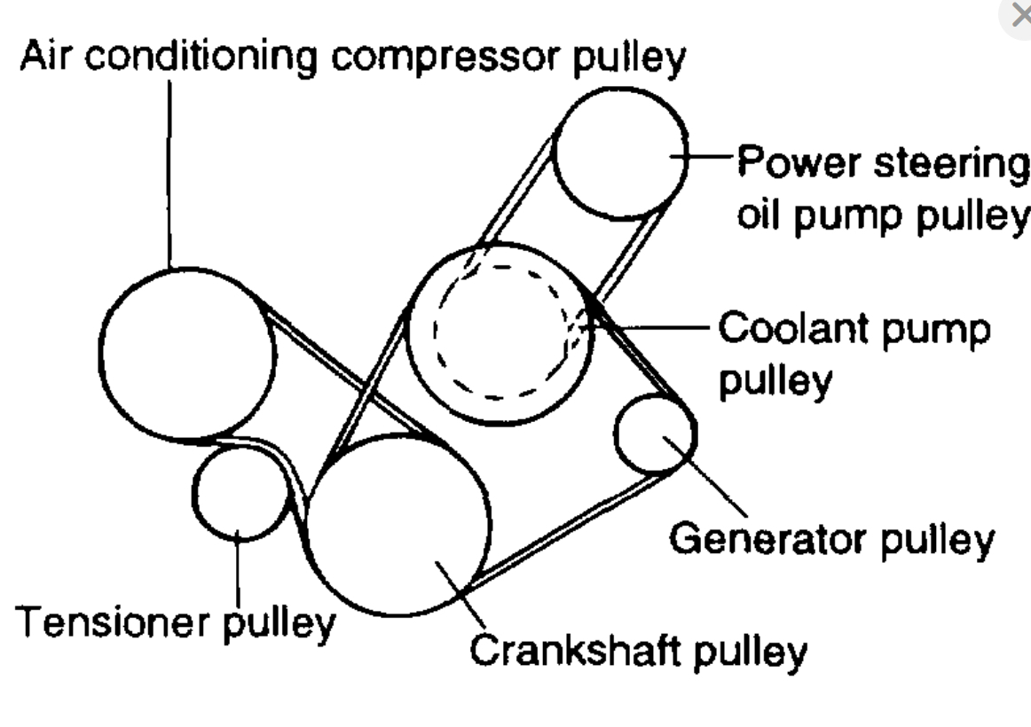

The squealing sound it likely the belt. As the serpentine belt gets old the rubber in the belt can glaze and when that happens the belt will loose traction and will slip during startup or when it's cold. It will make that squealing noise.
Here is a helpful article:
https://www.2carpros.com/articles/car-squeaking-noise
The clunking noise could from the engine. Check the oil level. If the oil level is low the engine can make that noise as the oil is not reaching the upper part of the engine.
https://www.2carpros.com/articles/engine-noises
