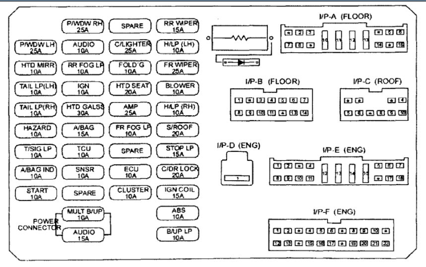

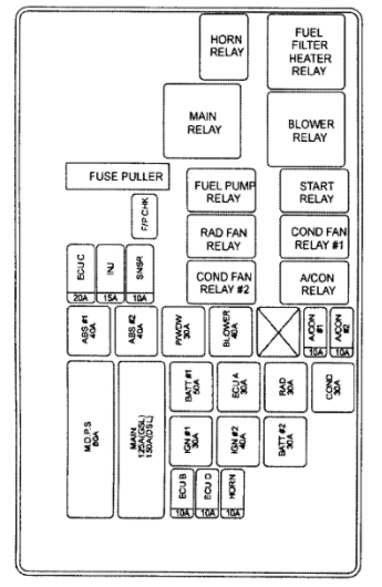

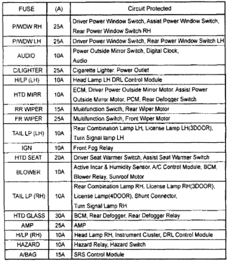

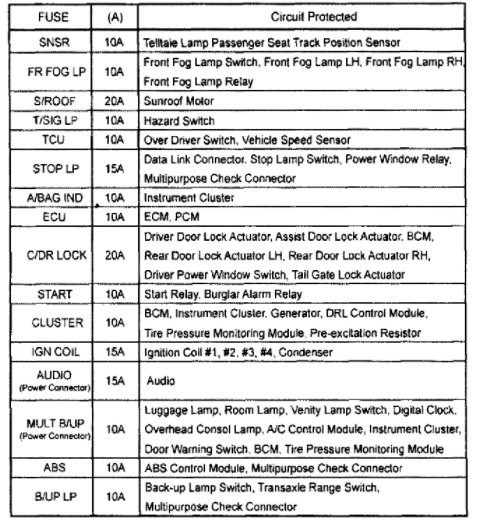

Where the fuse panel is how do I check the fuses? I have a rear brake light out.
Jul 6, 2008 at 3:26 PM
DANNY L
CERTIFIED EXPERT
5,648 POSTS
Hello, I'm Danny.

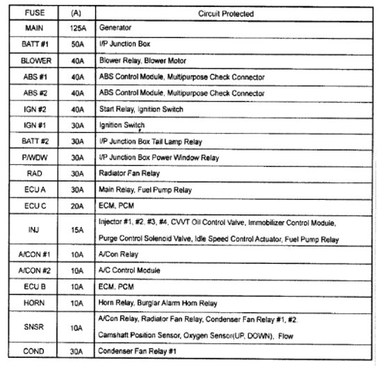

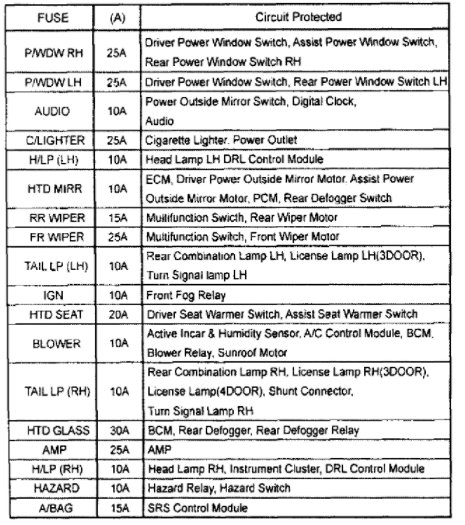

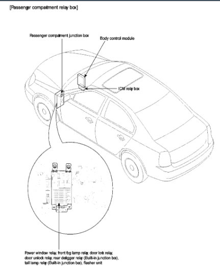

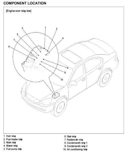

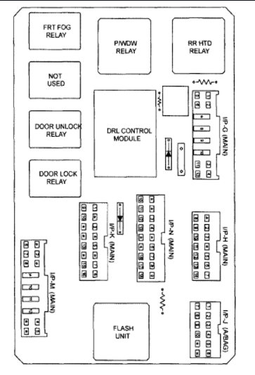

Here is the information you requested. Here are few tutorials for you to view on how to check and replace fuses:
https://www.2carpros.com/articles/how-a-car-fuse-works
I've attached pictures below showing the fuse and relay locations on your car. Hope this helps and thanks for using 2CarPros.
