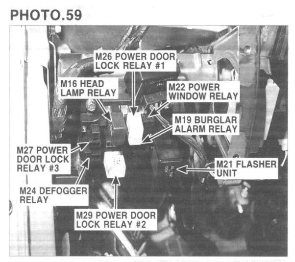

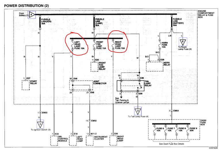

It might not be a fuse but rather the headlamp relay in your vehicle that has caused the headlamp outage. Here is a tutorial showing how to test a relay:
The headlamp relay is located under hood in the engine compartment fuse-relay box. I've attached pictures below showing the location of the relay on your car. Hope this helps and thanks for using 2CarPros.
