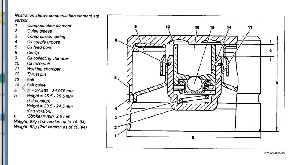

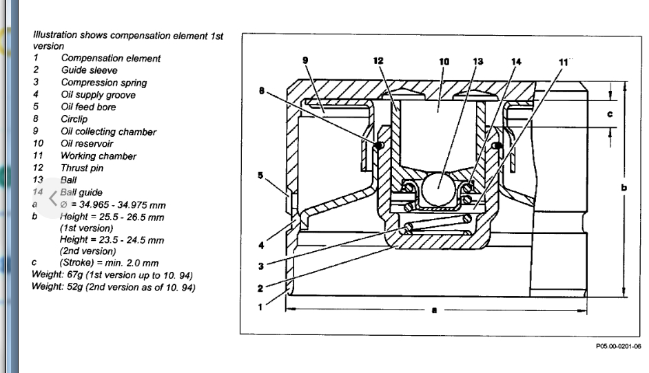

Need place to refurbish hydraulic lifters (I manged to open for valve/piston they have a small spring inside but the rest are sticky its hard to loosen up). I am looking also for a plastic part where the PCV valves hose fit. i broke the one on the other side. I need the electrical diagram MAF to identify which wire connects to which wire (they were ripped off by my dog i guess it was chasing a mouse or something) and lastly my cluster has faded off so i need LCD pixel. It is a C200 W203 M111.

I am not sure we are going to be much help for exactly what you are looking for because I don't know of anyone that rebuilds lifters as a service or sell the internal components. I did an internet search and didn't have much luck. Replacing them may be the only choice. However, if you are just trying to get the to loosen, soak them overnight in transmission oil. Then use the something to work the lifter up and down. If they are still tight, let them sit in there another night and work them again.

Thank you for your response. I have soaked them and will check after a night.
