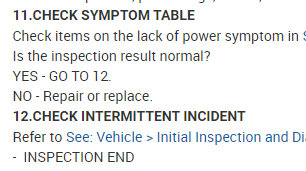

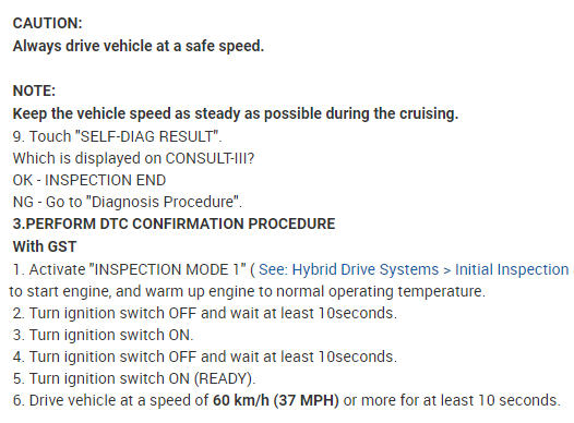

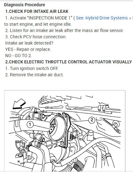

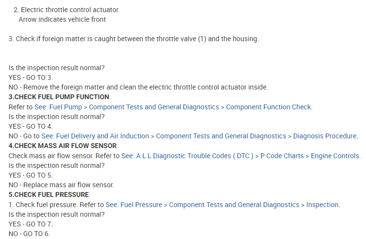

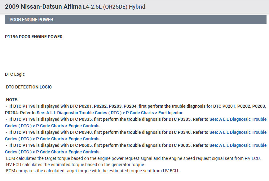

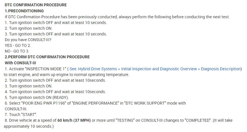

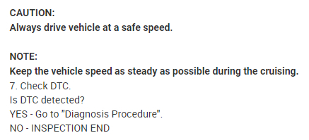

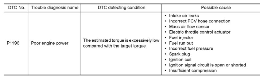

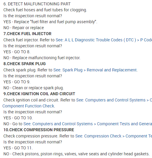

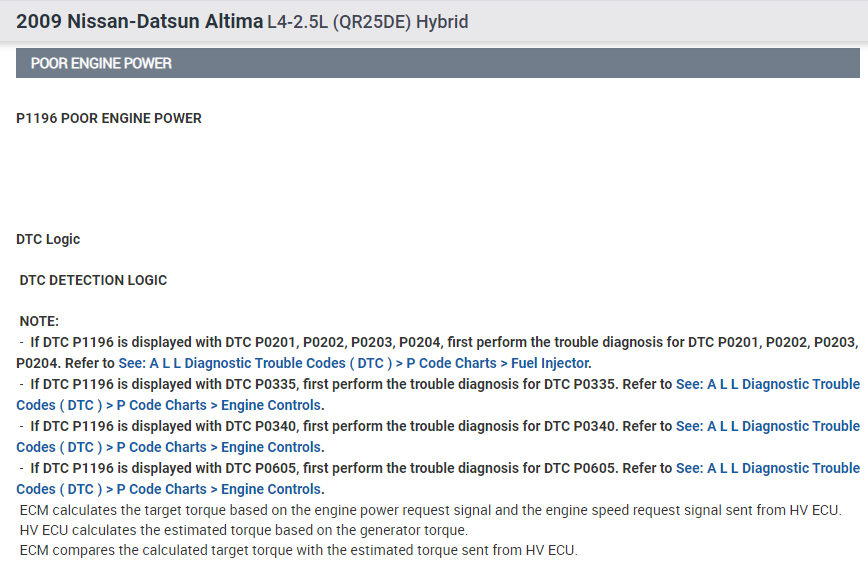

This issue could be caused by multiple issues. I've attached below a diagnostic flow chart for the causes of code P1196 that your car is exhibiting. It also mentions a possible fuel pressure issue so here is a tutorial showing how to test fuel pressure:
I've attached a picture below of the fuel pressure specification for your vehicle. Please get back to us after using these diagnostic procedures and let us know what you find and we'll go from there. Hope this helps and thanks for using 2CarPros.
