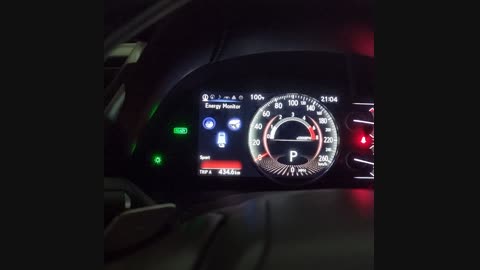

Does the Hybrid car have an alternator? I thought that the electric motor turns into generator when the engine is running so the Hybrid battery is charged if it is below range. The engine starts if the Hybrid battery is low. The engine should not stay on once the battery charge is good. which is not the case in my car. short video attached for illustration.

Hello SAID84, I just wanted to join in the conversation. The MPG will vary depending on your driving habits as stated earlier on. I also noticed you're driving in sport mode. You will get less MPG when driving in sport since the lower gears are held much longer, The EV mode on your vehicle is only active on low speeds. Any sudden accelerations or highway speeds will make the gas engine run.

In conclusion your MPG's appear normal and if there was an issue your check engine light and hybrid malfunction lights would come on. Just make sure your tires are properly inflated with good tread. Alignment is straight. And keep up with your maintenance.
