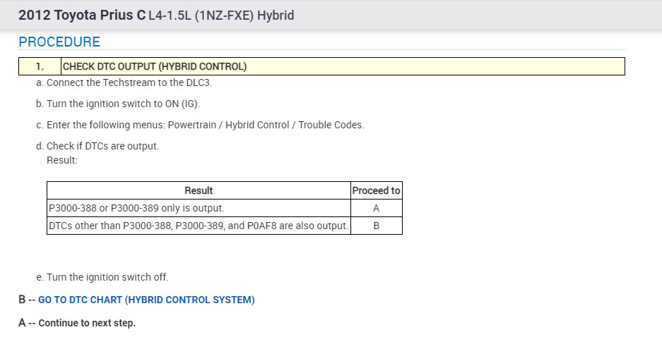

First, working on an EV can be dangerous if you are unfamiliar with the procedures, so please be careful.
Also, if you haven't had the can-bus scanned, I would recommend it. There could be diagnostic trouble codes stored that are helpful.
Here is a link that explains how it is done:
https://www.2carpros.com/articles/can-scan-controller-area-network-easy

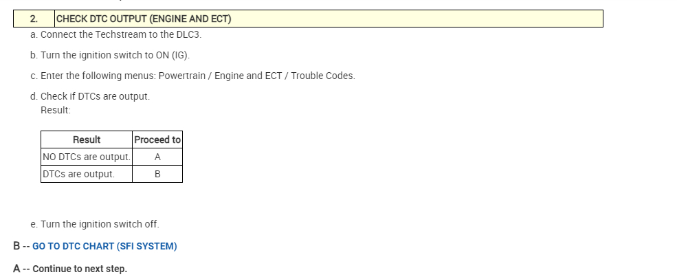

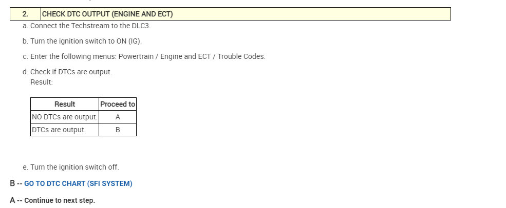

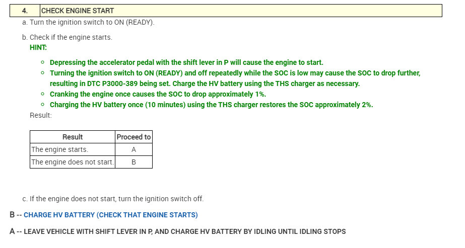

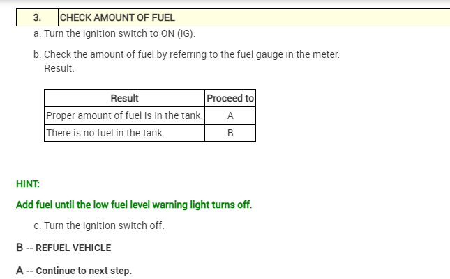

As far as the issue, I attached diagnostics below which are general for the circuit. Take a look through them and let me know if you are comfortable performing them.
See pics below.
