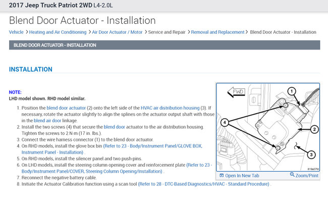

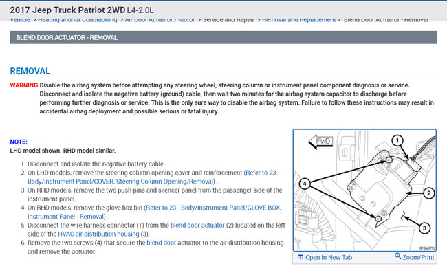

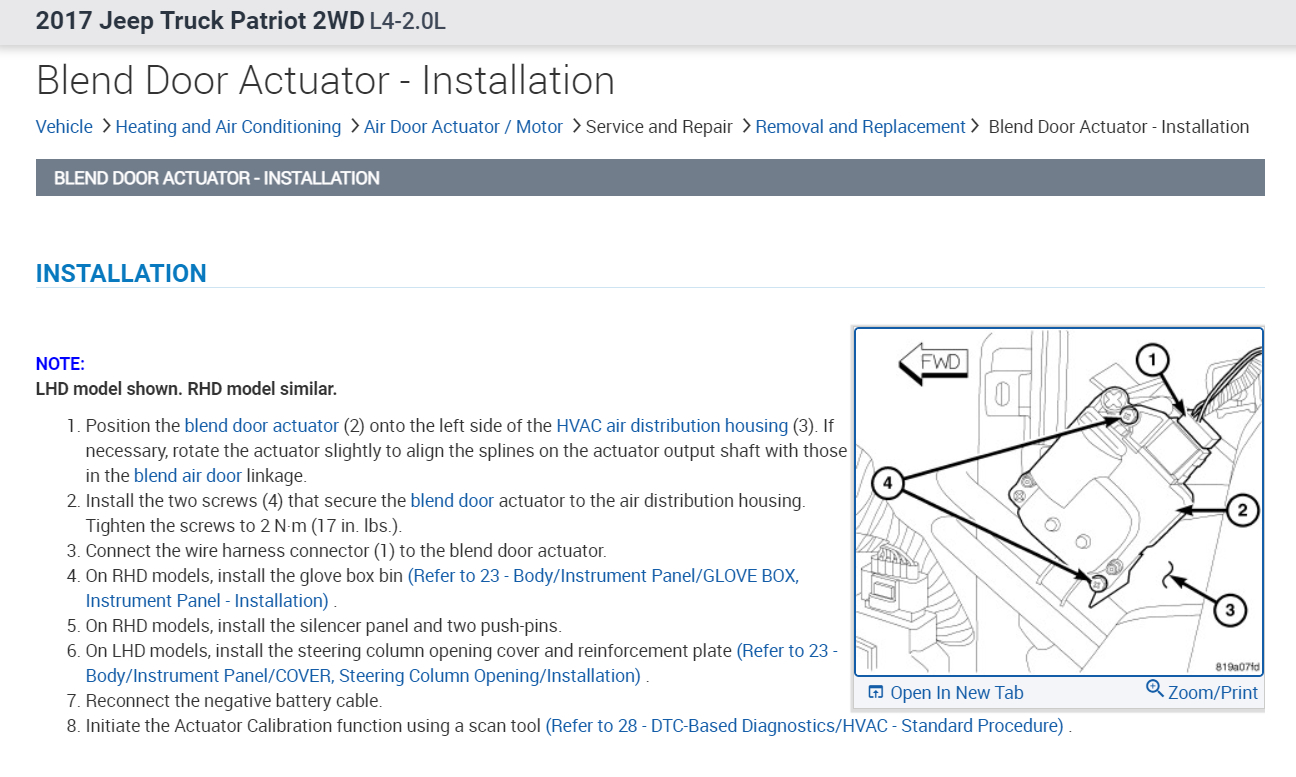

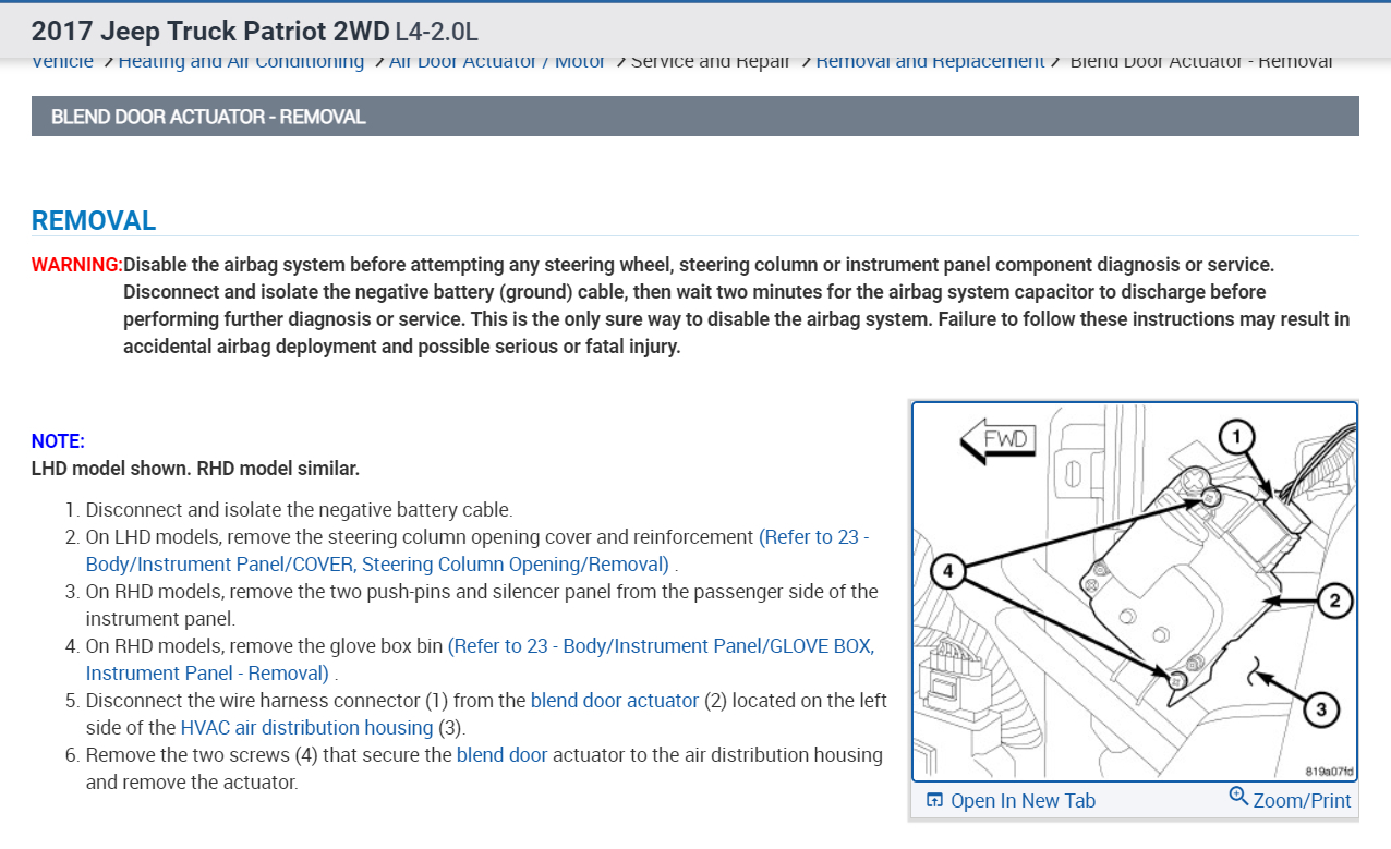

i changed the blend door and noticed that the direction piece that changes were heat/AC was off of the pins that allow it to turn. is there an easy way to align it into the right slots?
Jan 30, 2023 at 12:16 PM
You can connect the blend door actuator and turn the key on to work the controls to help move the actuator into position of the door pivot control rod. Can I ask which one you are replacing of the three? Here are the instructions of the blend door actuator in the images below. Let us know what happens.
