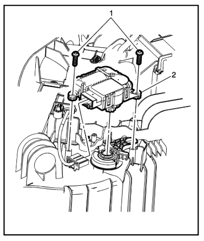

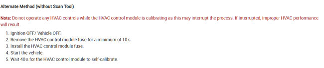

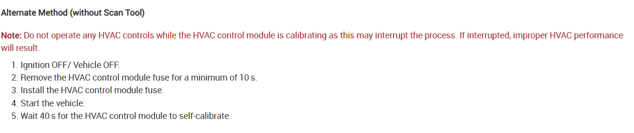

Okay, it sounds like you have a good A/C system, but the temperature blend door is not working, which is common, the blend door actuator for the temperature is on top of the HAVC plenum, here is the location and how to calibrate it after installation. Check out the images (below). Please let us know what happens.
