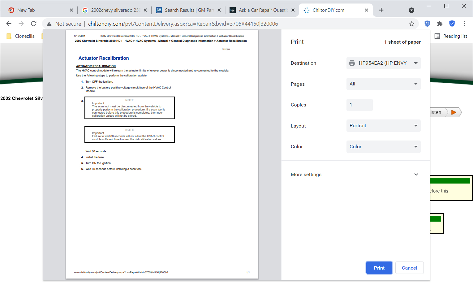

VIN# 1GCHK23112F213262 a crew cab long bed truck LS trim, and captain chairs. The HVAC modes all work correctly with one exception. The vent for the rear cabin area on the passenger side blows air all the time no matter which mode is selected I tried manually calibrating the mode door by following this procedure from the Chilton's diy manual; see attached image. I don't have a scan tool and don't know if that's required to complete the recalibration or if I have another problem. please help!

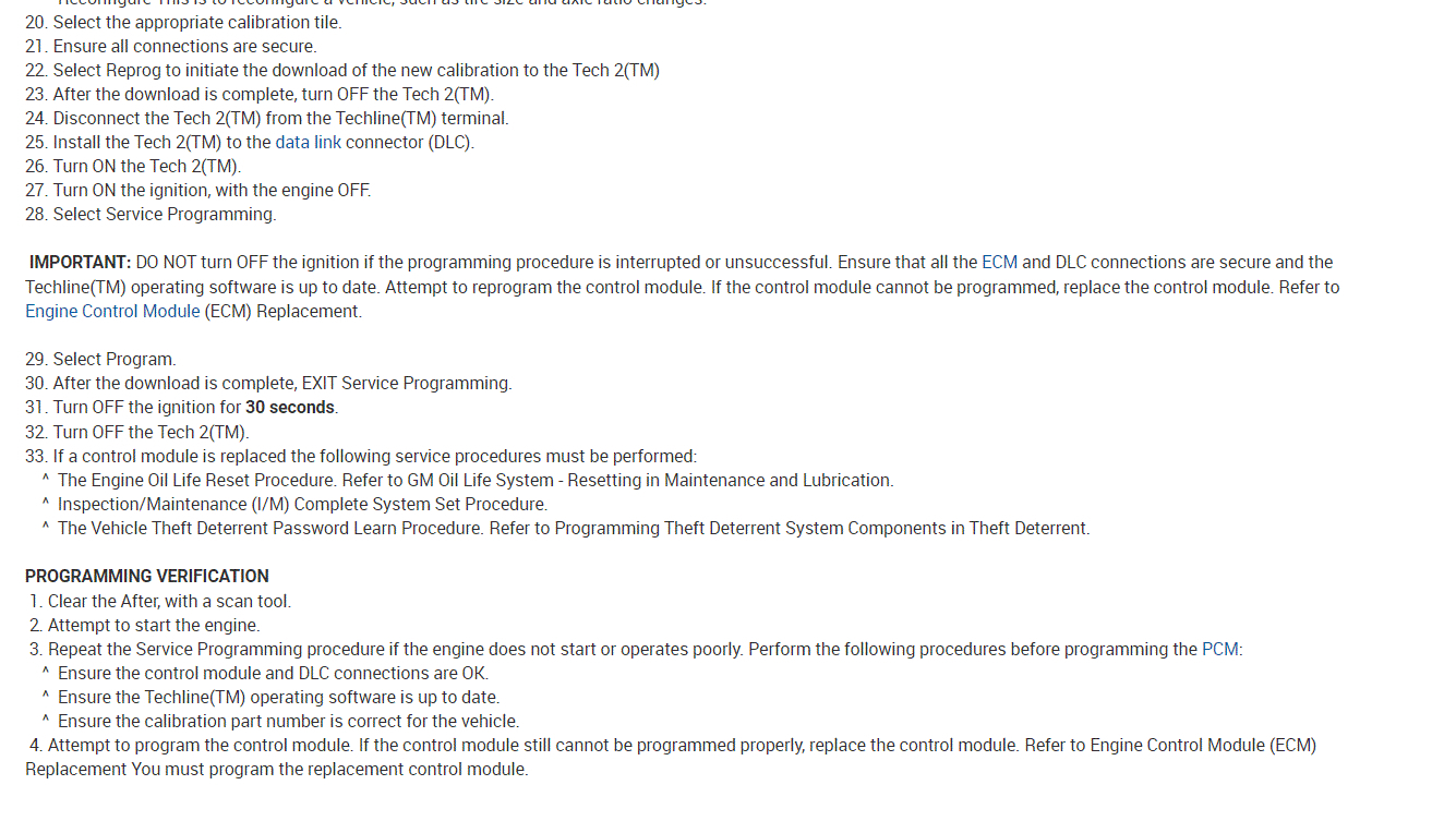

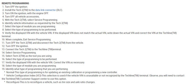

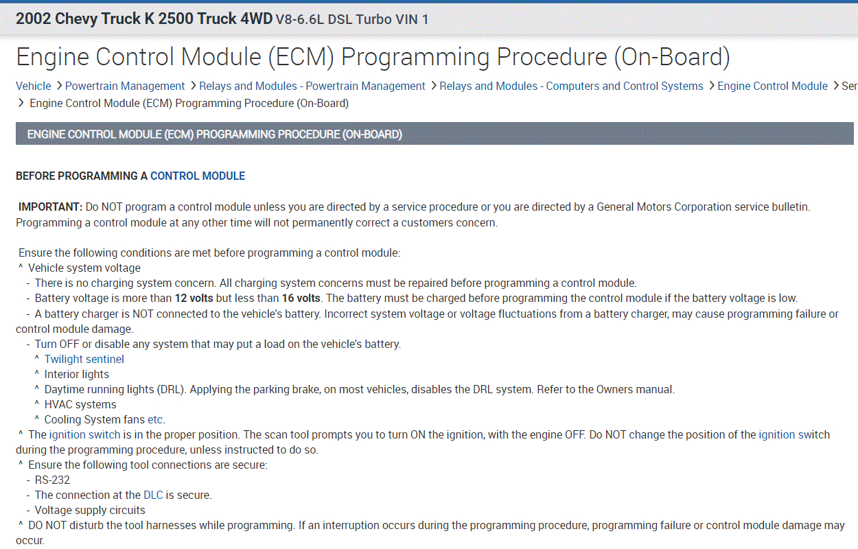

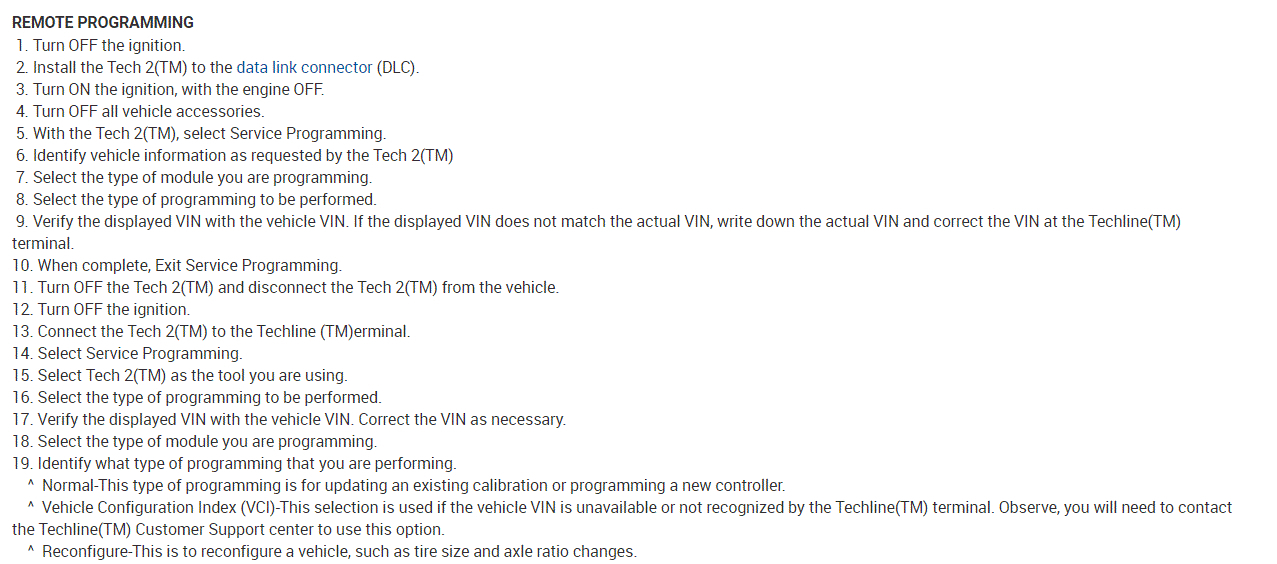

If it doesn't, then you will need a scan tool that can communicate with the HVAC control module. If you look at the attachments below, they provide the directions.
See pics below.
