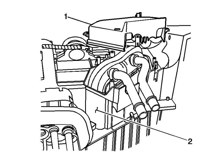

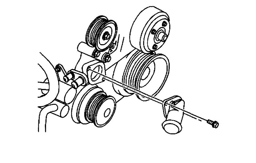

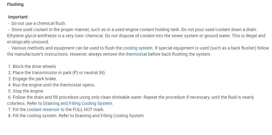

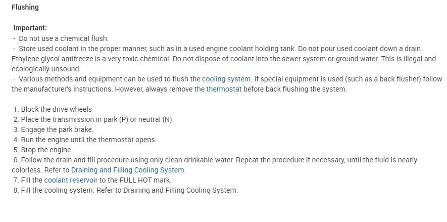

You could have a partially blocked heater core from debris in the system. Flushing the system would be a good start and replacing the thermostat.
https://www.2carpros.com/articles/car-heater-not-working

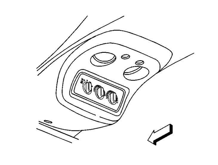

Beyond that, if it is a control issue, the control head itself may be the issue.
