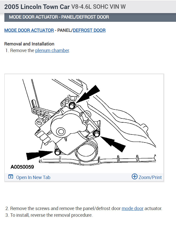

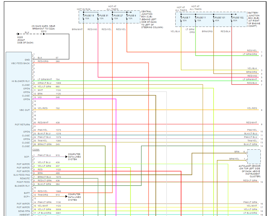

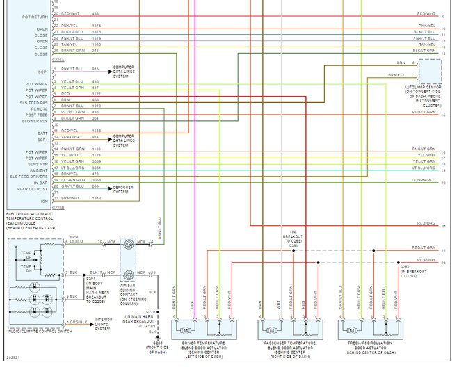

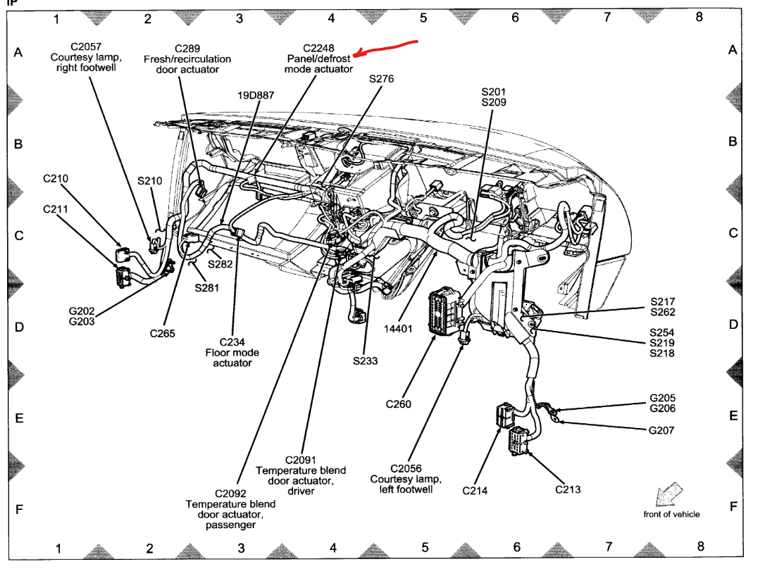

I did this repair years ago on a Crown Vic or something similar maybe just can't remember what it was. No air from middle vents, or rear air. Only defrost and bottom/leg air. No matter what I chose only the defrost and bottom. I ran the test, and it gave me
12....42
12....63....
12...64
Not sure what these mean.
12....42
12....63....
12...64
