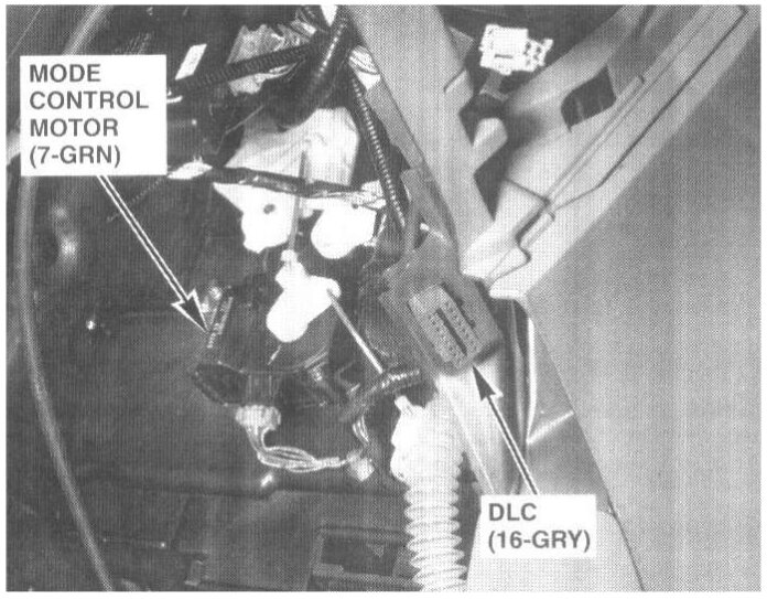

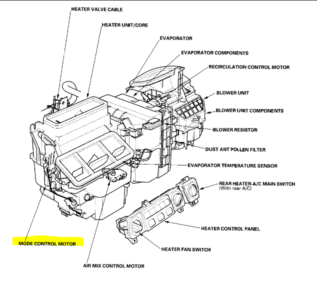

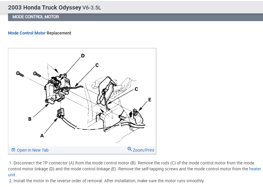

The mode door actuator is the likely cause.
If you look below, the first two pics are to help you locate the actuator. The last pic are the directions for replacement.
Before you purchase one, remove the old one and while it is still connected, see if it responds when you change the airflow directions.
See pics below.
