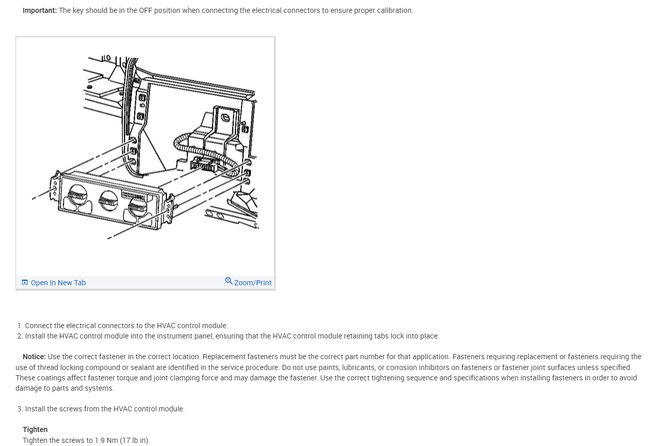

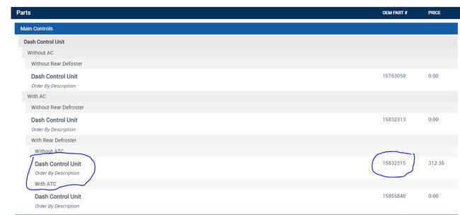

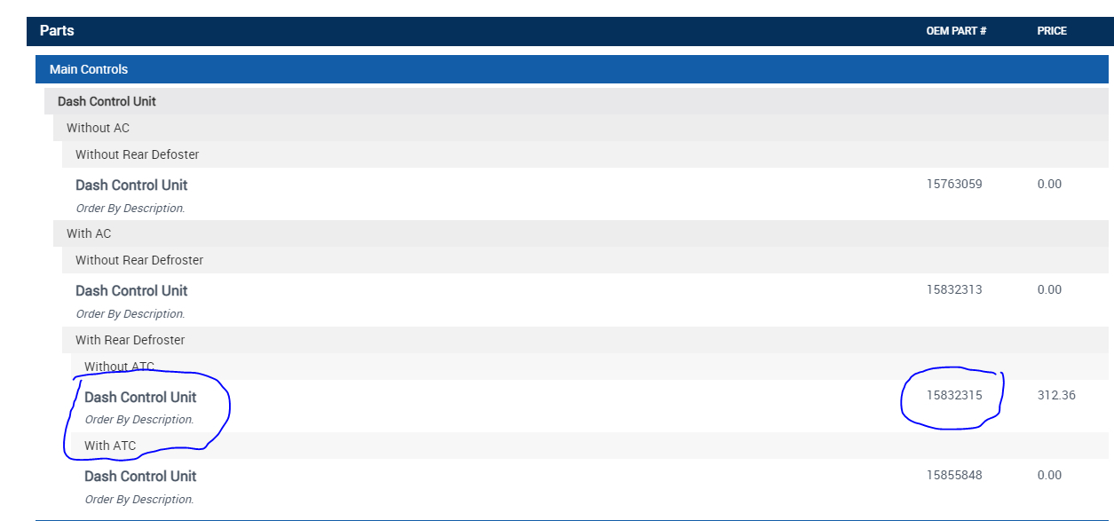

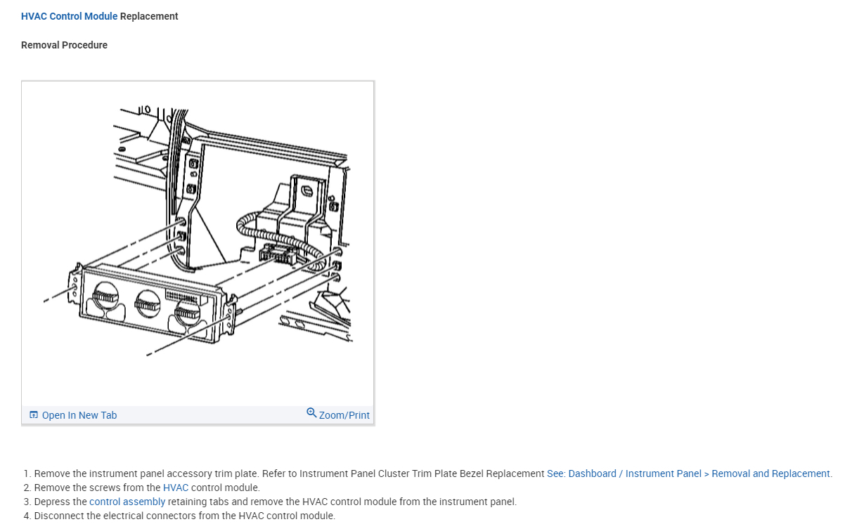

Good morning,
Dorman does make the only one available in the aftermarket.
I attached the GM part number for you to check with the dealer parts department and see if they have it in stock.
Dec 13, 2021 at 6:13 AM
