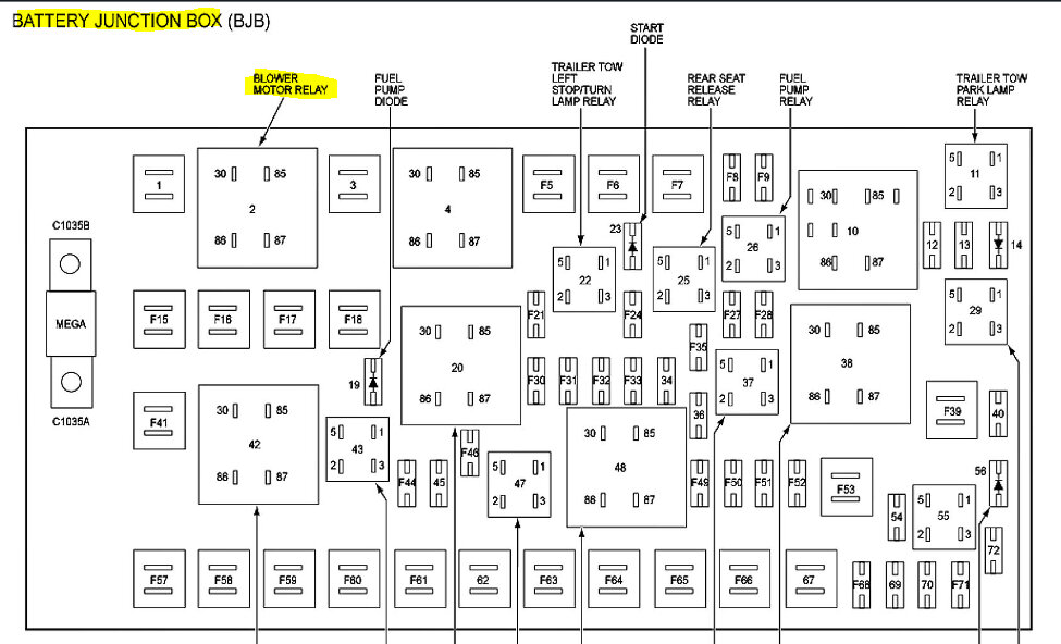

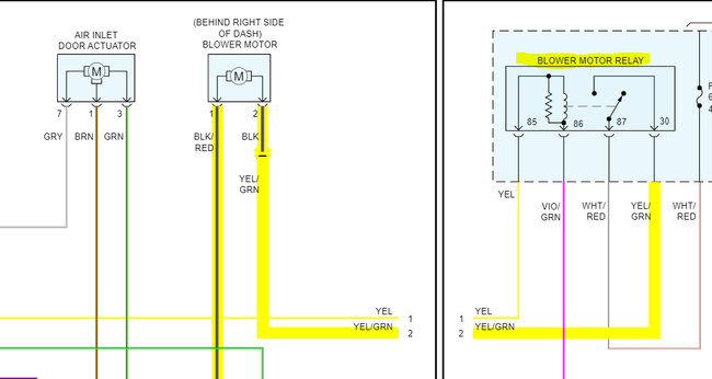

Blowers are not working all of the time. Randomly during initial startup, the blowers won't work at all. Not on A/C nor heat. They never stop after they are working, it's only after start up. Does the blower motor need to be replaced?
