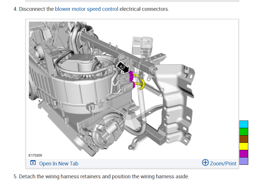

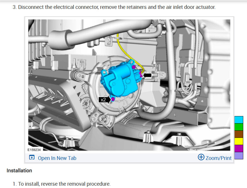

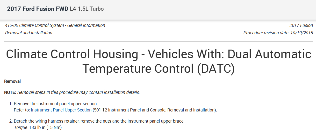

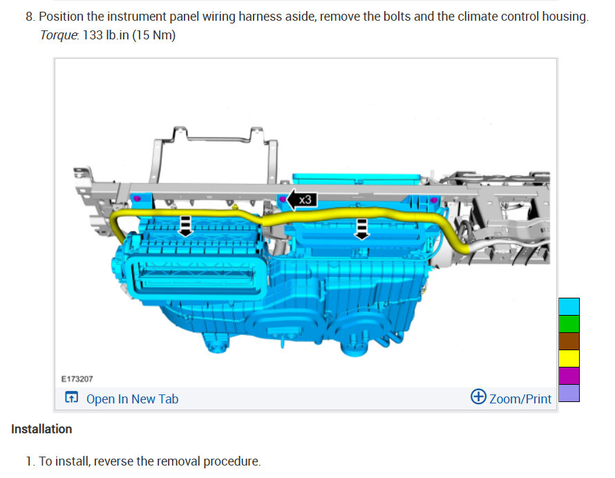

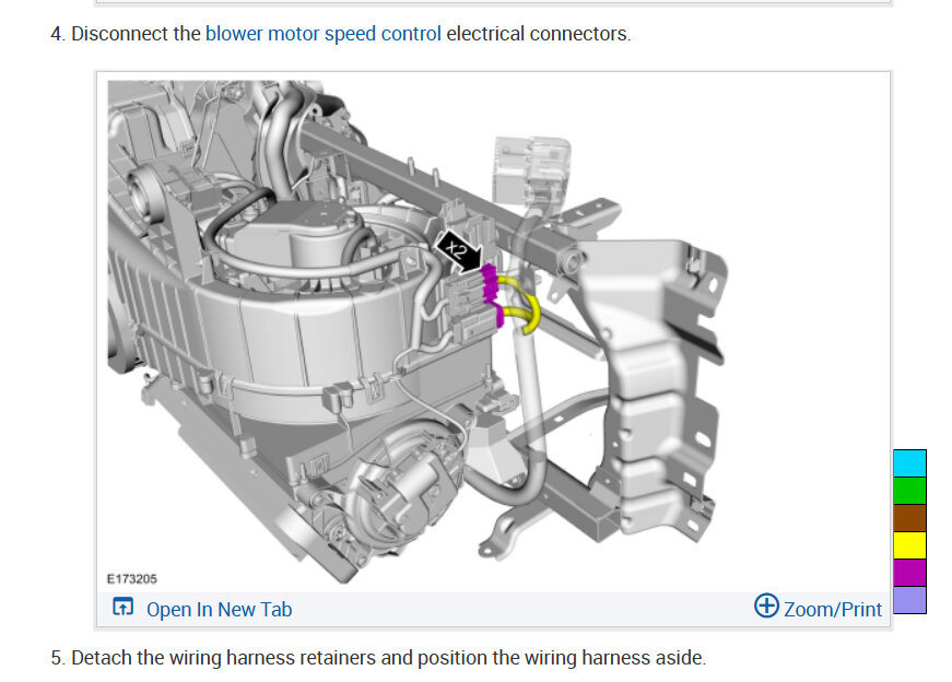

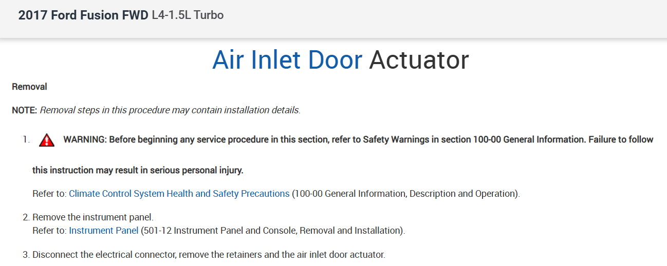

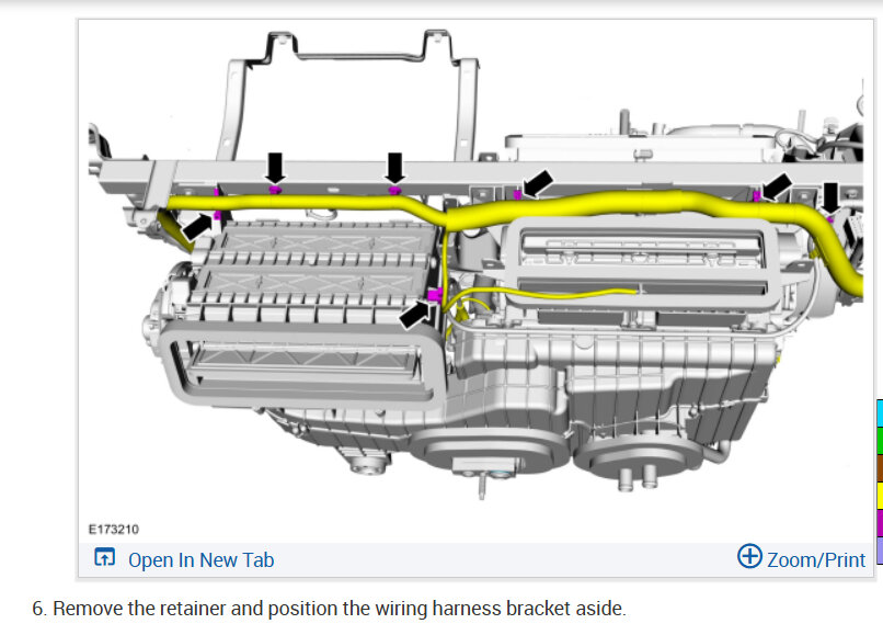

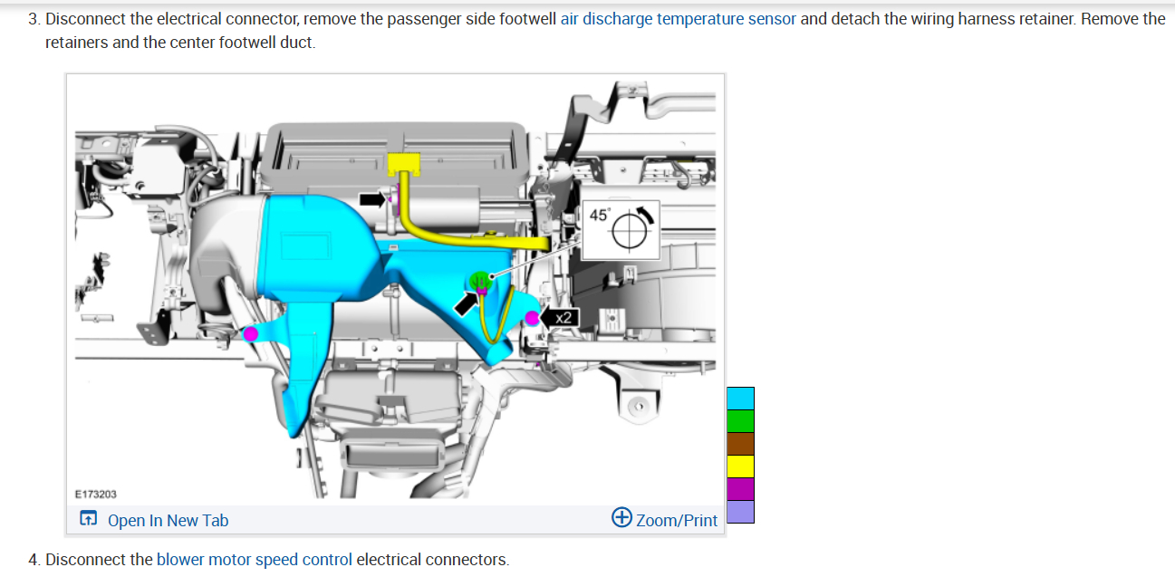

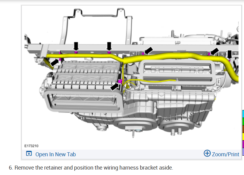

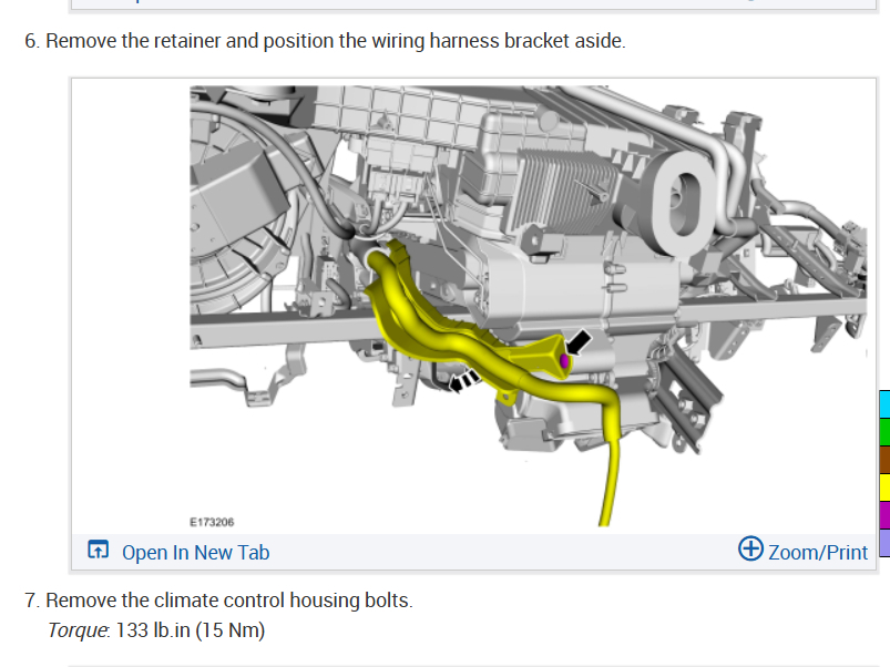

This is far to the passenger side behind the glove box. With the glove box out, I can access the front screw but can't find a way to remove the rear screw to remove the actuator.
