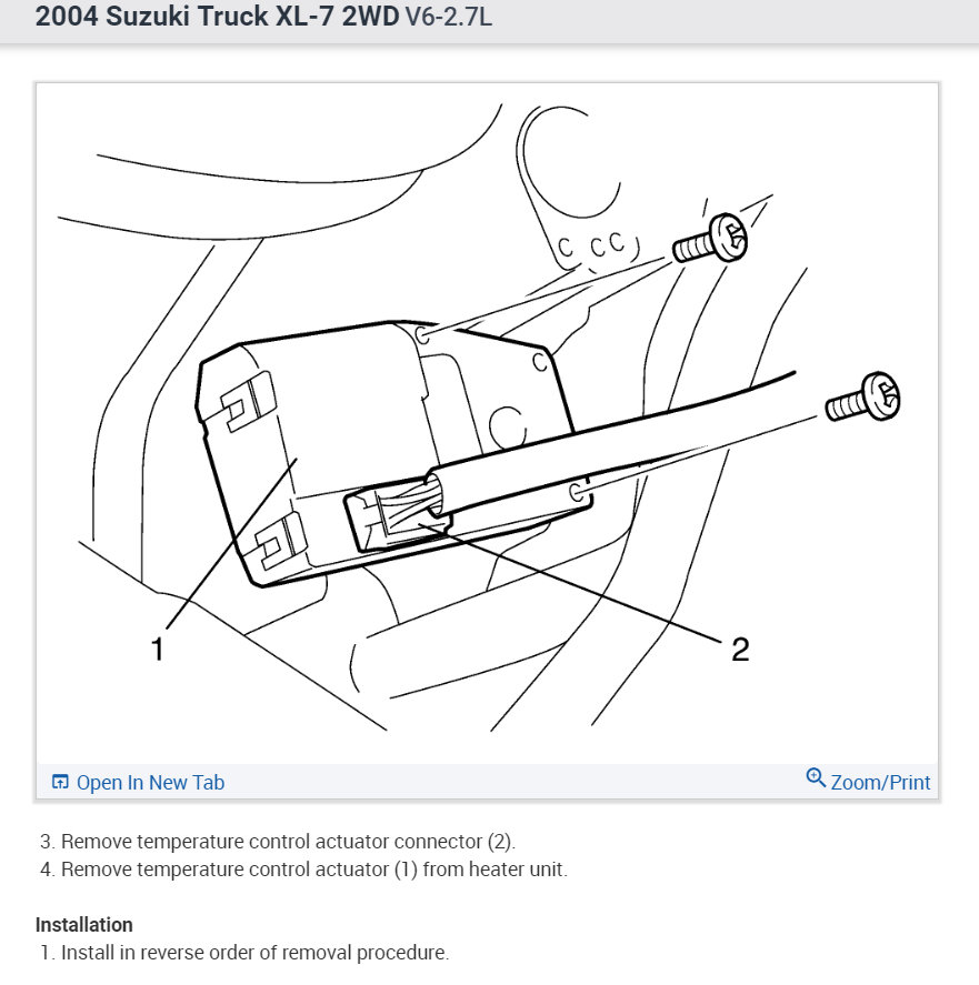

Sorry I forgot to mention that B1504 shows sun load sensor circuit and B1513 shows temperature control actuator.
Oct 17, 2018 at 11:04 PM
The problem could be shorted a shorted temperature blend door actuator. Here is a guide that can walk you through it and the location of the actuator for your car:
